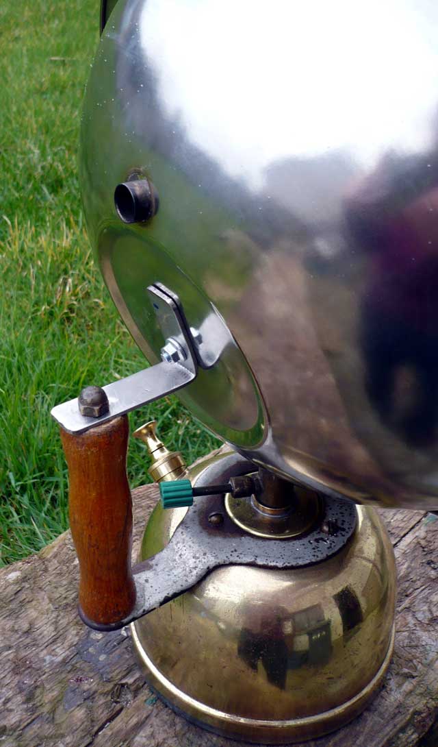

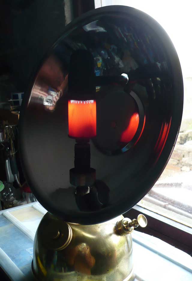

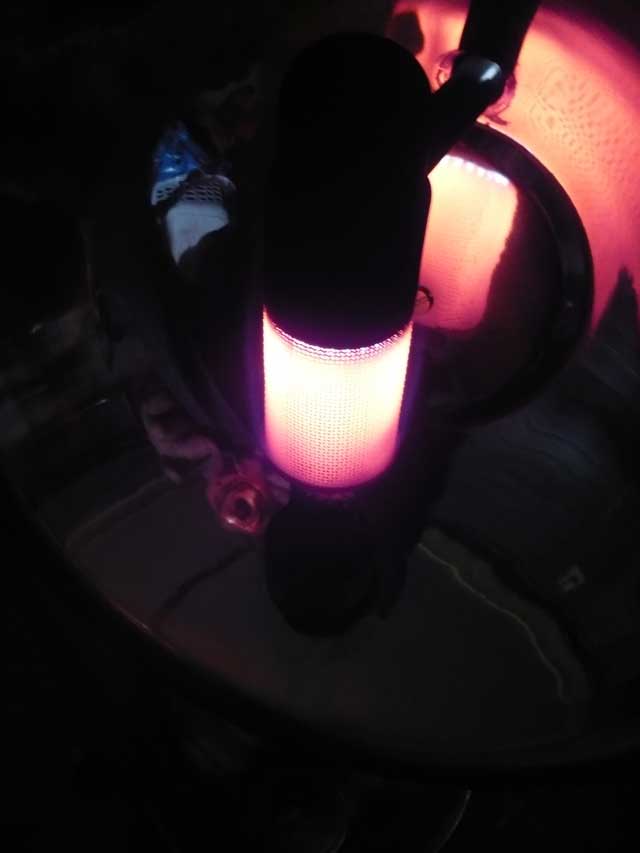

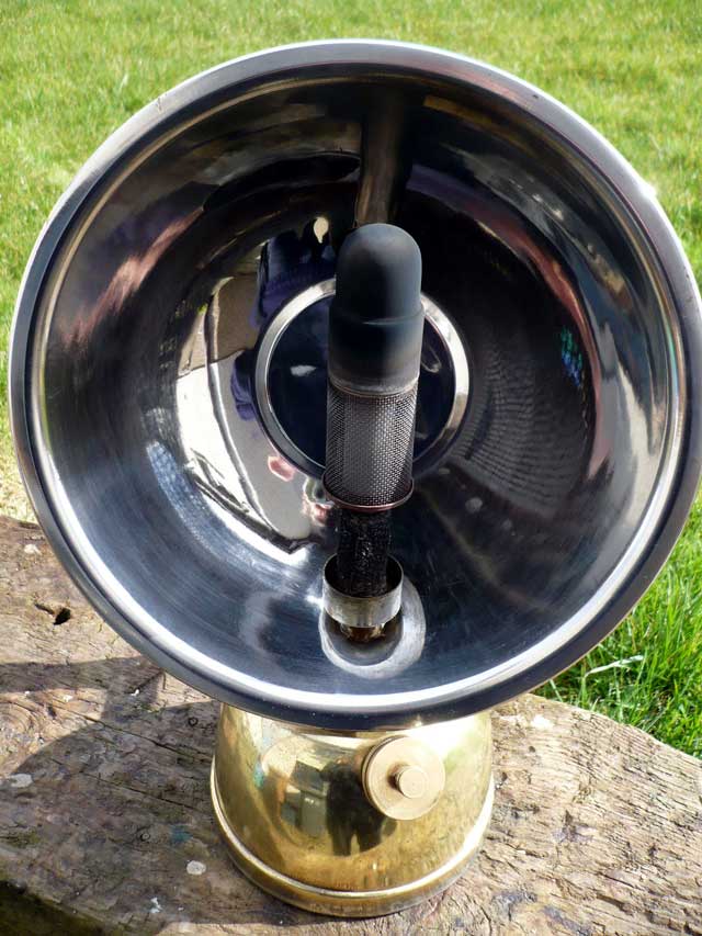

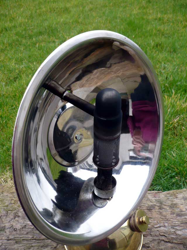

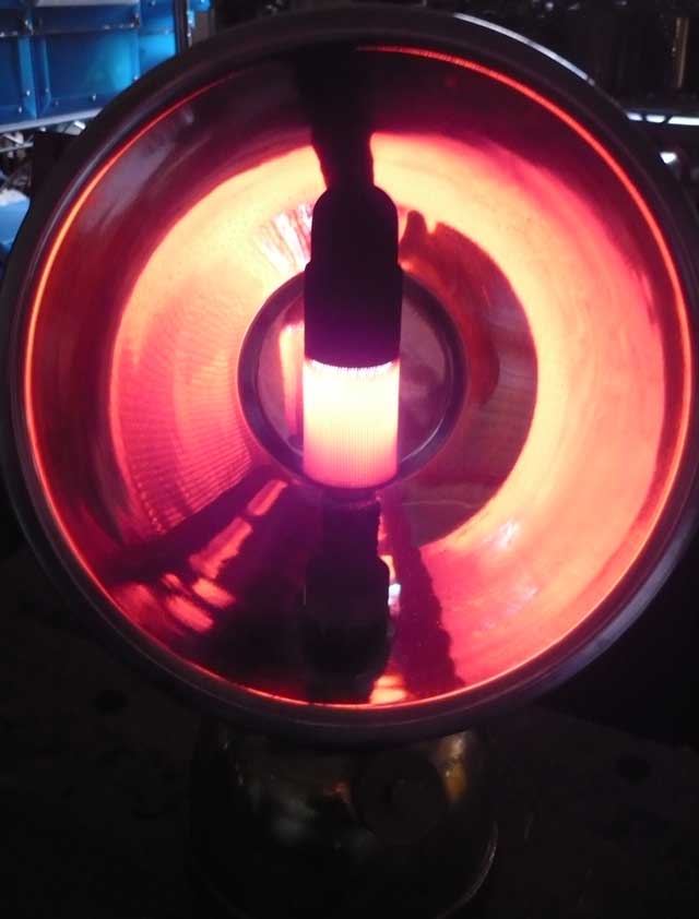

    Hi, it is quite usual to find Bialaddin Bowlfire heaters minus the plating on the parabolic reflector.
    The original bowl from a Bialaddin bowlfire is approx. 11in. diameter and around 4in. at its deepest point.
    Some time ago I was experimenting with a possible replacement bowl. This is a 12 inch diameter, 3 inch maximum depth, mixing bowl, made of stainless steel, and bought from a "Pound Shop", our equivalent of a US "Dollar Store"
    Here are some photos of the new "Pudding Bowl Bialaddin":
    1330106698-A-bowl-transplant-1.jpg 1330106713-A-Bowl-trabsplant-clip-1.jpg 1330106727-A-Bowl-trabsplant-clip-2.jpg 1330106757-Pudding-bowl-Bialladin-1.jpg 1330106766-Pudding-bowl-Bialladin-2.jpg 1330106775-Pudding-bowl-Bialladin-3.jpg 1330106786-Pudding-bowl-Bialladin-4.jpg 1330106796-Pudding-bowl-Bialladin-5.jpg
    Obviously the new bowl is not a true parabola as it has a flat base, but it is pretty good at focusing the rays, and it is very shiny compared with the old original worn reflector. The bowlfire does seem to throw out much more radiant heat with this "new" bowl.
