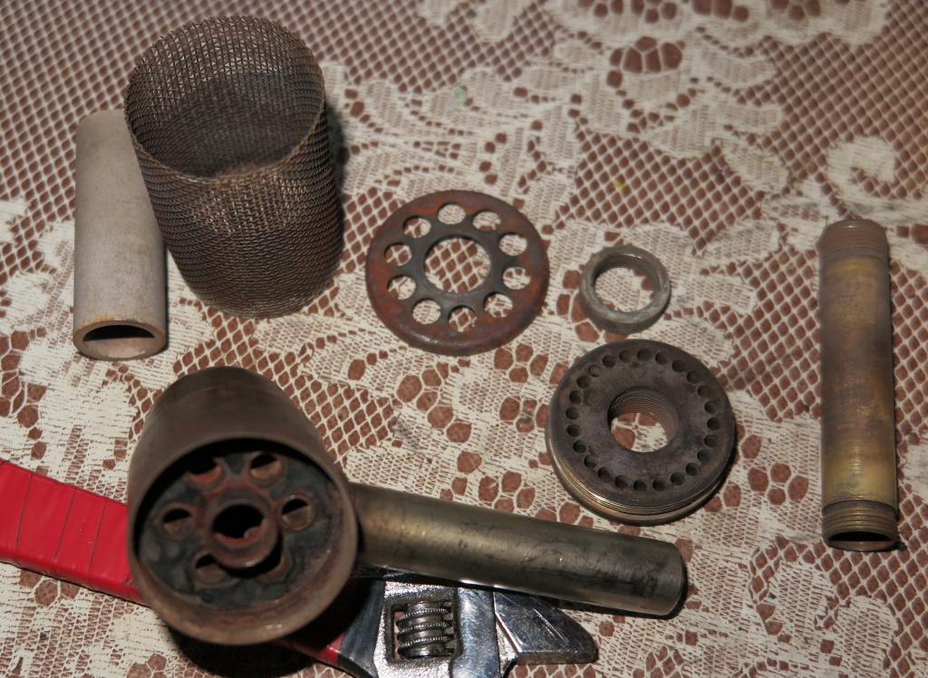

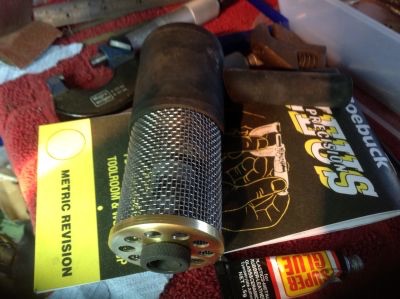

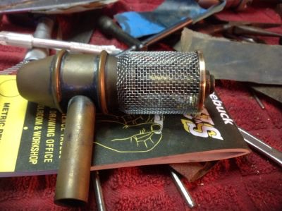

  24. expat
    Aug 16, 2013
    280
    Wim, have you dismantled the burner and given it a good cleaning? It should unscrew (although I don't think the air tube is removable).
    I'll try to get some photos when I have some free time!

  26. podbros
    4,105
    Wow!... Great detail! Hope you don't mind me asking a question(s) about the burner? It is quite different to the standard burner? Not just the Vent tube and mantle but also in the way it dismantles?

  28. expat
    Aug 16, 2013
    280
    Hi Pods, completely different! The burner is much larger than the lamp one and the lamp burner does not share the same internal structure.
    Wim, yeah, that should do it - I've been known to use Plus gas in the past too - the ether in it helps the oils penetrate. Don't forget to remove the ceramic tube first though (just in case you forget - not likely I know, but I haven't been able to find any replacements).
    If it makes you feel better, mine gives off a great heat (now its cleaned - there were "flakes" of carbon blocking it) although when I de-pressurise it it "backfires" out of the air tube!
