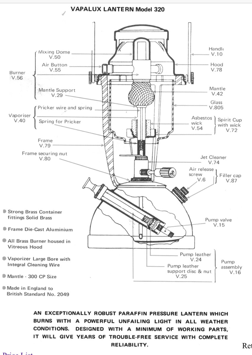

    The "tube" / "mainstem" is called a vapouriser - also spelt vaporiser / vaporizer.
    The "main can" is more commonly called (fuel) tank, fount or font.

    Jet cleaner should be closed, use meths in cup twice; open valve before meths go out and add 10 pumps; lamp should light. Let burn like this for 30 seconds to a minute then add more pressure.
    Paraffin that is normally left in the vaporizer can get warm enough to burn but not be hot enough to vaporize into a gas; that is why you want the tip cleaner closed.
    There is a seal below the valve and a seal behind the knob on the valve; if the lamp leaks while it is lit then it’s probably one of these two seals.
