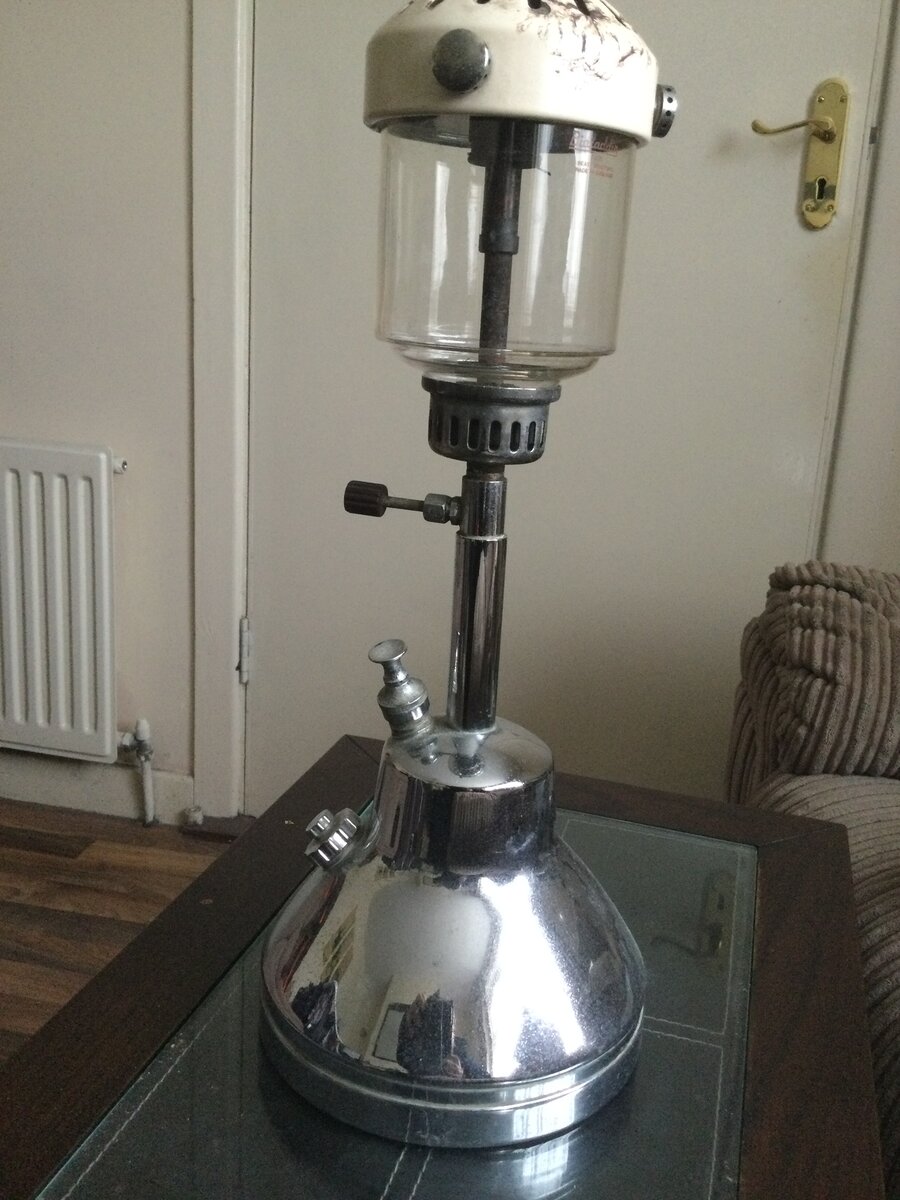

    Hi guys, I’ve just purchased a T10 with a chrome font which appears to be slightly pitted so do I go at it with the wire wool ? Also the glass on it says Bialaddin T805, is that the wrong glass ? What cp could be expected ? Thanks in advance.

    some pics would be good please and check for a decal underneath :thumbup:

    edit : looks great! I would try autosol or peek first without the wire wool :thumbup:

    Lovley - the mantles are rated at 350Cp - it should be as bright as any other vapalux/bialaddin. The glass is the later stepped type from the 315 and 320 - the earlier was more rounded. Base camp have some repros I think. But it will do the job. I would echo PB's reccomendation of just starting with chrome polish to begin with..
