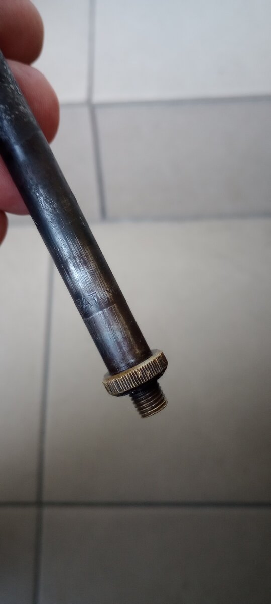

    Hi. I have some questions about the Bialaddin 300X vaporizer.
    When I took out the needle rod, I noticed that it is very dirty. I thought it would be a good idea to clean the vaporizer from the inside. However, I can't unscrew the bottom part.
    Is it removable?
    Is there a mesh inside, in addition to the spring, that can be cleaned?
    Another question.

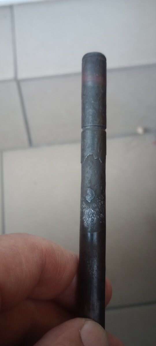

    Will such a charred surface of the vaporizer allow it to work for some more time?
  2. David Shouksmith
    You're not meant to be able to unscrew the bottom part although I've seen the odd one that's come apart. They're not intended to be serviceable and even if you got it apart, you'll not be able to clean the entire thing because there are baffles near the top.
    In any case, that looks extremely worn due to the heat scaling off the outside of the vapouriser. It looks almost like it's been used in a heater rather than a lantern. Best of luck tinkering with it but time for a replacement, methinks...

    Thanks for the reply.
    That's probably why it was so cheap...
    Is it possible to buy one somewhere?
