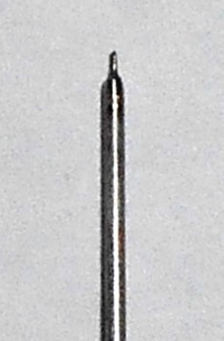

    Perhaps the tip has broken off the wire and is stuck in the hole. The end of the wire should look look very similar to this from a Tilley.

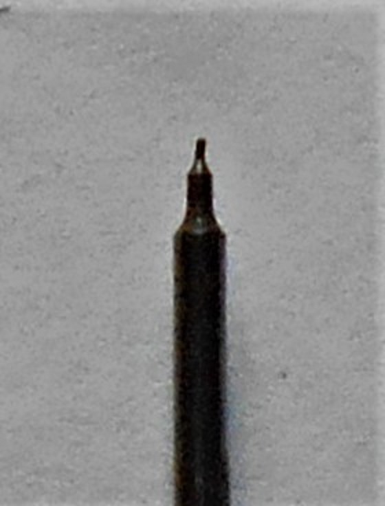

    Thanks Henry. the needle in this lamp doesn't look like the picture you kindly sent over; it's really thin with only a tiny point on the end, not as long a point as I've seen on other lamps. I'm now wondering if I need to get right down to the bottom of the mechanism down in the tank to see if that's where the fuel is getting blocked.

  15. Tony Press
    @Oliver Laws
    I think you may be misinterpreting the photo of @Henry Plews
    It might clear some issues up if you post a photograph of your pricker and detail of the pricking tip.
  16. Henry Plews
    3,067
    @Oliver Laws perhaps I should have emphasised "very similar to this from a Tilley" or better still, dug out an unused (i.e. clean) Bialaddin wire.
    Near enough 1mm

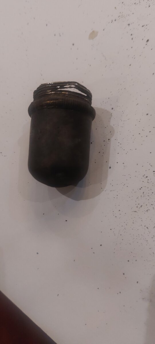

    I swapped the burner with a working 305 and it burning really well. I suspect the dome on the burner, which has a split it the tread and is loose. Can I use some sort of fireproof tape to seal it?
  21. Tony Press
    Quick answer is no. You’ll either need a new part, or you will have to silver solder the split.
  22. Fireexit1 United Kingdom
    3,538
    As Tony says either replace the dome or silver solder (silbraze) it up. Looking at it you would have to solder the dome onto the burner body and accept it will never open again. Not neccesarily a concern as the need to open them is almost never. Or just buy a second hand burner assembly. Plenty on ebay or from the usual sources.
