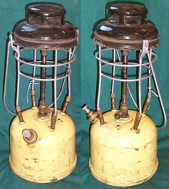

    Another conundrum. Mike Parker owns this odd lantern and I photographed it at an HLC meeting. All the parts appear to be genuine Tilley and even the tank, whilst unique, does have the look of a Tilley manufactured product about it. It is certainly not a bodged job. I have handled this and it is made in the same way as a period Tilley and just appears to be an extended standard 1960 ish tank. Has to be about twice the capacity of a normal 1.5 pint tank. The yellow paint is an exact match with the Southern Rail BR49 lantens. It is not marked at all but I do think it may well be the real thing and made as a long burn special for BR Southern in the late 1950s or early 1960s. A sort of 1960s version of PL55. I don't know of another example but you have to think that if Tilley made it as a special then there would probably have been more than one. ::Neil::
  2. pete sav
    pete sav Founder Member
    Sep 7, 2010
    1,175
    West yorks
    Its a strange one that neil looks very much tilley its just them bad angles and strain on the frame dont look right if the studs had been straight up in the tank to take that frame would look right to me
  3. David Shouksmith
    Very strange, indeed - Is that a 169 or 606 vapouriser, Neil?
  4. pete sav
    Sep 7, 2010
    1,175
    West yorks
    Looks like a 169 to me dave and those little extensions look like stubby cut down extension bits on a BR49 is a odd ball one
  5. Mackburner
    Yes a 169 and I agree the bent legs look odd but then the whole thing is odd and at that time Tilley were not being run by engineers so a factory bodge is not impossible. I would dearly love to see another. Not to acquire so much as to confirm it is a proper model and not just a one off. ::Neil::

    That frame on that tank just dont look right, if tilley produced that tank which i think they may well have it would have been quite a expense getting them made up, the tooling for the press or the forms for the metal spinners. So why just ram the 246 frame on it. Think something proper would have been designed for along the lines of a 246A maybe. Makes me think some one else has done that bit later. What we need to find is another tank like that with something better or some paperwork to get to the bottom of this one neil

    Yes neil tilley did bodge some stuff is roughly made but its those studs in the tank if they was straight up i bet that 246 frame would fit but why set them off at that angle unless something else originally went on to it
    One good thing now its on here it may just prompt someone to post a answer eh
    cheers pete
  9. Mackburner
    Quick fix engineering I guess. To have the bolts vertical would have meant making a flat boss on the tank shoulder. No big deal for large volume production, you just make the tooling with the bosses incorporated. To do a short run you just drop the bolts in where they need to be on the tank and then discover that because of the roll over of the tank shoulder the frame has to be bent. Quick and dirty solution for a short run order would be my guess. Mind you that does rather beg the question of what else the damn tank was meant for. ::Neil::

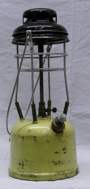

    How does the tank shape compare to this lamp?
  11. JEFF JOHNSON
    16,573
    The excellent tank looks earlier to me, the shape is different, but i have never seen the excellent in the flesh, only that one advert.
  12. Mackburner
    I don't think this tank is likely to be as early as an Excellent. From the shape of it with that small base rim flange and general shape it looks like an extended late 50s to mid 1960s tank. Given that the other two yellow BR type lanterns are all around 1960 I assume this one is also from about that date. From memory it is not date stamped but I can email the owner and ask. ::Neil::
  13. Mackburner
    OK I now own this lantern.
    Taken me years to wheedle it out of Mike Parker but succeeded today. The tank is for sure a Tilley product because I found the stamps in the base plate. Marked Made in England and 161XA. So made in the Hendon factory in January 1961. Really very difficult marks to see with the naked eye and even with the super enlargement of the camera it is not easy to see the Made in England stamp but the date is clear enough. Not marked as Tilley anywhere but those tank stamps are typical Tilley so I have no doubts. ::Neil::
  14. Mackburner
    And after a bit of fettling with new seals and a new vaporiser it lives. Only running at about half pressure here because the tank base is beginning to dish down and I don't want to make it any worse. ::Neil::
