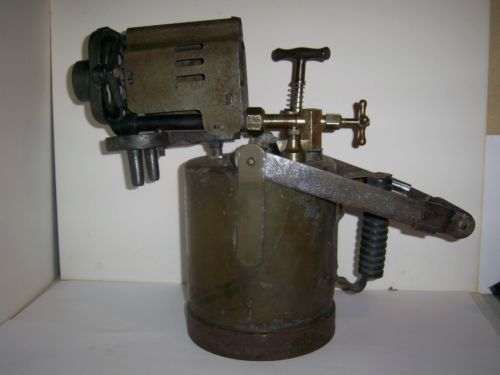

    I have recently obtained a "king size" blowlamp. To give youb an idea of size its the same height as a Tilley x246b, weighs 5kg empty and holds 5 pints of paraffin!
    It is military, made by "T&W" in 1943 and has a steel tank. Everything is complete apart from the pump washer. does anyone know where I could get one? i'd love to get this beast fired up!

    I guess you mean the pump leather? Maybe an FL6 leather will fit...
    16,869
    If you mean the pump leather then you could try to make one.
    11,096
    @Scouter Bill
    Here's the quick way of making a leather "pump cup" if you can't find one the correct size.
    1. Get a piece of suitable (rough) leather.
    2. Cut it into a circle that about 10mm greater than the diameter of the pump bore.
    3. Punch the correct sized hole in the middle.
    4. Soak the leather in water to soften it.
    5. Put it on the pump and push it into the pump tube just far enough for it to form the "cup" (the wrong way around, of course).
    6. Let it dry out.
    7. Remove the pump with the leather and reverse the cup.
    8. Soak in machine oil.
    9. Voila! Robert is your father's brother...

    Perfect method Tony.
    I have used that process many times with success.

    Using the method described by @Tony Press , I've made many a leather pump cup myself but :
    Suitable being the operative word. If the leather is too thick, it's not always suitable for most stove pumps where the leather is held firmly between two pieces of brass. Too thin, it's not always suitable for pumps where the leather is simply held in place with a small washer and nut.
    Henry.
  10. Mackburner
    Leather needs to be Vegetable tanned and about 2mm thick. ::Neil::

    I have two of these, one with a pressure gauge and one without. I've never managed to get a long flame out if either them but the heat is ferocious. That's one big burner to pre-heat so to reduce the risk of having a 4 feet long stream of burning paraffin shooting out across the camp site, make sure that the priming cup (cup ? more like horse trough) is FULL of meths. It needs it.
