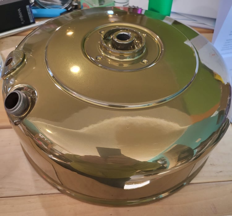

    @MYN a big part of this 316 Magnum I am going to be offering is the drama--the look of the lantern is going to be breath taking in all brass. Size wise a little bigger that the original 316L by Coleman, and it will run two generators and 4 mantles ~~~~ a monster among lanterns !

  23. F. bruce kuda United States
    Jun 2, 2021
    153
    burlington wisconsin USA
    @presscall just got my prototype font back from my powder coater-- came out pretty nice !

    @MYN , yep! the blow torch will preheat one of the generators--then the burn from that one will preheat the second-- there will be a valve for each generator~~~ this thing should be a real flame thrower for brightness
