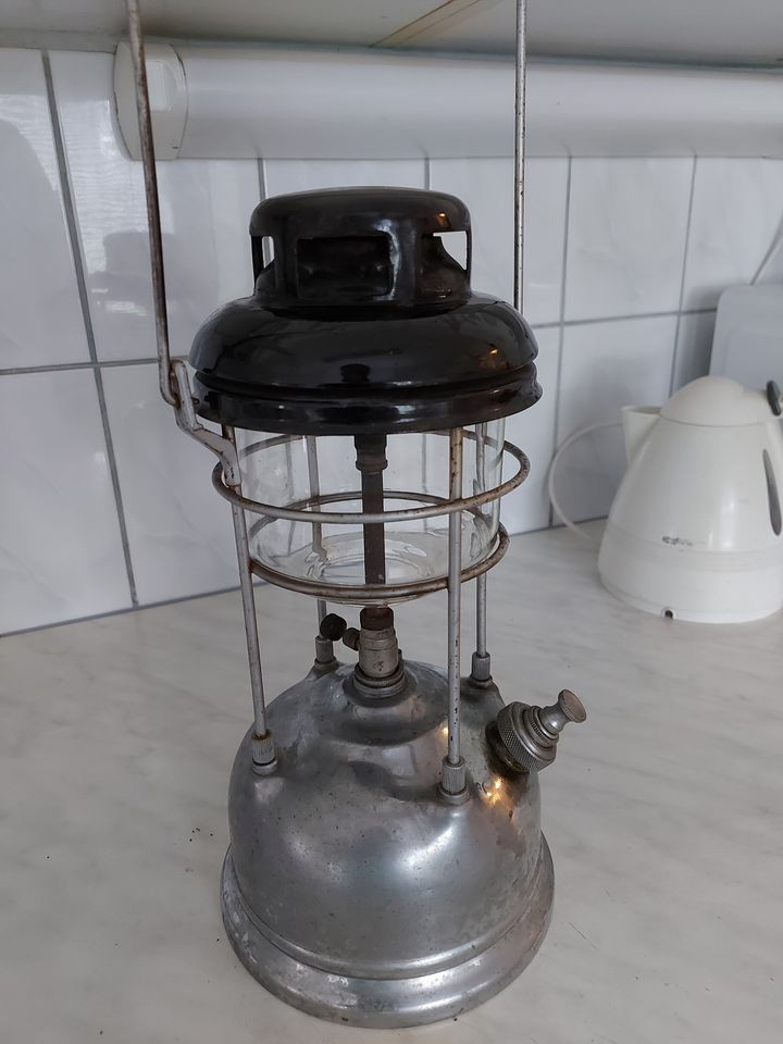

    I bought this via facebook and it hasn't arrived yet, it's a Tilley and it looks to be whole and decent shape:
    It lacks the torch but I saw another thread on this forum where someone had replaced it with a cup, which was a neat idea I thought. I have a lathe so I could probably turn myself a cup from aluminium.

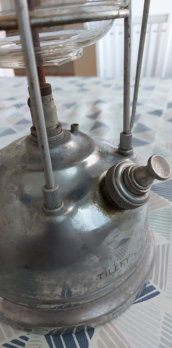

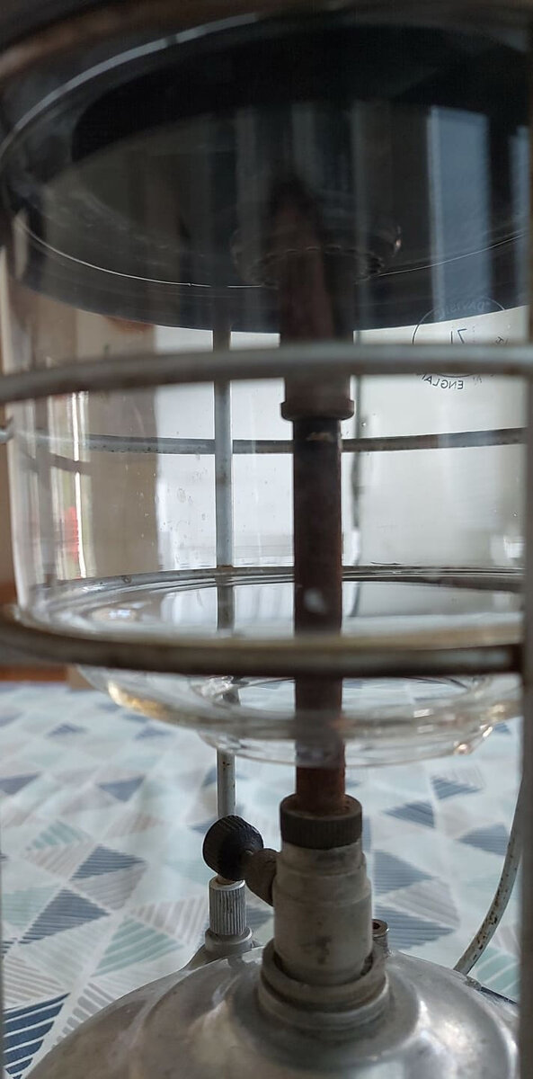

    The plan is to clean it up a bit and put it to use as an emergency lamp, or just when I feel old fashioned. I live in rural Finland and power outages do happen a couple of times a year, so this could be a nice thing to have. Sure you could just get batteries and LEDs but I think this would be a lot more fun to start up, especially for the kids.

  2. Fireexit1 United Kingdom
    3,538
    Hi @DennisCA and welcome. Yes you have a promising looking Tilley X246A there.
    You will probably want to replace all of the seals. Our sponsor sells a nice kit with all the parts you will need : Tilley Washer Kit - The Fettlebox.
    These are viton rubber which has a longer life than the original - useful if you do plan on relying on the lamp for emergencies..
    There are lots of stories of restorations on this site, and people will help if you run into any issues.
    Good luck in your fettle
    Chris

    Can't be an A with that tank. Has to be X246 from 1954 to 1957. Last of the stronger base plate fixing. ::Neil::

    Oops yes indeed it is a guardsman. :oops: Even nicer to have and to hold !

    Btw the original earlier enamel top looks to have had minimal use.. nice to see :thumbup:

    That would be highly unlikely but having said that, the version of the X246 you've bought is a very good lantern and well worth owning. Once fettled it should give you many years of dependable performance... :thumbup:

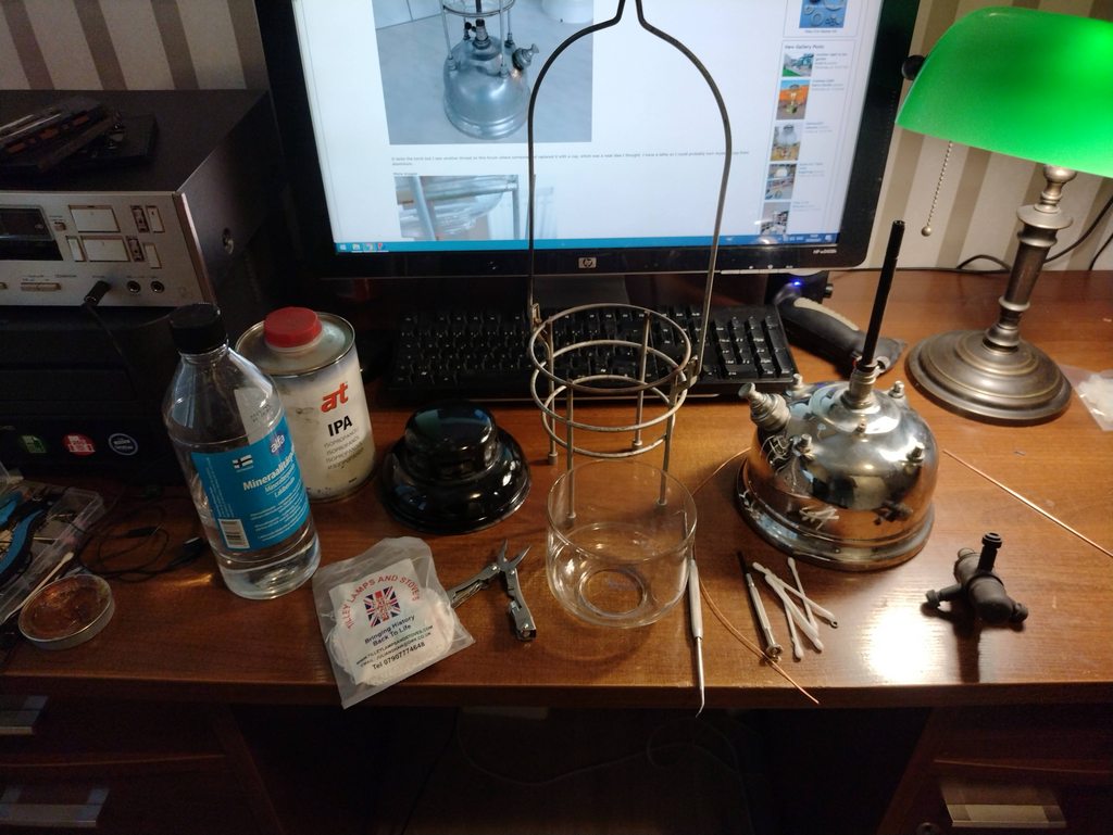

    OK I got the washer kit (and the mantles) and I have used all the parts except one of the two o-rings. Not sure where that goes.
    Lamp seems to work. Builds pressure OK, control valve works. Only thing that seems completely non functional is the pressure indicator. It does not do anything all. I also don't see a way to access it either. The inside of the fuel container seems to be sealed and brazed/soldered together.

    Oh and a picture of the lamp as is currently

    Most people use two orings on the control cock valve, I only ever use one and keep the other one as a spare.

    It's not uncommon for the pressure indicator to be stuck. And your correct, it can't be accessed without removing the base plate.
    A drop of oil can sometimes free it.
