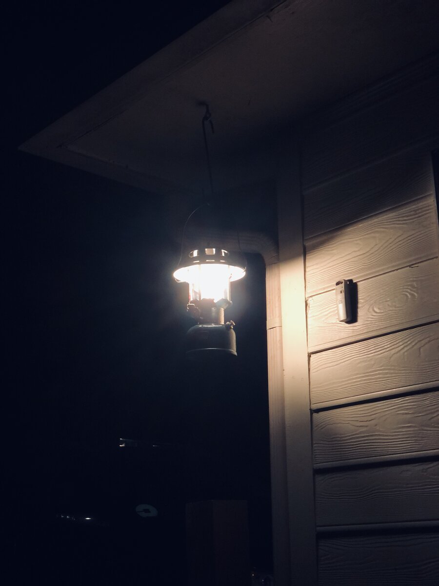

    Right now, I’m just sitting under the light of a 10/71 Coleman 228 Big Hat.
