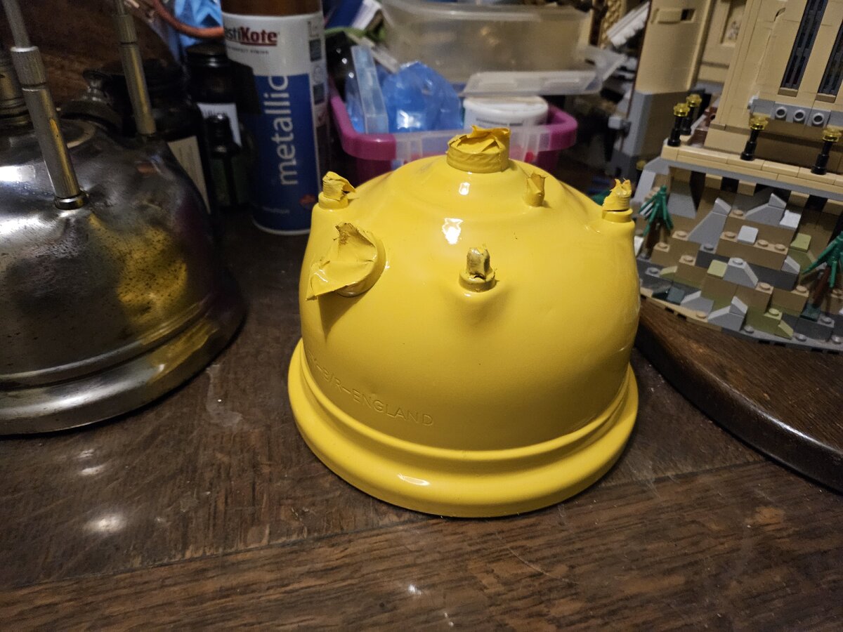

    It's perfect timing, because I'm about to do precisely that, on exactly the same fount. I reckon I'm going to use Rustoleum Strawflower spray paint as it seems to be a duller, paler yellow which is what I want. Though I did consider the Sun Yellow option they have which would likely give the brighter, glossier 'straight from factory' appearance.

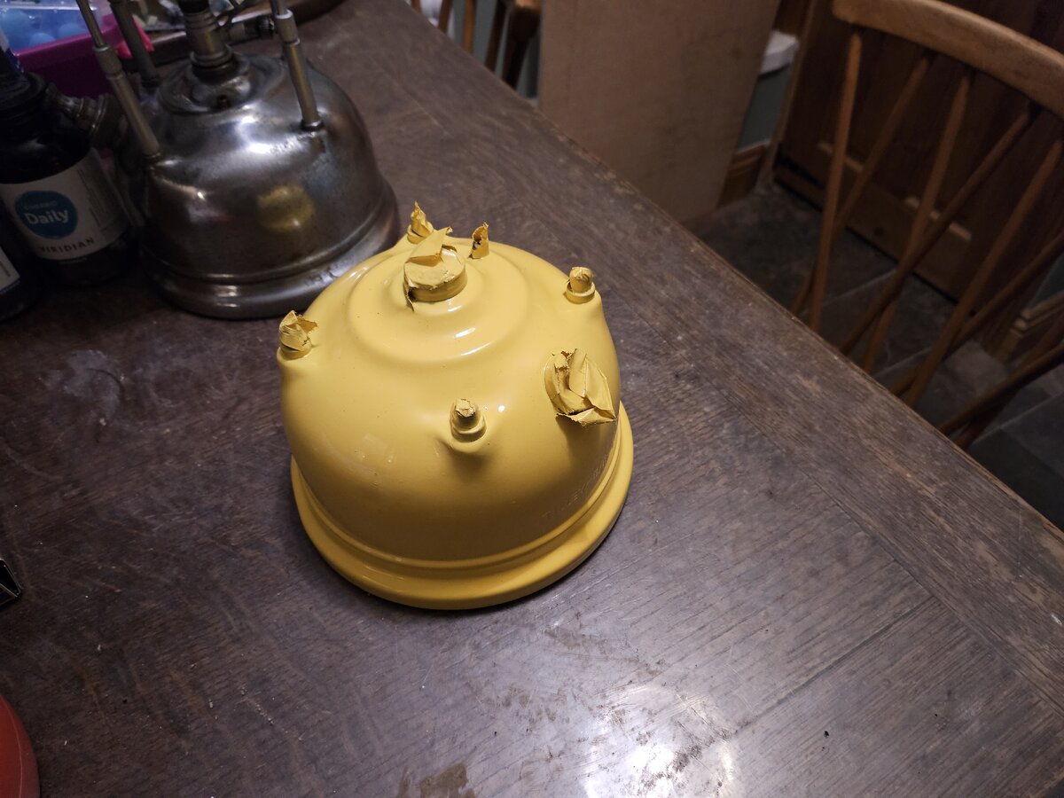

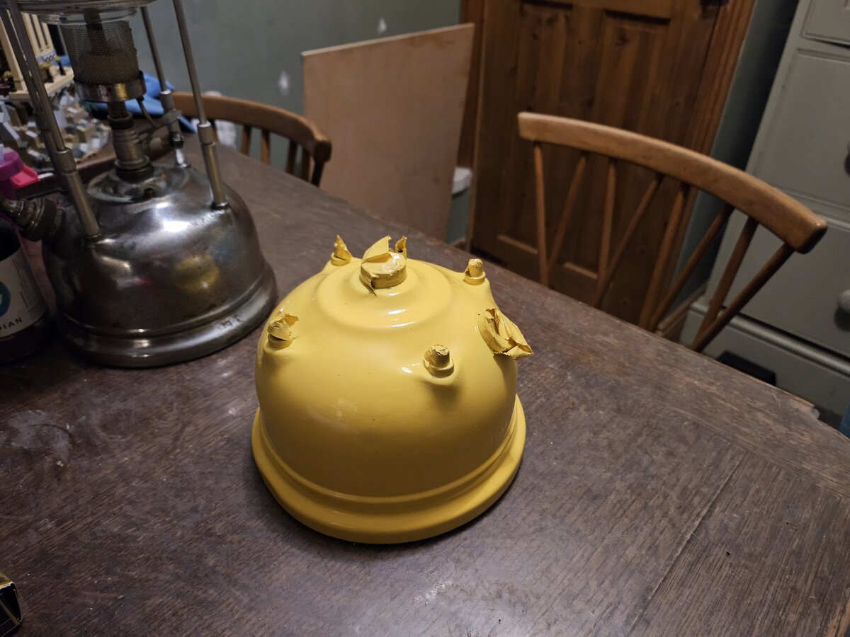

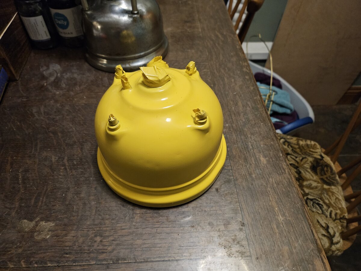

    20250220_183458.jpg 20250220_183756.jpg 20250220_183635.jpg 20250220_183543.jpg Hi. For anybody interested, here's the fount I'm doing sprayed using Plastikote Sun Yellow. It's a little more 'Sun', in the flesh it has to be said as the phone camera appears to give it a everso slightly paler hue. Just thought I'd update for the OP..

    Tbh, I tried a test area of the Strawflower and thought it was a little dull, so I then went with the Sun Yellow. The tank I have was already stripped back to bare brass and was dulled by oxidation - so I just keyed it with a medium grade sand paper, then washed it with meths, waited an hour then sprayed a first thin coat. Then wait another hour, then another. Then another hour up to 4 coats, which is what you see. I never bother with primer and cannot advise, but if you've already a paint layer, hit it with a rough sandpaper and key it heavily. That's what I do with gold Tilley tanks before respraying where they already have the rough original paint to key off. I'm sure others will chime in.

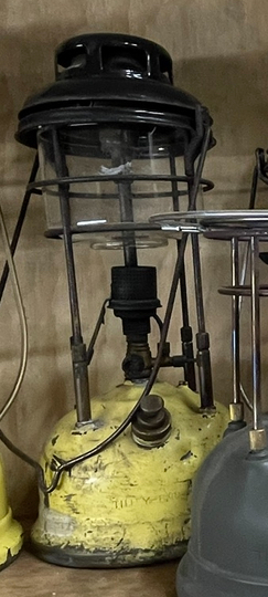

    Can you post a photo of the old BR 49 in its original finish?
    I just curious how beaten up it is currently.

    I’m up country but here’s a very poor photo from a long time ago.
    Hope it gives you an idea.
    Maybe I should leave it with its current patina.
    Views welcome.

    The Plastikote Strawflower might give you that shade of colour or slightly paler if that's what you want? For me, given these lamps are comparatively rare, that patina on yours is a little too rough. So if it were me I'd hit it with a fairly rough sanding block and give it a decent key. Then 4 thinish coats of whatever shade you settle on. In decent, restored, complete condition these yellow SR lamps are worth upwards of £300 imo, or more.

    It does look pretty rough at that stage, especially the fount's finish.

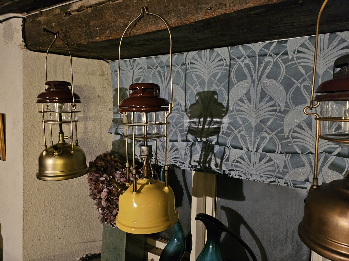

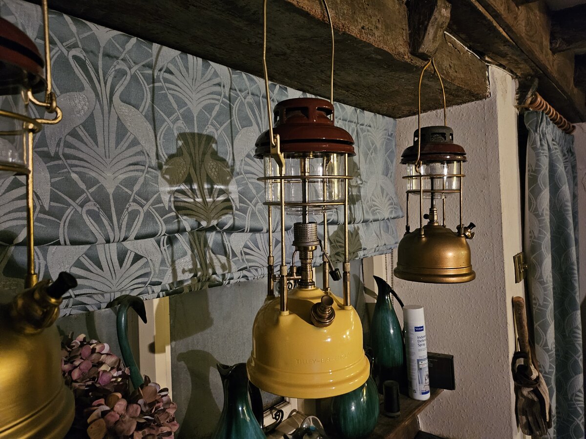

    The finished product, back together and hanging in the front room. I gave it 3 days on the backburner for the paint to properly cure. I'm happy with the shade of yellow, but obviously isn't quite accurate. Hope you post some pics of yours when done @achich 20250223_213224.jpg 20250223_213256.jpg

    @Muzzleflash That sure has come up well, very impressive mate, congratulations.
