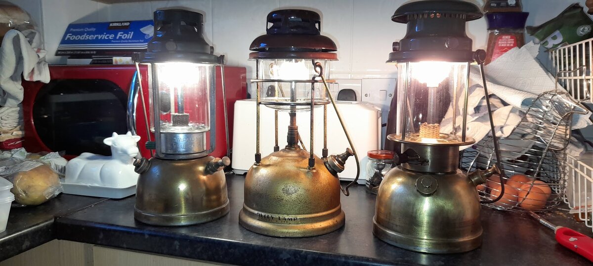

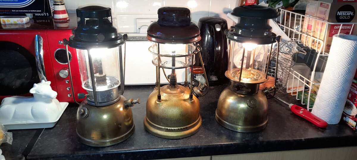

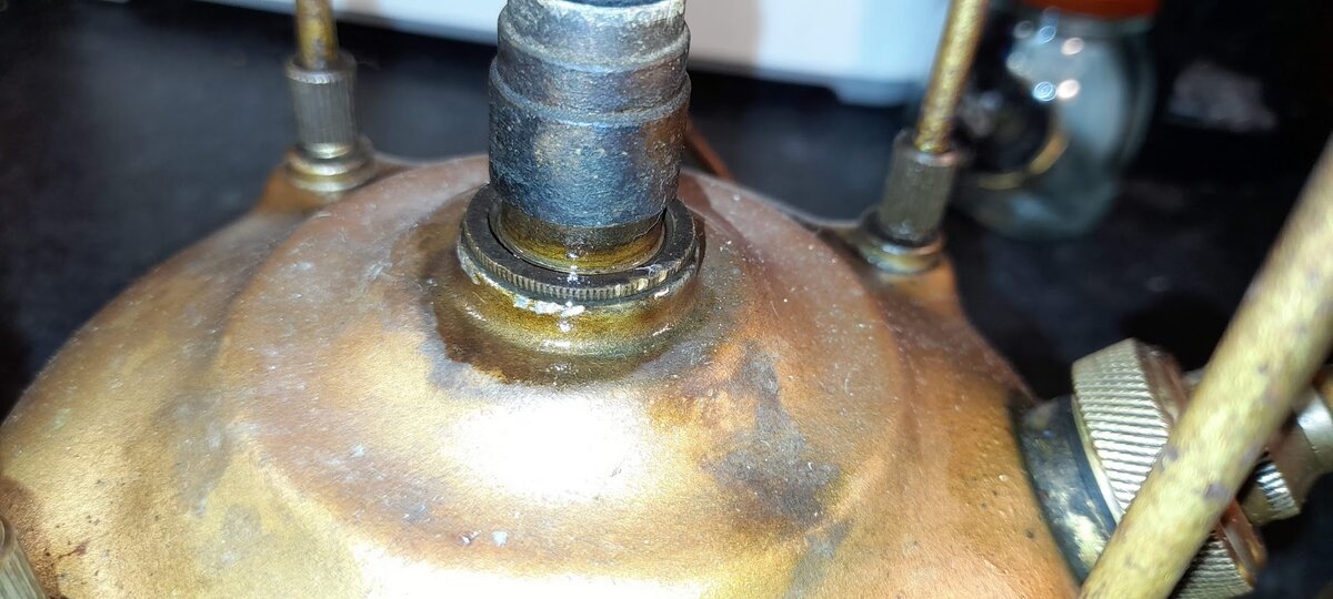

    I fired up these 3 for a bit of a photo op, plus check out the Tilley because I suspected a leak. Sure enough there is a slight leak from the tank/control cock seal which I have not long replaced.
    They look nice together, and the 305 gives off a nice bright yellowish light because theres an old Vapalux mantle in that one.

    @David Shouksmith Schoolboy error there....I had accidently put the old washer back in! :oops: . I managed to work out the collar to clock the control knob spindle to where I wanted it to point.
