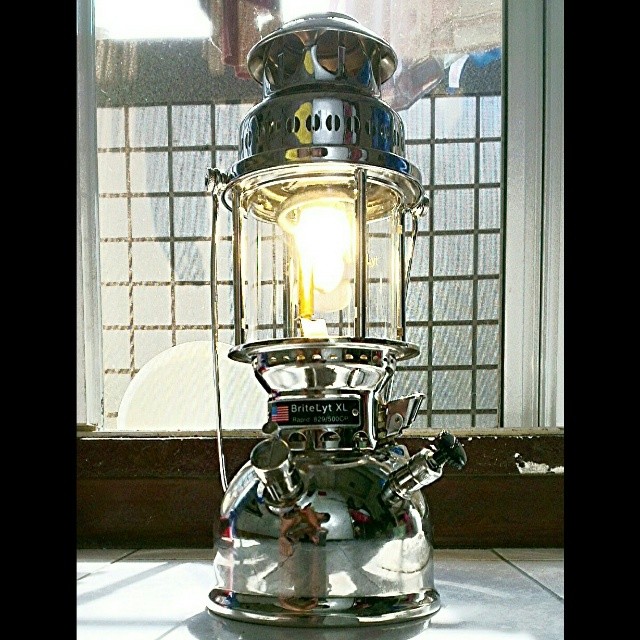

That is New Britelyt 500CP, I have one and good looks for me !! And the customer service of Britelyt team is satisfied of me. http://instagram.com/p/hJSHAxlMyB/ Tomy
This is the first time I have realised they don't call them Petromax anymore. They have changed the design of the metalwork as well so they aren't identical. Probably still come from the same factory.
