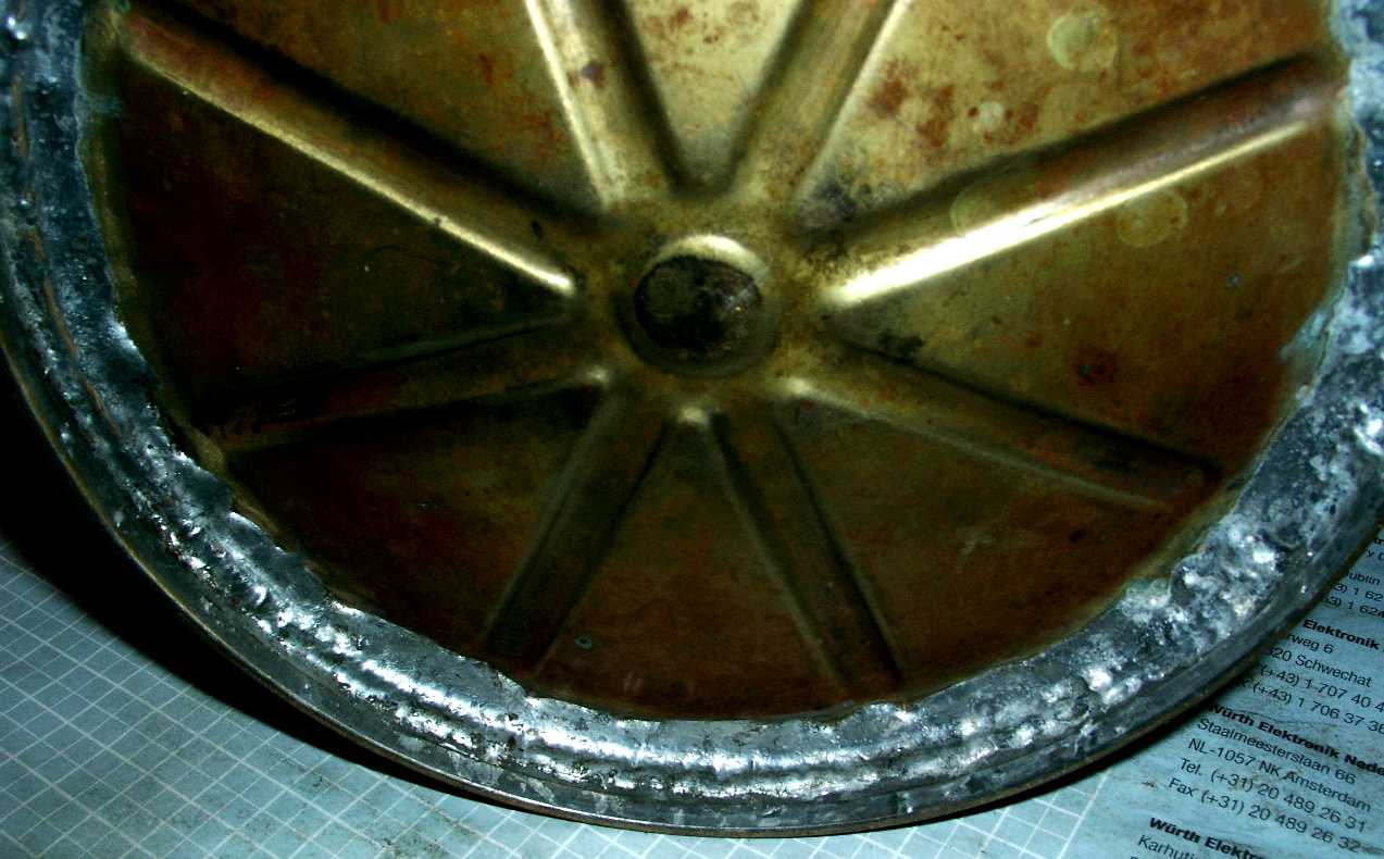

    I've fettled an old Aida 214 which had just the same problem. I found that the joint of the fount got a bit loose around the rim, in the notch where it is crimped. There were also some stress cracks in that area. So I decided to carefully hammer the notch outwards (towards the rim) so that the bottom got pulled inwards again. I used a piece of wood which would not damage the thin brass sheet. Then I fitted a brass wire of 3mm dia. inside the notch and soft soldered it. It will now hold the force and therefore prevents the bottom from coming out again when the fount gets pressurized.
    The solution works fine and the fount is tight around the soldered joint, but I only use low pressure on this lantern now (anyway, it's a historic piece, and it doesn't get lit so often).

    I have knocked an old bottom-bulging Petromax fount back in so that it could stand upright again. Did that with a rubber mallet and some rags lining to prevent unwanted indentations when doing so.
    However, when i pumped it up using its own attached handpump close to about 3bar, the bottom bulged out again. No leaks found though.
    I don't see any evidence that Schrader valves were ever fitted to it and then overpumped with something other its own handpump. I suspect it has a weak bottom.
    I'll say it would need some further reinforcements either internally or externally. The bottom plate of the lantern is not thick or stiff enough to resist bending under that pressure.
