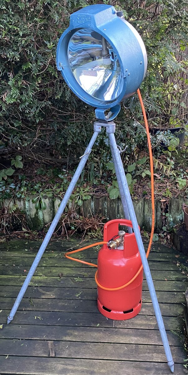

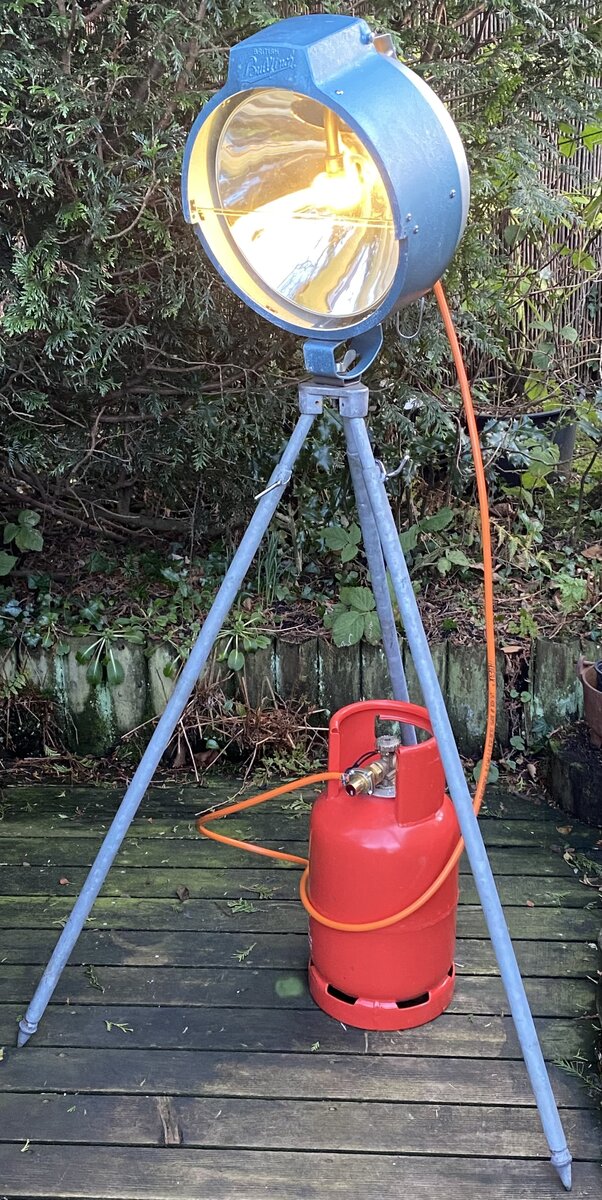

    I equipped the Mini-flood, Handilight and No.1700 floodlamp with regulators, hoses and mantles and they work very well.
    Here’s the large floodlamp and tripod. 6kg propane cylinder to power up. Piezo sparker ignites the burner reliably.

  9. pete sav
    pete sav Founder Member
    Sep 7, 2010
    1,175
    West yorks
    Looks to be a good light from it john :thumbup:
