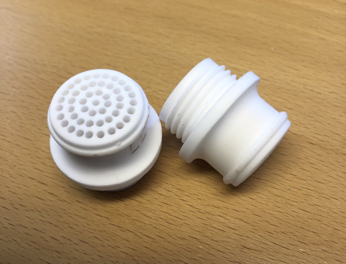

    Ended up ordering a couple of nozzles from Korea...looks solid.
    Will try to fire up my mysterious lantern this weekend!
  19. MYN
    Yeah, those are hard, white alumina burner nozzles. Does the thread fit in?

    Yes threads fitted nicely. Just had her lit up, needs some fine tuning still though, nozzle works like a charm!

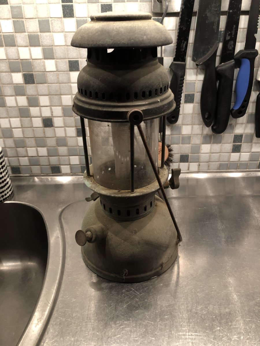

    Your "mysterious" lantern looks to be an Optimus. A nicely proportioned lantern, as mentioned previously Fogas carry innumerable parts for these.
  22. Peter Aland Islands
    Feb 26, 2019
    84
    Finland
    @eiremax
    Yes, it sure looks like an Optimus. No inskriptions, stamps or anything on it though.

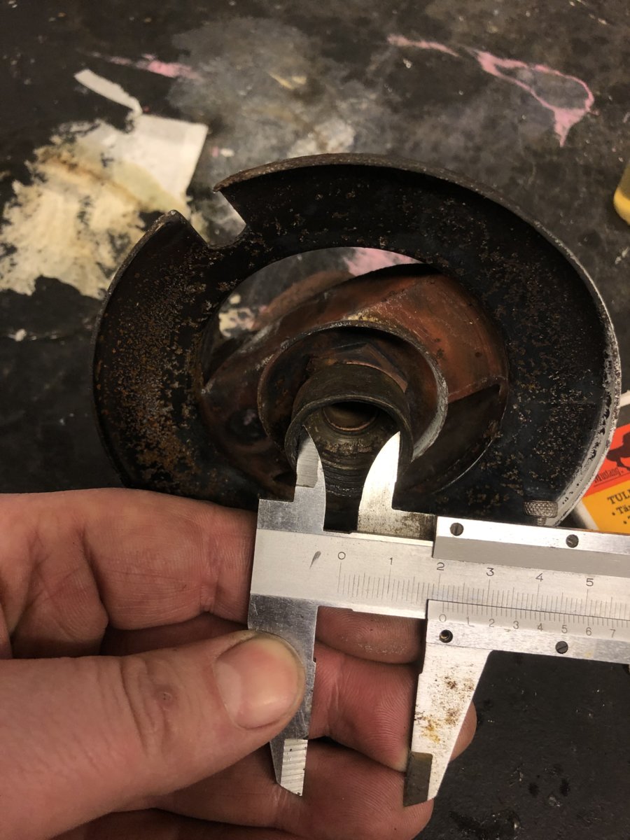

    What's the thread size on the 250cp burner nozzles? Is it anything like 5/8"BSP?
  24. Peter Aland Islands
    Feb 26, 2019
    84
    Finland
    @MYN
    Outside diameter of the nozzle threads is ~21mm if I remember correctly. Sorry to say I have no idea about the pitch of the threads.
    /peter
  25. Henry Plews
    3,066
    According to my thread gauge, the pitch is 14G i.e. 7/16 BSP.
    Henry.
