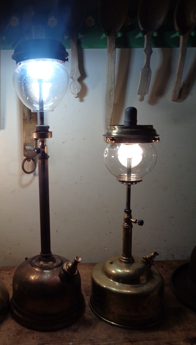

    i have recently aquires a brand new burner from julian shaw,and fittel it to my TL10,the lamp burns so much brighter than my other tilley table lamp,they both use the same matles,fuel both have new vapourisers,can the brightness really be down to the burner? any thoughts?

    Try swapping the whole burner round and see if it makes any difference,that may answer your question

    so what makes a burner become less efficient? would polishing the inside help?

    Tilley burners wear out from the friction of the hot gas flowing through. On an old burner the ring of small holes can be seen as oval and sometimes some of the holes run together. This wera alters the mixture slightly over time and also the air tube threads erode and start to leak slightly. The other change is the main burner casting distorts and can become almost triangular. This also causes slight leaks where the dome screws on. Polishing the insides can only help but I doubt it will ever fully refurbish an old worn out burner. I don't much like the modern burner but a new one can often be better than a worn old one. ::Neil::

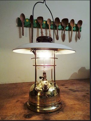

    yes and yes,behind are some of my wifes spoons ,i carve spoons professionally and made the spoon board for her too for her birthday,heres a better pic of them with a lamp....
    and yes the new burner made all the difference,ive bought a couple more for my lamps and i have seen a drastic improvement on lamps that had had everything else done like vape and service.
