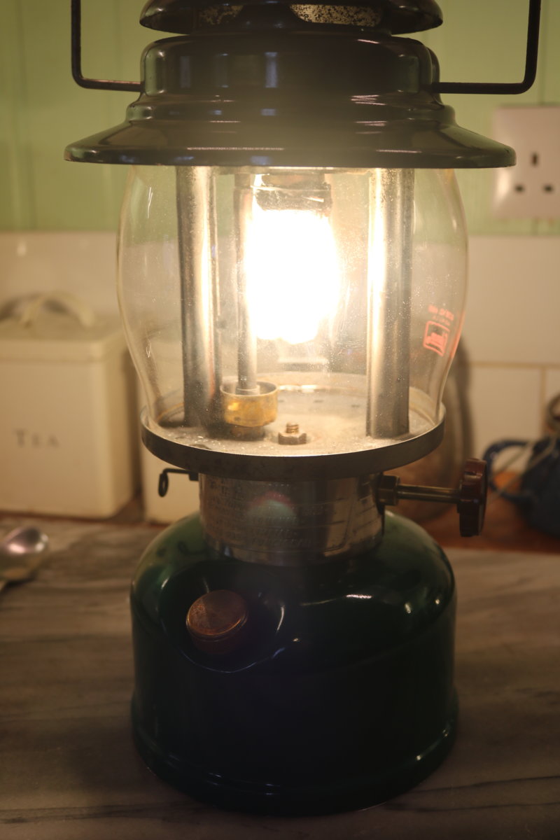

    I used my 639 to perform the test as it worked OK before with a Butterfly No. 41 as seen here....
    Fitted ready to burn in the mantle.
    And after priming with meths/denatured alcohol, here is the result...
    The last photo was stopped down so you can see the mantle in operation - it wasn't really that dull! Actually, this is by far the brightest light I've got out of any Coleman Lamp so far! In bright sunshine it left spots in my eyes when I looked at it!

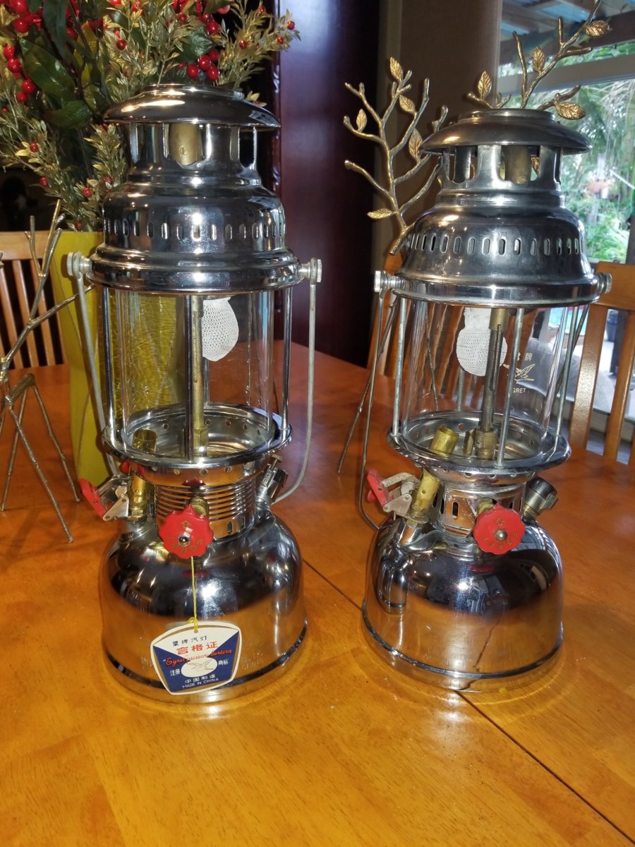

  13. Chip Packard United States
    Nov 12, 2018
    72
    Coconut Creek FL
  14. MYN
    @Chip Packard
    Those mantles are the globular type, different from Colin's, which are more elongated.
    All of them vary considerably in consistency. Some would shrink more than others.
    Genuine Butterfly mantles such as those 500cp ones available from St Paul Mercantile would shink somewhat less.
