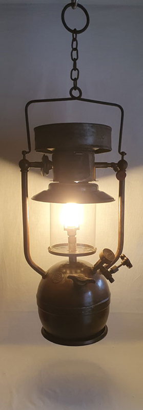

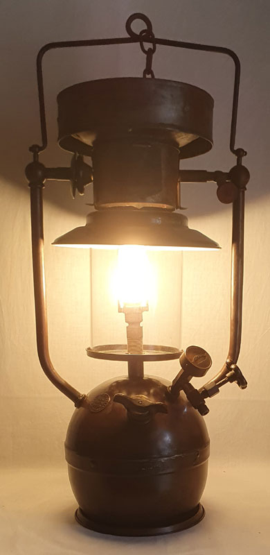

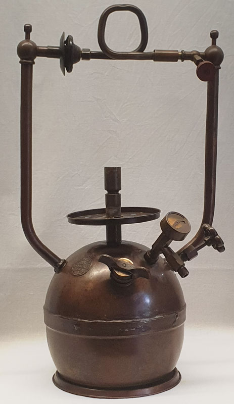

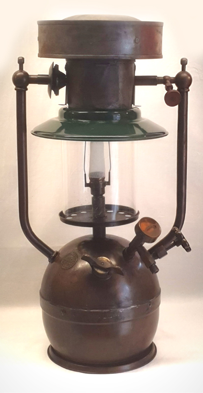

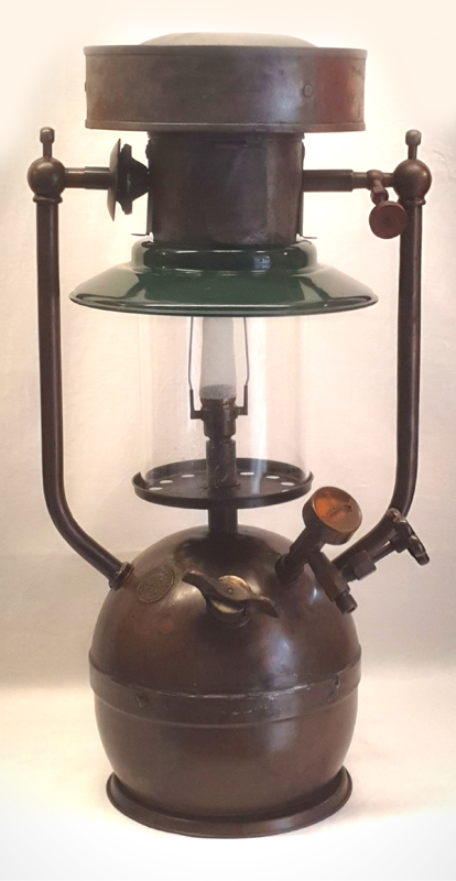

    Hi all,

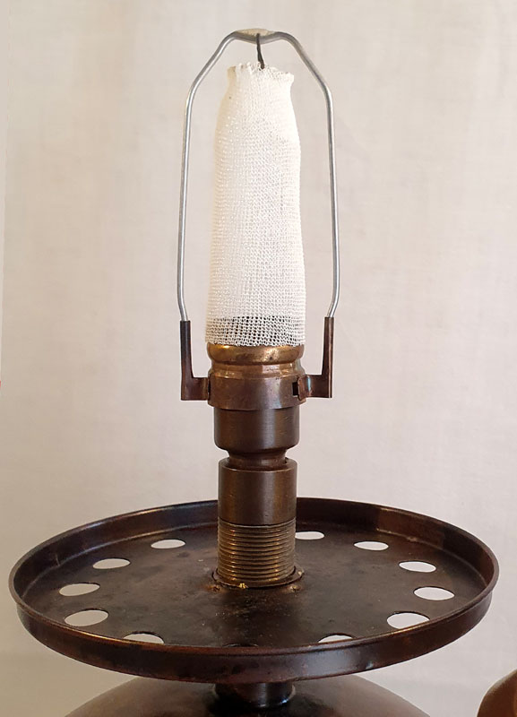

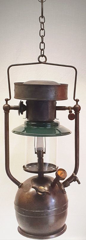

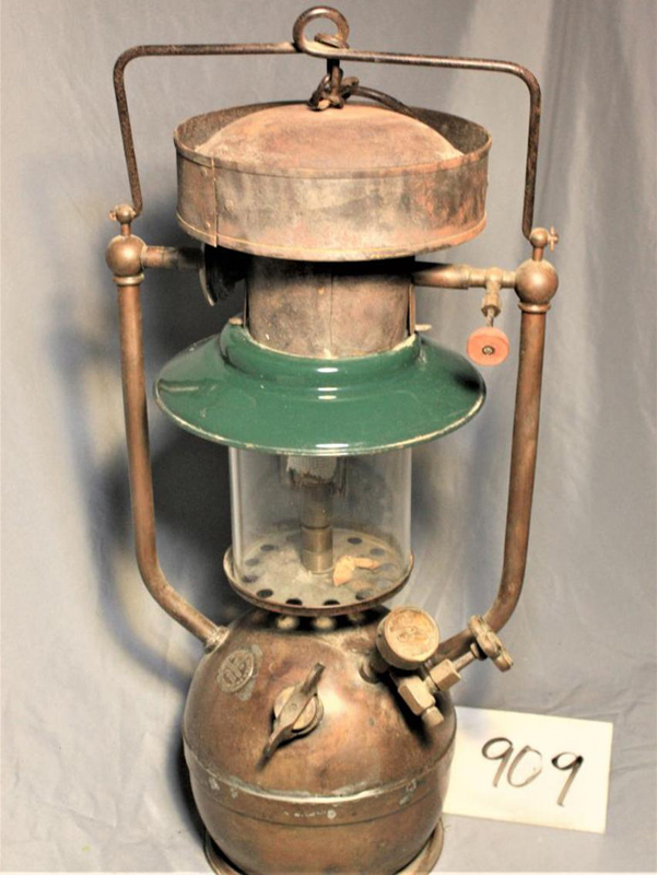

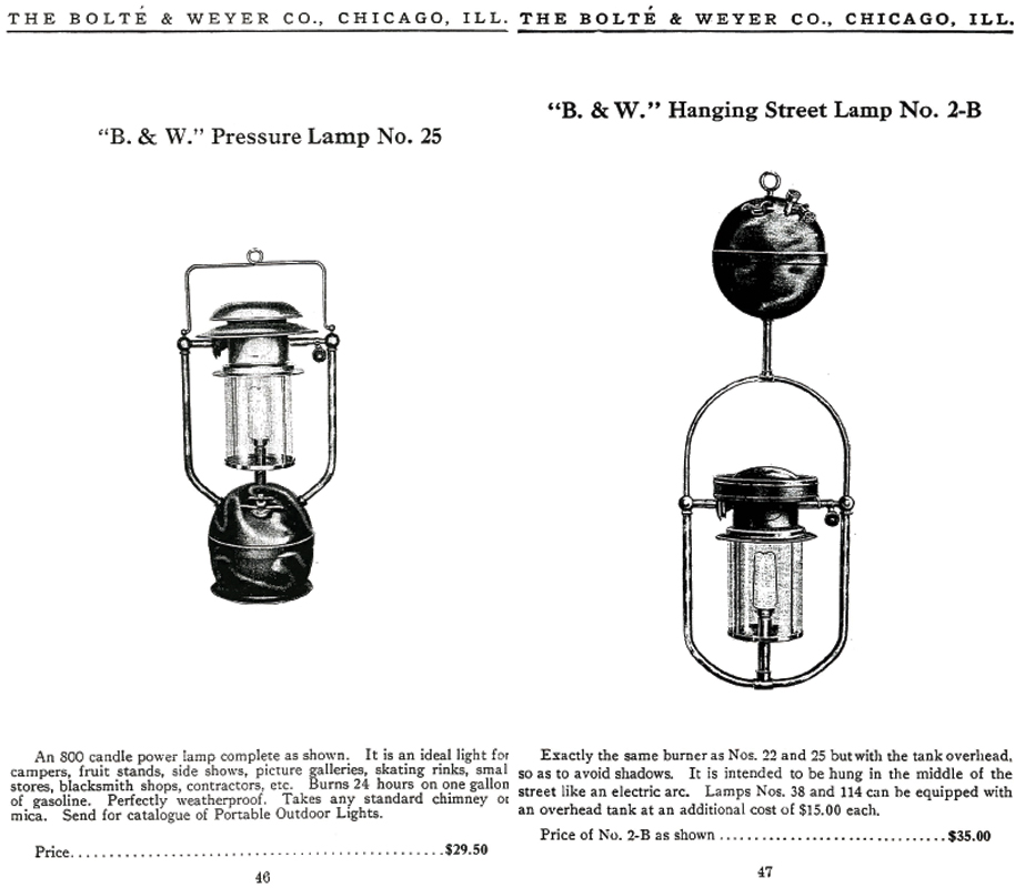

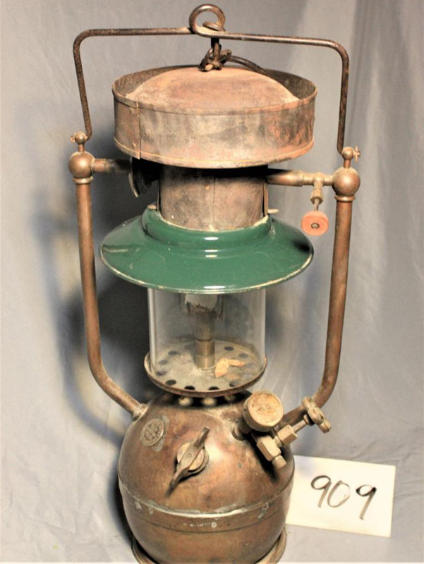

    This is a rare American Arc type of lamp from around 1910, made by the Bolte & Weyer Co. Chicago. In a B&W catalogue from early1910,s you can find a similar lamp Nr. 25, but that lamp has an indoor type of vent. The B&W lamp Nr. 2-B has a burner unit like my lamp and also with the outdoor type of vent that also you can find on mine. So this is a No. 25 lamp with an outdoor type of vent.
    I have not seen any other B&W catalogue, so I don't know if this lamp was given any unique numbering.

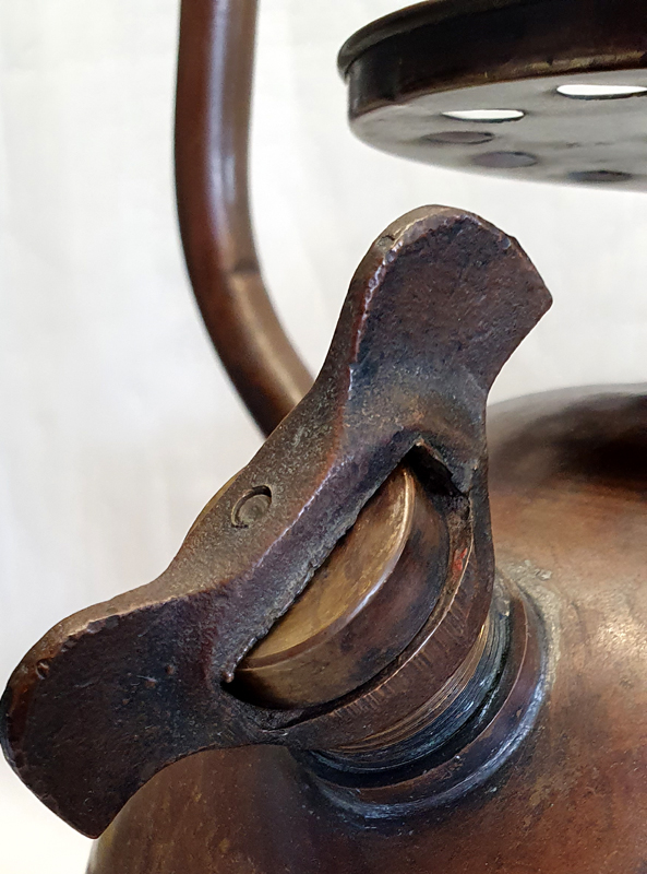

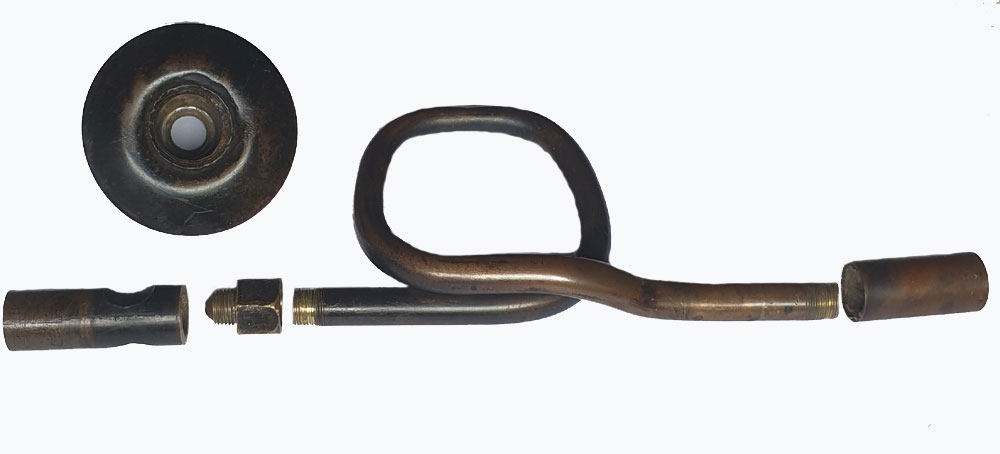

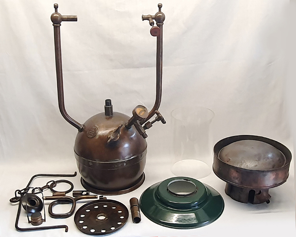

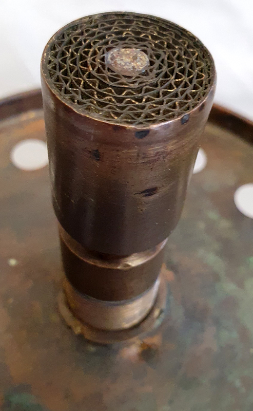

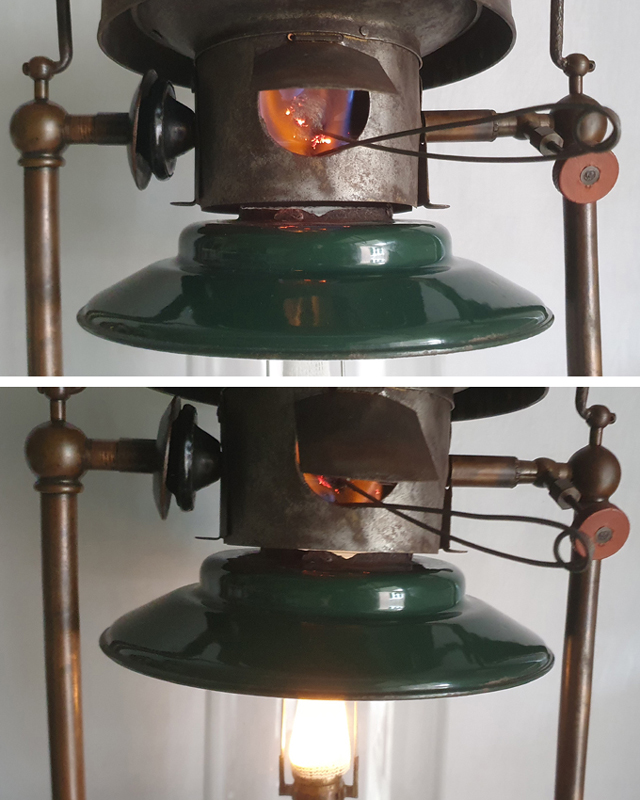

    This is a gasoline fed lamp with a horizontal overhead coiled generator. It has an upright gas burner and uses an upright mantle. It was probably used in outdoor locations, but maybe also for commercial use in cafés, stores and work shops.
    The lamp was said to give a light output of 800CP.
    My lamp was pretty much complete and I just had to make a good cleaning and new washers.

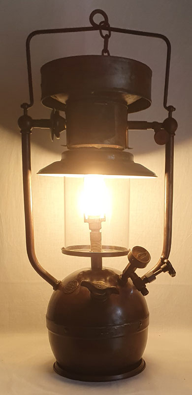

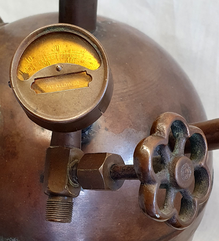

    Very easy going light up and it gave a good light output already at 7 psi (0,5 Bar). Also a very silent lamp, just a faint hissing sound.
    /Conny

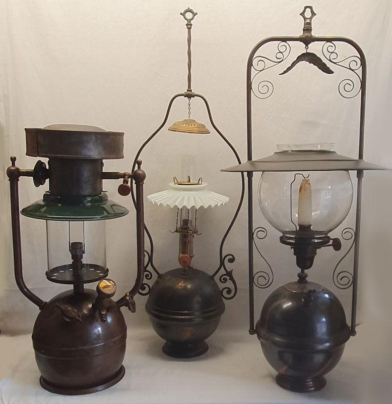

    a couple of lamps from my Arc lamp collection .... Bolte-&-Weyer-lamp-with-Sup.jpg
    Bolte & Weyer Arc lamp
    The Bystrom Arc Lamp Design Nr.5
    No.1 Arc lamp Superior MFG Co.

    Thanks! @Fireexit1 Yes, I think they wanted to promote their lamps against the most powerful light source of that time - the electric Arc lamp!
    /Conny

    It looks as if in this design the evaorated (hot) gas is lead through a tube inside the tank into the vertical upright burner. Doesn't this cause the tank to get hot and build up more pressure than wanted?
