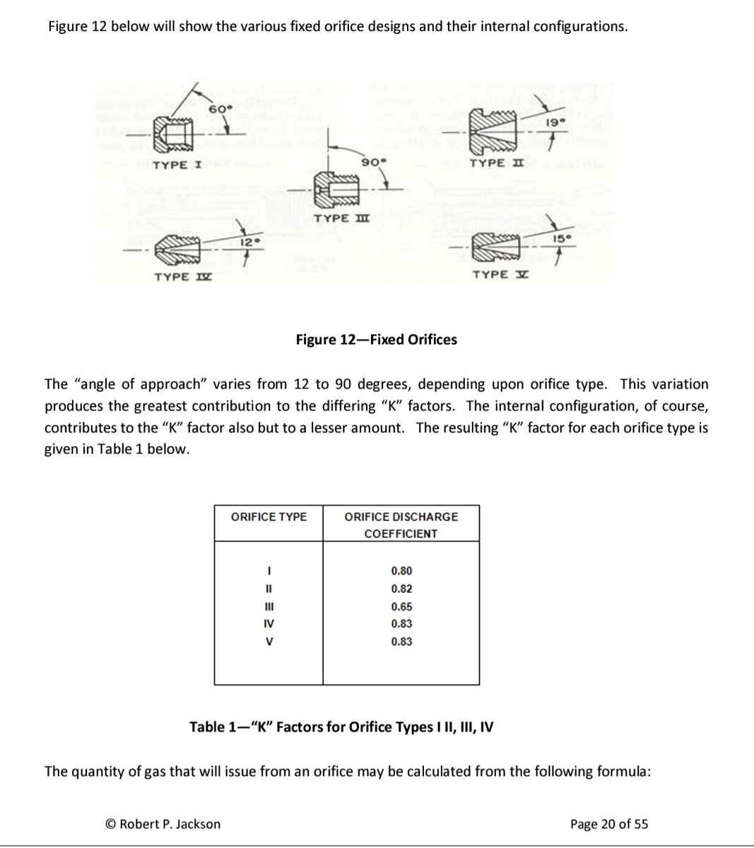

    *With reference to the following generalities:
    Based on the above, the orifice discharge coefficient, Cd ranges between 0.80 (with 60°angle of approach) to 0.82 (with 19° angle of approach).

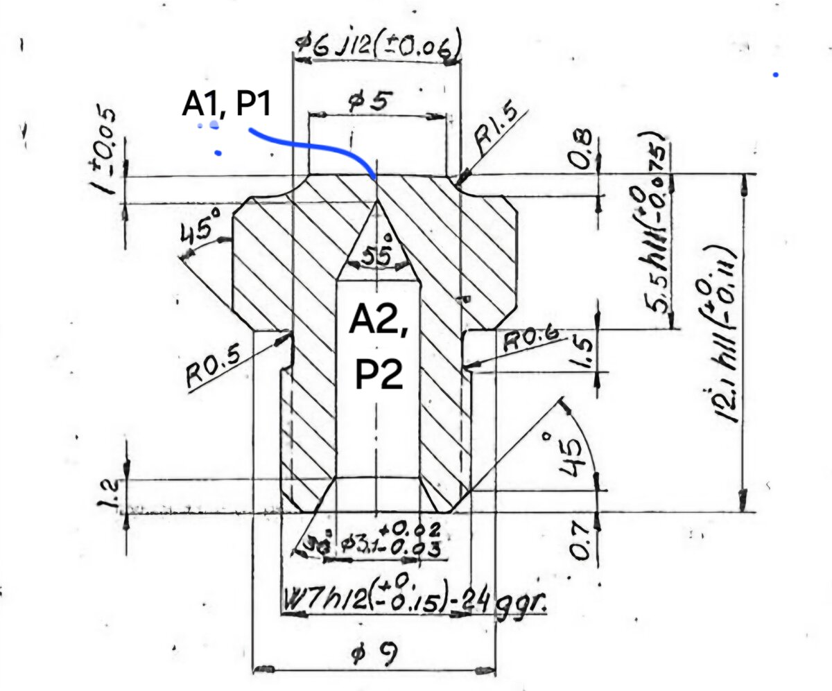

    and the cross sectional drawing of the Optimus lantern jet:
    For this, it is assumed: Cd = 0.8158536585 (with 55°÷2= 27.5° angle of approach for the Petromax/Optimus jet or gas tip). **since they are pretty much similar in design, size and geometry.
    A2 = Cross sectional area of the gas tip, jet or nozzle orifice.
    A2 = π (r2)², where r2 is radius of orifice.
    A2 = π (D2÷2)², where D2 is 0.24mm÷1000mm/m
    A2 = π×(0.24÷1,000÷2)^(2)
    A2 = 4.52389342E−8 m²
    A1 = Cross sectional area of the internal fuel path immediately upstream or just before the jet orifice.
    A1 = π (r1)², where r1 is the radius of the area, A1.
    A1 = π (D1÷2)², where D1 is 3.1mm ÷1000 mm/m = 0.0031 m.
    A1 = π (D1/2)²
    A1 = π×(0.0031÷2)^(2) = 0.0000075477 m².
    P1 taken as 200000 Pa or kg/ms² (2 bar).
    P2 taken as 101325 Pa or kg/ms² (atmospheric pressure at the jet orifice's outlet).
    ρ is the density of liquid kerosene @15° or 20°C, which in general, usually ranges between 780 to 810 kg/m³. Assumed: 800kg/m³
    Here, I would be using the SI Units in the calculations.
    Therefore, substituting the values into the equation would give Q = 0.8158536585×4.52389342E−8×√(2×(200,000−101,325)÷(800×(1−(4.52389342E−8÷0.0000075477)^(2))))
    = 5.79703608E−7 m³/s
    or 2.0869329888 litre per hour.

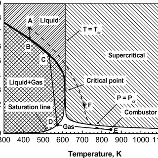

    The following shows the phase
    diagram typical of similar kerosene substances:
    However, I'd assume the fuel
    temperature would somehow be
    be limited by the highest or
    end boiling point of the heaviest
    fraction in a typical kerosene at
    atmospheric pressure for an open-ended path.
    I'd assume this to be 300°C or 573.15K for a kerosene with a typical boiling range between around 150 to 300°C.
    Therefore, T1 = 573.15 K in this case.

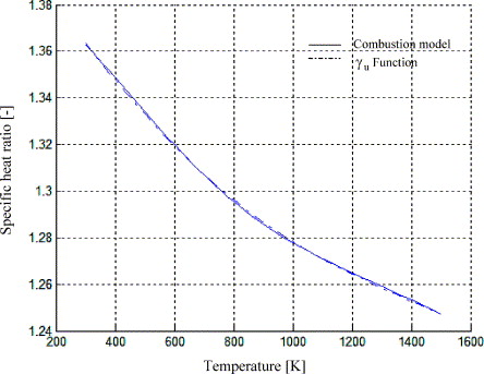

    γ is the specific heat ratio of vaporized kerosene @T1 = 573.15K.
    Note: This value represents the ratio of the specific heat capacity at constant pressure (Cp) to the specific heat capacity at constant volume (Cv).
    (γ = Cp/Cv).
    In general this value would slightly decrease as the temperature increases. The temperature dependence would appear something like this:
    The exact validated figure at the specific temperature(573.15K or some other figures) for vaporized kerosene is hard to find due to scarcity of such data. They are usually only found from specialized research papers, publications and journals. Usually, such info are used in the field of jet and rocket propulsion systems. In a rough sense, this might be infringing into the realms of 'rocket science'.:^o
    From some sources it would usually range between 1.1 to 1.35 for kerosene or similar multi-hydrocarbon mixtures' vapour at approximately 573.15K.
    It is certainly different from the values for liquid kerosene at lower temperature ranges.
    In this case, I'd arbitrarily use γ = 1.2.

    The angle of approach within a jet orifice is merely a single factor which affects the coefficient. I only used that to substantiate my previous assumptions out of convenience since, I happened to have at least one reference about that on hand.
    In fact by basic definition, its actually the ratio of the actual flowrate over the theoretical flowrate. As mentioned earlier, I would not be able to know the actual flowrate due to insufficiencies on my measuring means.
    Besides that I was also unable to incorporate other revelant factors such as Reynolds numbers, gas expansion factors, etc. due to inadequate expertise :).
