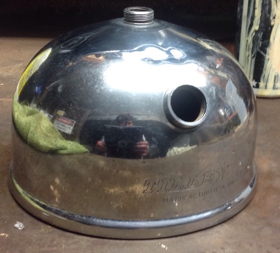

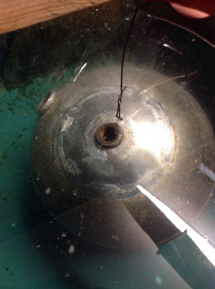

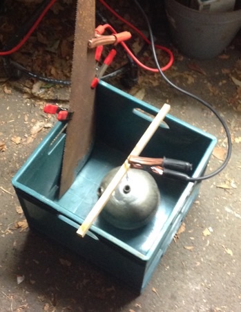

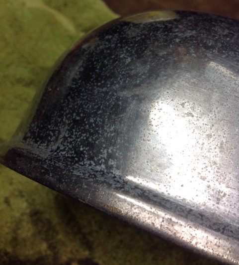

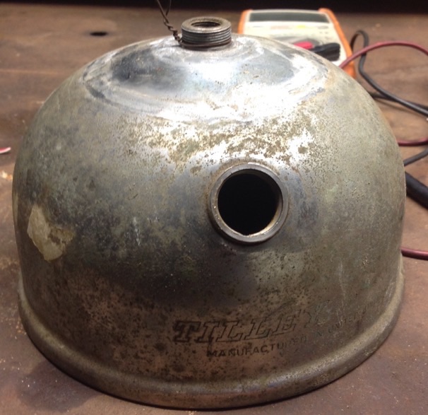

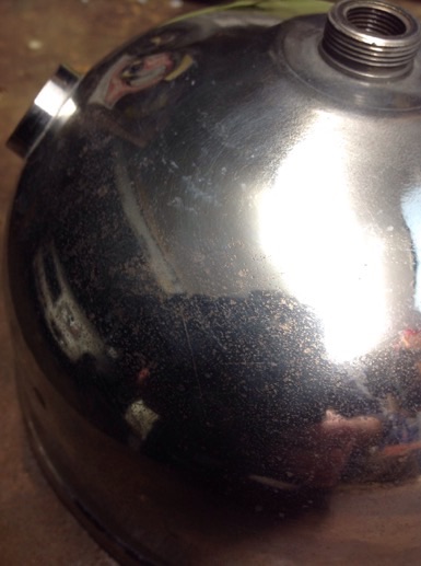

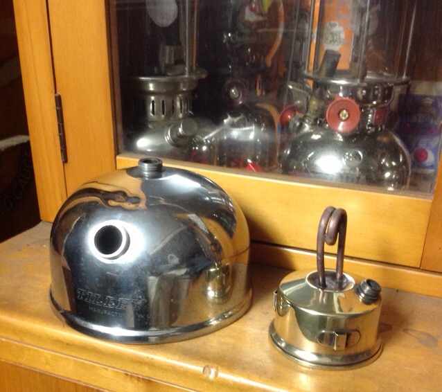

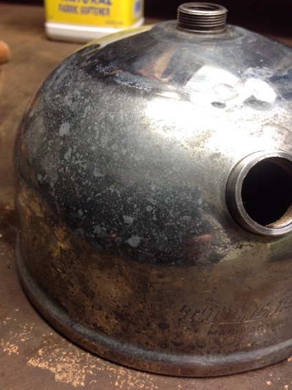

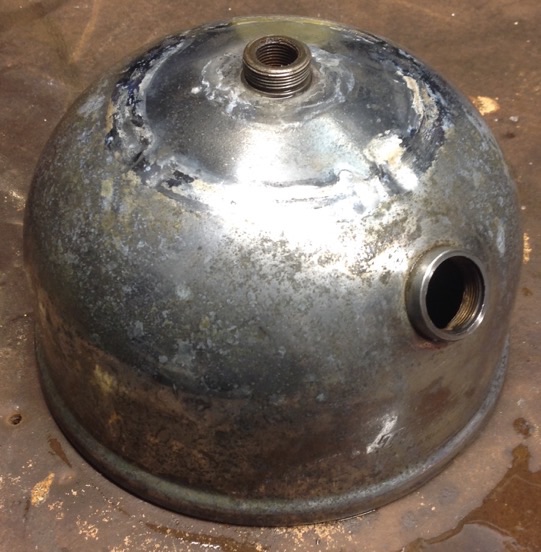

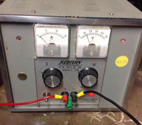

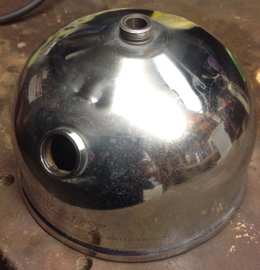

    Test 1 - Tilley font, rough to touch with mild oxidation.
    The set up - suspend font in tank, old saw as sacrificial anode. Power supply set, washing soda - 1 T per 3 ltr of water
    Bubbling away, you can see everything lifting up
    Font straight after treatment. It was smooth to touch
    A rinse with fresh water and a gentle scrub with a soft bristled brush and a quick 5 min hand polish. Results are pretty good

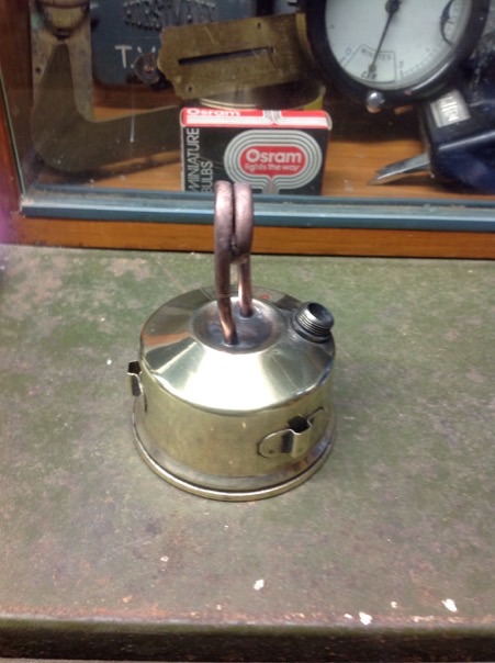

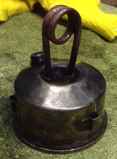

    Next test, old handy campers brass stove
  22. mharron
    May 4, 2014

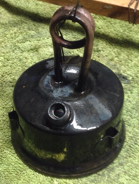

    134
    1/2 hr in the tank - nice and black (looked like it had stripped it)
    Quick rinse and scrub (still didn't look promising)
    Polishing was real quick 3 min by hand
