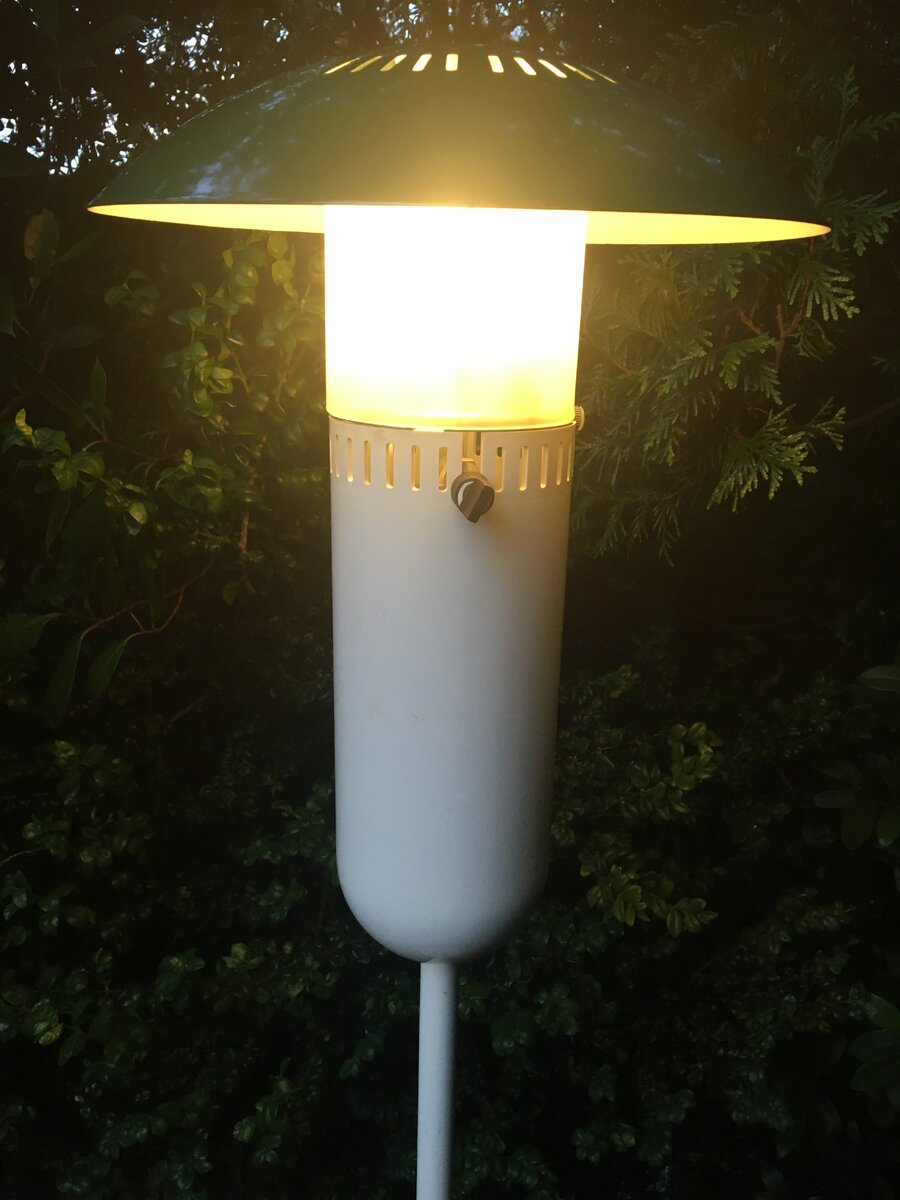

    A late 1960’s rarity from Campingaz, here making use of its ground spike.

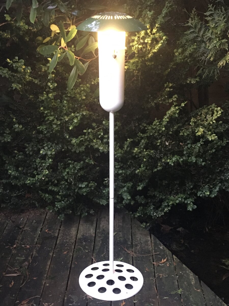

    Here, it’s base plate …

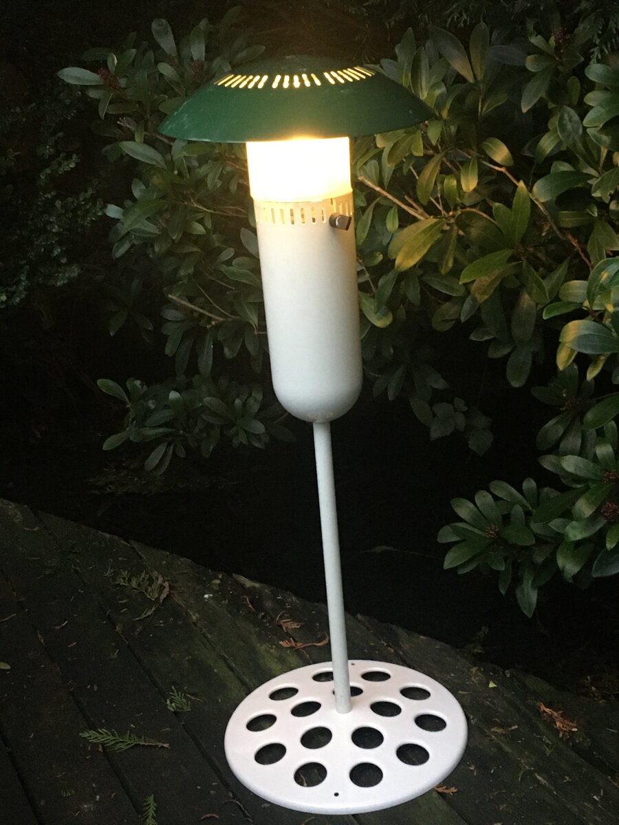

    … and here, with one of the column sections removed.

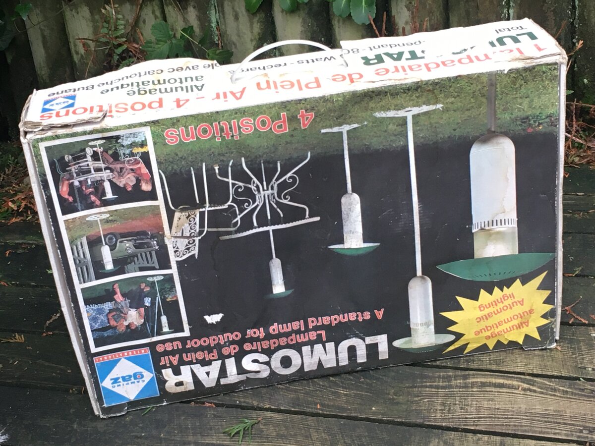

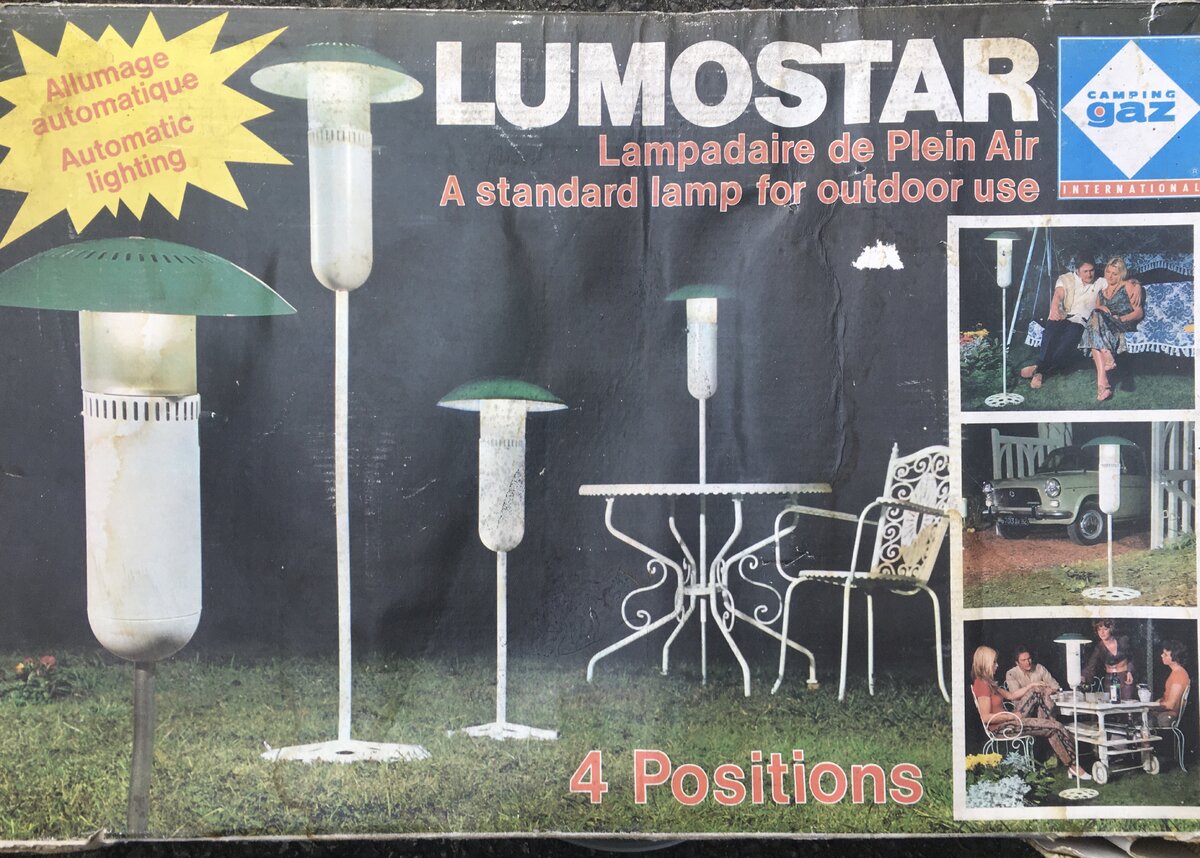

    The storage box illustrations demonstrate the options.
    A detail, a contemporary auto, a Fiat 1100 perhaps.

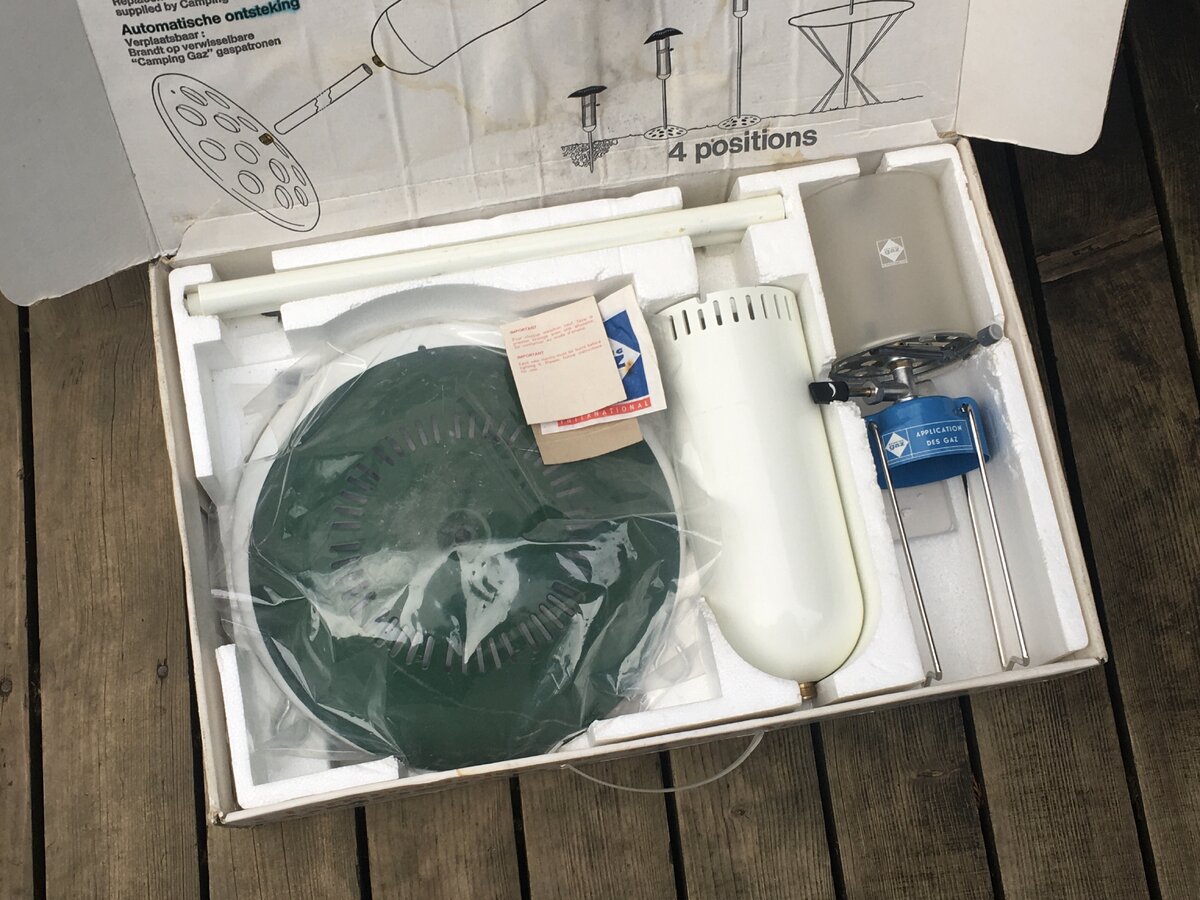

    Assembly schematic on the inside of the box lid.
    Components packed …
    … for transport, suitcase style.

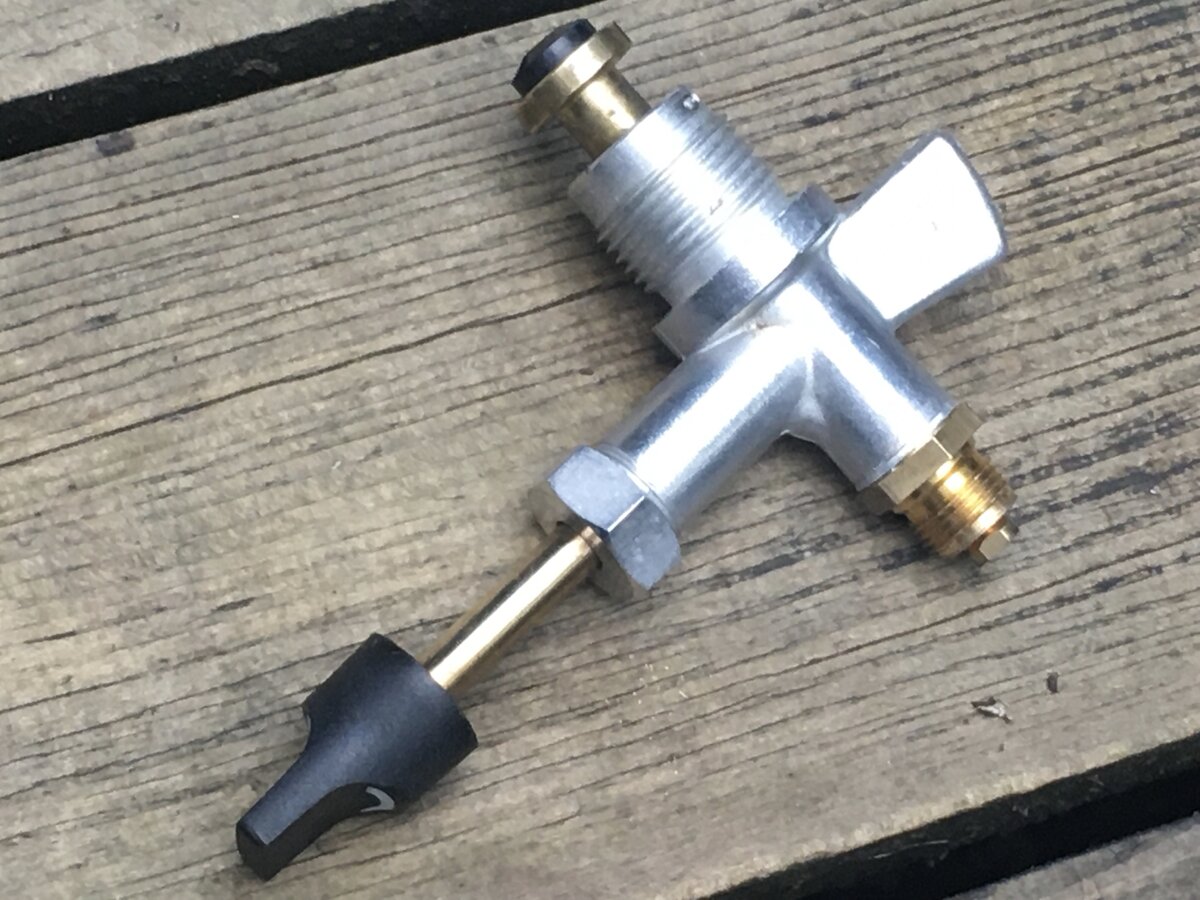

    Lumogaz-pattern components. The sprung-loaded piston and control spindle O-ring seals had age hardened and were replaced. The ‘dome’ seal mating with the gas cartridge was in good condition.

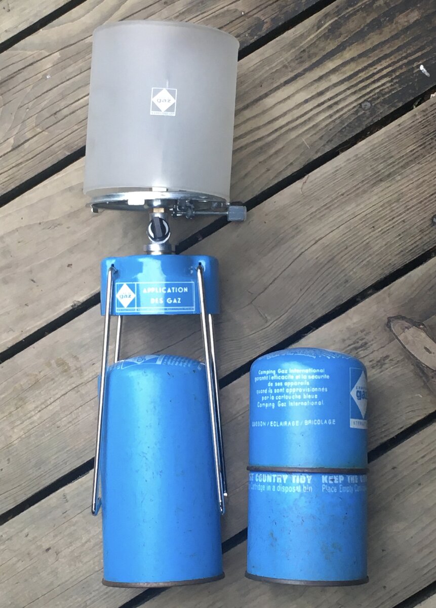

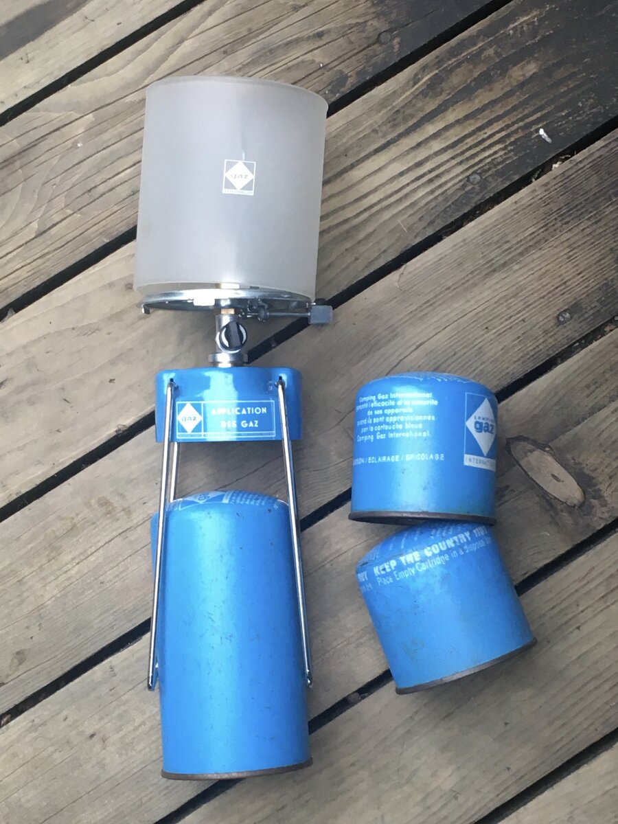

    Designed to take either a C400 or two C200 pierceable gas cartridges.

    It's most likely an Autobianchi Primula, manufactured from 1964 to 1970. Nice car!
    Nice lantern also, BTW!

    You’ve surely nailed it with the identification of the car Martin. Thank you.
    Interesting reading up about it, a front-wheel-drive layout by the parent company Fiat without endangering their brand were it to fail, which it evidently didn’t.

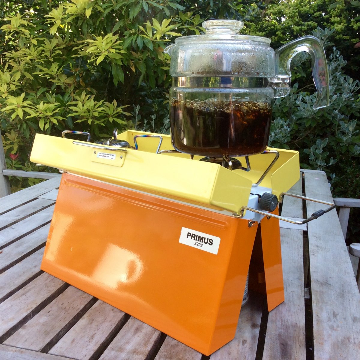

    It’ll combine well, sixties-style, with this Primus butane stove. Newark and Ashover, I’ll be cutting quite a dash!

    Also nice to see the rather unloved Primus 2222 in good hands and being used. I've got 1-2 of them around here but can't recall ever lighting it/them. We seem to have similar tastes when it comes to the weird stuff!!
