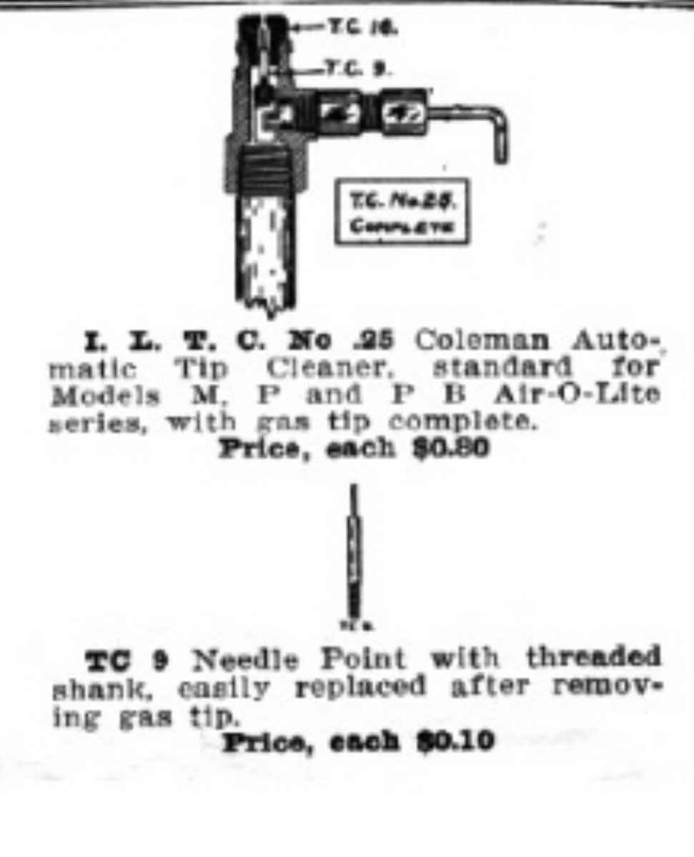

    Hi @Tony Press , no. 323 was the first Coleman torch lite generator lantern with a tip cleaner.
    So basically you would be restricting gas flow by partially extending needle.
    Larry

    Number 7 in the list of 14 shows Nulite describing the turn down ability with no. 18 torch lite generator also utilizing tip cleaner device.
