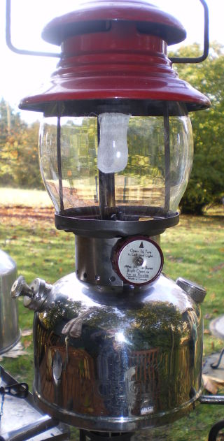

    I saw this non-functioning lantern in a junk store , it pumped, the tarnished fount held pressure, and I was smitten!
    The regulator was jammed solid.
    Using the guides in the Fettling Forum, I started with the regulator.
    After saturating it with penetrating oil (diesel + WD40 50/50) I was able to slacken the jam nut. The packing wasn't even damaged.
    I used Autosol and a soft cotton towel to hand polish it.
    There were still the washers under the frame assembly.
    I gave the frame assembly a good scrub, blew out the spiders and cobwebs in the airtubes decided that using the posted instructions, that I could assemble and test it!
    I still lack the period globe, "Coleman China" will have to do.
    It works well, I used it on Halloween, turning the tip cleaner to reduce the light output to a dim glow when at front doors, then turning it up while accompanying the children along the road to the neighbours.

    Ah, that's a fine 1950's Coleman model 200A - with proper maintenance, it will operate for a very long time. A very nice find.

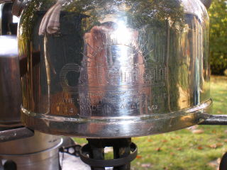

    On the side of the fount, below the Coleman logo, you will find numbers on either side. For example "5" on the left side and "51" on the right, will give you a date for your lantern as being May of 1951. Have a look and tell us what year your lantern is.

    By the way Chris, I tried to post the photo showing the manufacturing date stamps "4 & 52", but during the "image optimiser" process, it lost the defintion making it legible. But if one places the mouse pointer over the photo, then the photo name is shown at the bottom of the VISTA window,
    in my case:Coleman200NickelFont4_52_b.jpg.
    The "_b" was preferable to "_opt" extension added by the optimiser!

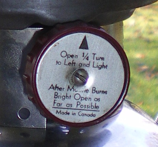

    Really like your lantern, I have two with the same date stamp. What I would like to know is does the direction disc wording say "mantle" (singular) or "Mantles" (plural). The old USA single mantle lanterns used the plural "mantles" up until the 1960's and I am wondering if the Canadian lanterns did this also.

    Here's a better picture of the regulator's direction disc (Coleman part name)
    (I had to look it up... I'm new to this.... ;-)
    1320795993-Canadian200Nickel4_52_Regulator.JPG !
    It quite clearly says "Mantle" singular.
    Hope this is helpful.
    Cheers,
    Thomas
    p.s. The $5 red 200 lantern I described in post #11319, is a U.S. 200A stamped "11_71", with no rust flakes rattling in the steel fount! T.L.

    Thanks! Sorry for the "curve ball". In the earlier days Coleman made only one disc for both single and double mantle lanterns, and the disc said "mantles" in the plural. American lanterns changed to the singular at some point in the late 1950's. Canada changed as well, but I am not sure when.
    At least I know both of my 4-52's are correct.
