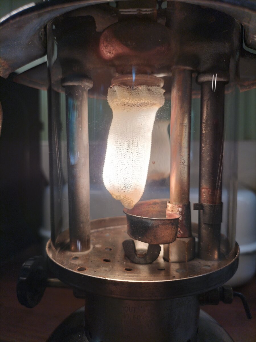

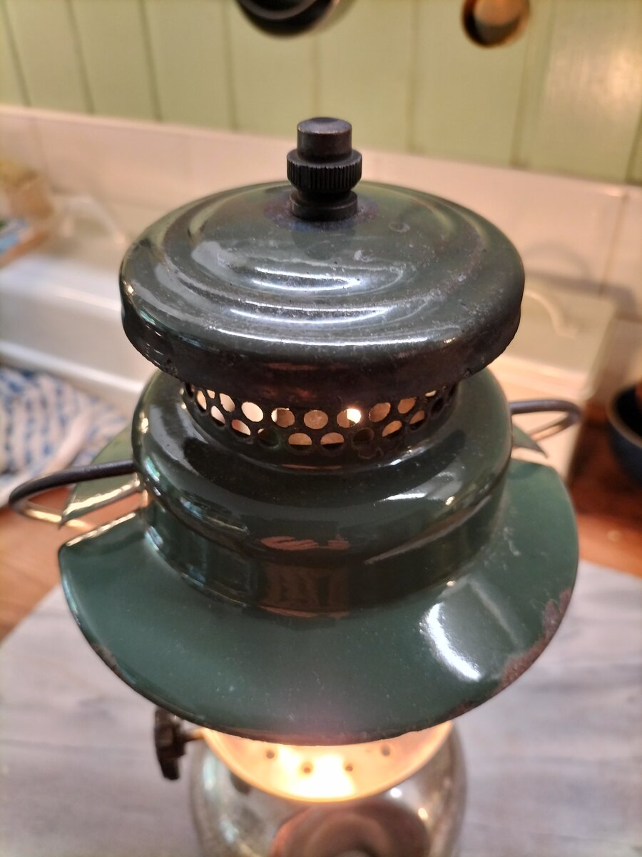

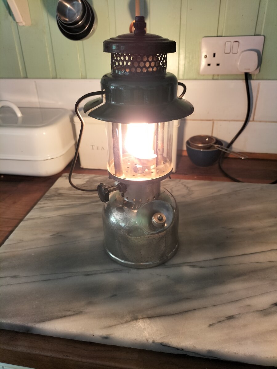

    This was gifted to me a short while ago by a site member but it needed a pre-heater cup which I made from a generic petromax style one which I adapted.
    Having checked out the tank and found a strange ball of fibrous material inside, I cleaned it with some solvent and ball bearings, shaken around vigorously! After that was done I added a Chinese pink-top mantle and away she went. It takes a few minutes to settle but once it's warmed up, its a great little runner! It came without a globe so I've added a straight sided Coleman copy for now.

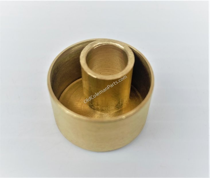

    [​IMG]

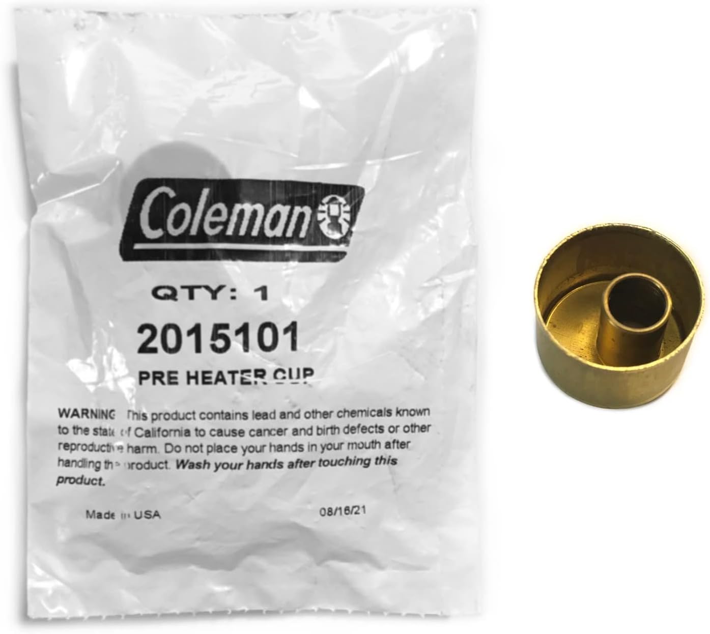

    MG , Coleman does make a standard replacement preheat cup , its widely available in the U.S.

    Yup, even the cup you listed don’t fit the 201, 247 or any other lantern or lamp that use the same generator tubing diameter, that cup fits more a 214 rather than 201.

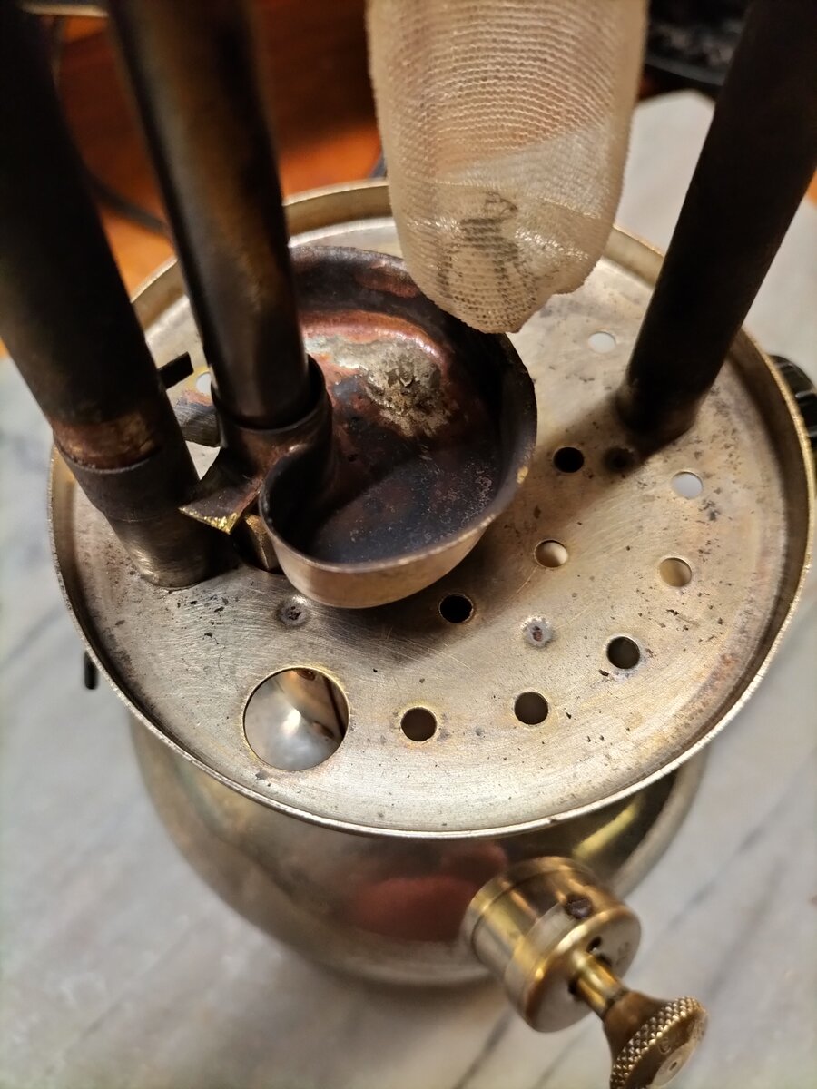

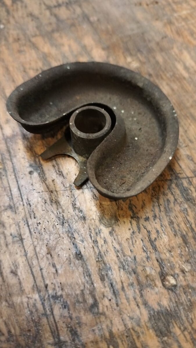

    I knew what the original looked like so I made something similar...
    When I first made it, it span round so I changed it today. I split the brass tube at the bottom and made two 'legs' to stop it moving side to side. It doesn't look very pretty but it works.

    1,156
    @ColinG
    This looks like original. Very good solution.

    I think we need to point out that with the exception of tne " 249 " or generator of the same diameter that the cup is compatible with:
    • Compatible with the following Coleman kerosene lanterns: Coleman 201-700 Kerosene Lantern, 201-7009 Kerosene Lantern, 234 Single Mantle Kerosene Lantern, 201-720 Kerosene Lantern, and 635B700 Lantern.

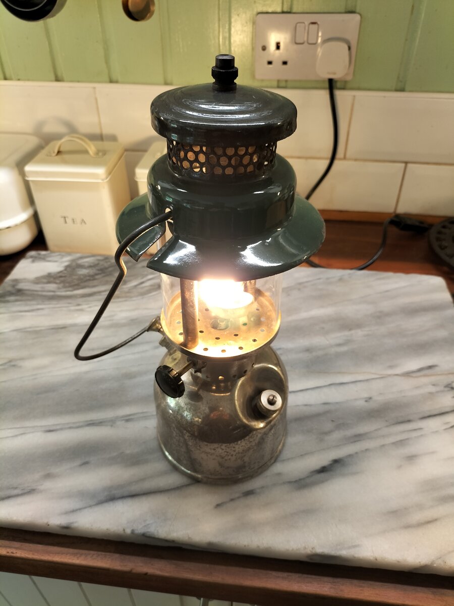

  19. MYN
    Nice adaptations and a pretty lantern, Colin.
    I once fettled a 249. Great runner and nice, well-built features.
    Wonder why they didn't make more of those.
    Your lantern might appear like its powered from the AC mains in this picture :mrgreen: :
