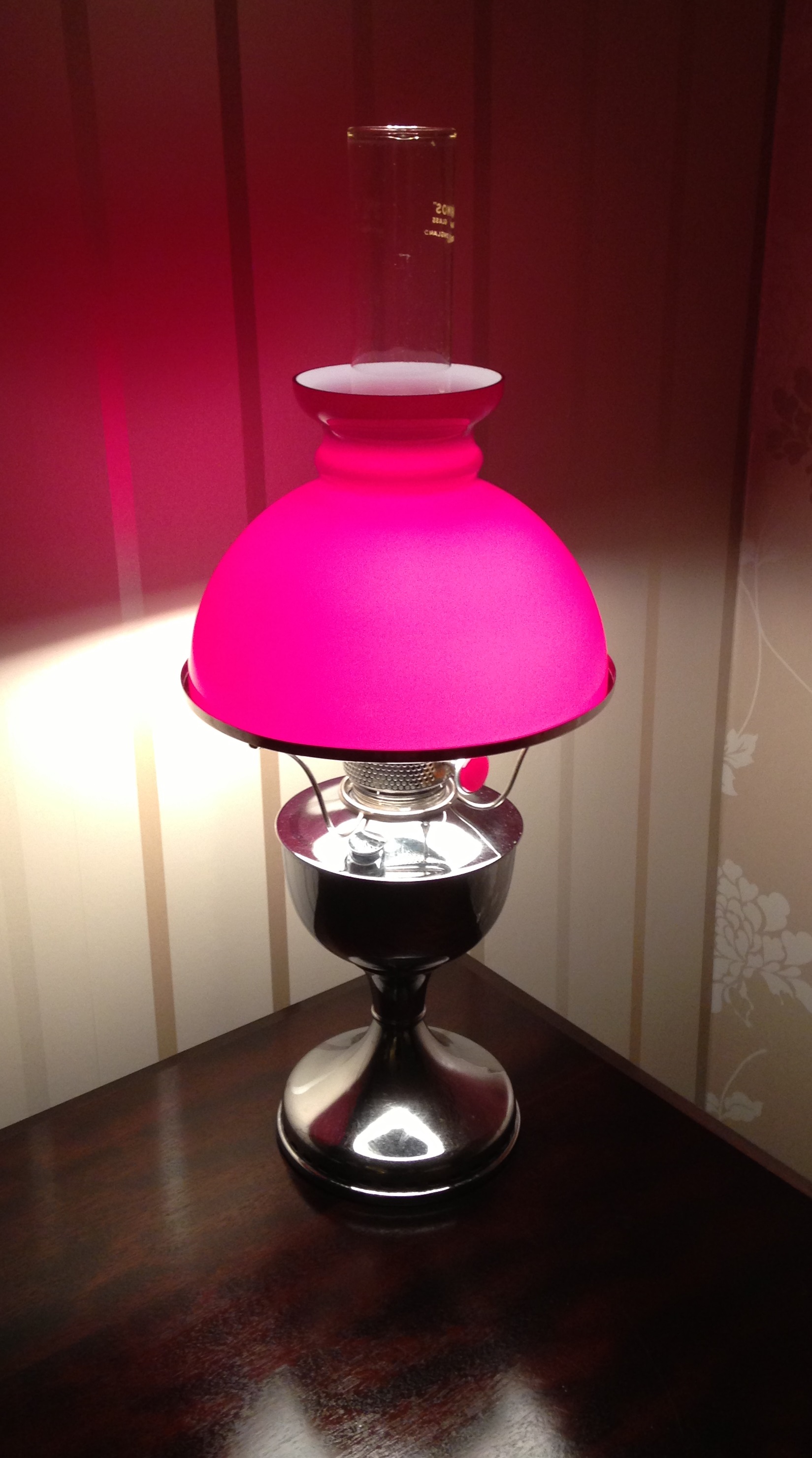

    I've not posted on this excellent Forum for a while now, but the recent acquisition and restoration of a pre-war Famos 120CP mantle lamp has caused me to look again at the light output from various pressure and non-pressure mantle lamps. And, again, I am having difficulty reconciling the figures.
    Armed with my trusty Avo Model 2 foot-candle light meter, held exactly 12" away from the light source and on the same horizontal level, and some working lamps, I have obtained the following readings of candle-power:
    Wax candle - 1 CP (so far, so good...)
    Famos wick lamp with Aladdin 60CP mantle - 60 CP (still so far, so good...)
    Tilley TL136, rated at 300CP - 125 CP (er...)
    Electric 100 watt tungsten light bulb - 125 CP
    So the Tilley, which is fully restored, fully pumped and as bright as any other "300CP" pressure lamp that I've ever seen, is only really emitting 125CP. This seems to confirm measurements reported by others, as well as anecdotal reports that it is impossible to get the rated output from a Tilley.
    I have seen comments that the manufacturers were able to back up their claimed light output with detailed measurements, but does anyone have access to this data?
    My experience is that light output from a pressure lamp depends largely on the mantle. I'm willing to believe that thoriated mantles would have given much more light output than today's offerings, but could a non-thoriated mantle account for a 50% drop?
    All suggestions and comments will be welcome! Kind regards,

    Hello Phil, the light output from a Tilley depends mainly on the condition of the vapouriser and the burner and the type of mantle.
    If the vapouriser and burner on a Tilley are the older types and they are unused and a thorium mantle is fitted, then the light output will be better.

    I'm not quite sure of the relevance of the last posting...! But I agree that the measurement of light output from a bulb or similar source can be confusing. However, the 'powers-that-be' have decreed that all light bulbs from now on are to be rated in lumens, so it makes sense to be able to convert readily between candlepower and lumens in order to compare our vintage lamps with present day units of measurement.
    I have come across the conversion factor 12.57 in several places, and this is based on the fact that one candlepower = 1/683 Watts per steradian, assuming the light source radiates equally in all directions and there being 12.57 steradians in a sphere. Hence 1 candlepower = 12.57 lumens. This ignores the fact that most vintage lamps do not distribute light equally in all directions.
    Returning to my earlier figures, the Tilley lamp produced 125 candlepower, equating to just under 1,600 lumens, almost exactly the same figure as a 100 Watt tungsten lamp.
    The link to the mantle experiments that dspearsy quoted was fascinating, and certainly explains the discrepancy between the manufacturers' claimed 300CP (with brand-new burner and thoriated mantle) and the figures around half that, which we seem to get in practice.
    Thanks for everyone's input - things are a little clearer now :clap:
