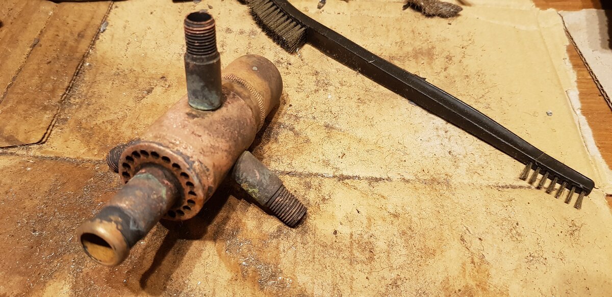

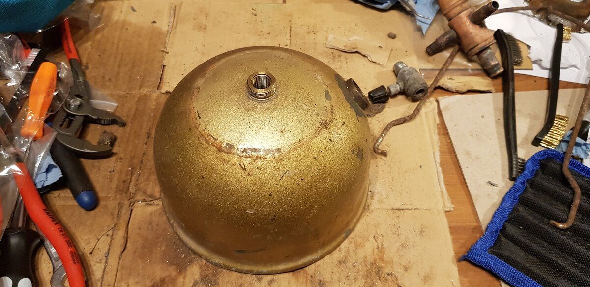

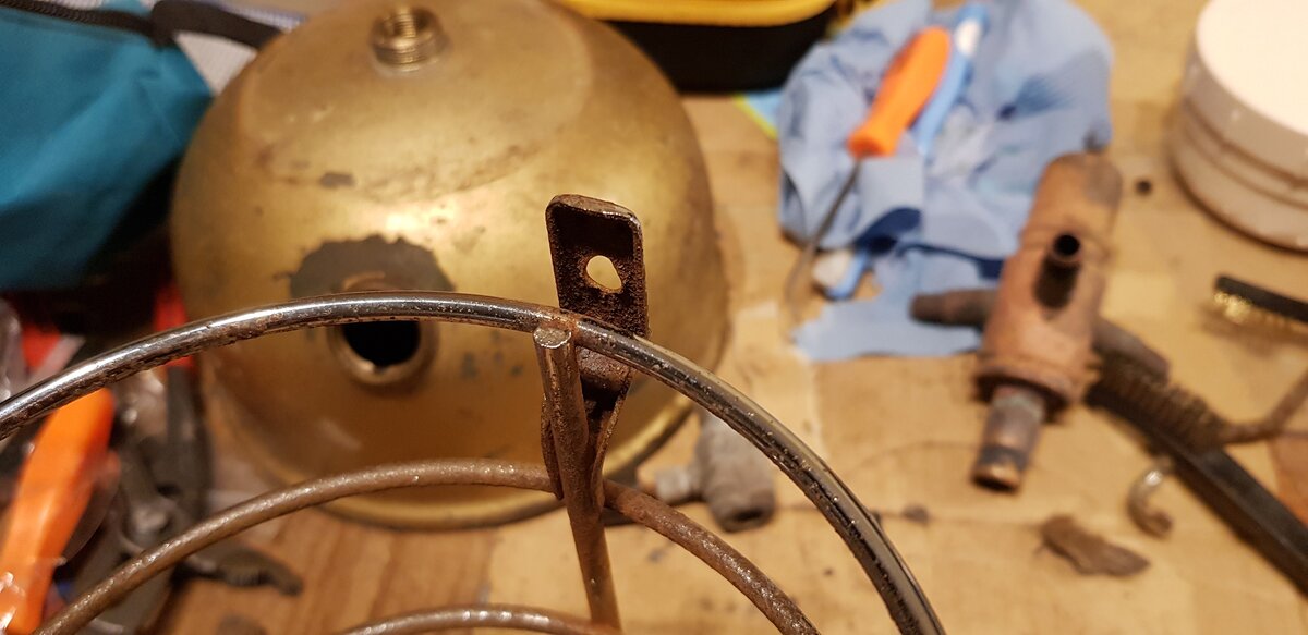

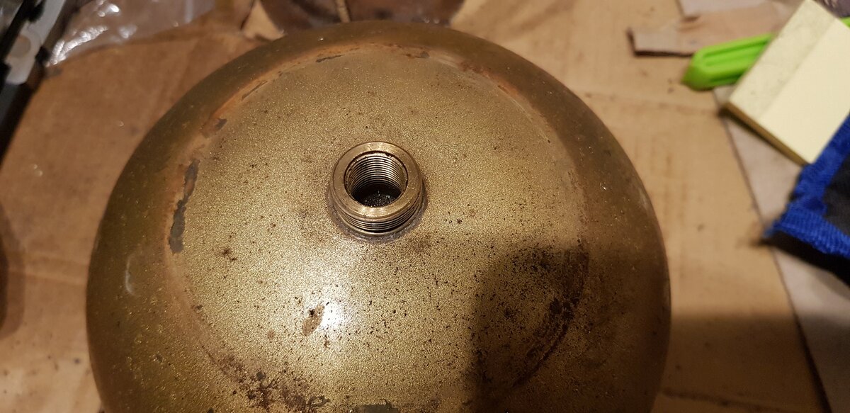

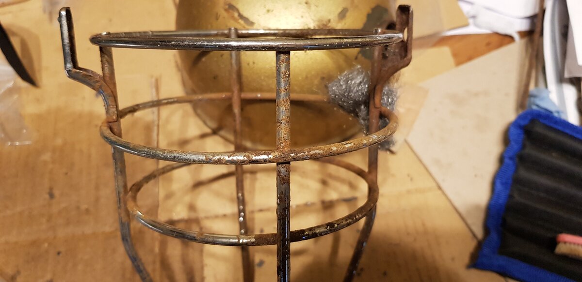

    Some progress: water pump pliers arrived and I was able to get the control cock and knurled ring off, and detach the cage. It looks not that bad to me - threads in the tank seem fine. Control cock appears to be slightly squished in places, though probably still usable. In any cause I am going to source another one. The cage is rusty but starting to clean up. Think I will dip it in neat vinegar with a little salt for 20 minutes or so.
    Have been using a wire brush and some grade 1 steel wool, on which I have already managed to cut myself. Maybe I should have got some grade 2. I have some grade 0000.
    So far I haven't touched the hood.

  11. JEFF JOHNSON
    16,883
    It's progressing!:thumbup::thumbup:
  12. Westfield
    Westfield United Kingdom Subscriber
    Oct 30, 2020
    76
    Pembrokeshire
    Bugger.
  13. podbros
    4,102
    Why? What's up? Are the air tubes loose? If you can feed a bit of 3-in-one in there you should be able to work back and forth and tighten 'em up:thumbup:
    You can't say it's neglected now, it's never had it so good ;)
    Wire wool splinters? All part of the course now..
  14. Westfield
    Oct 30, 2020
    76
    Pembrokeshire

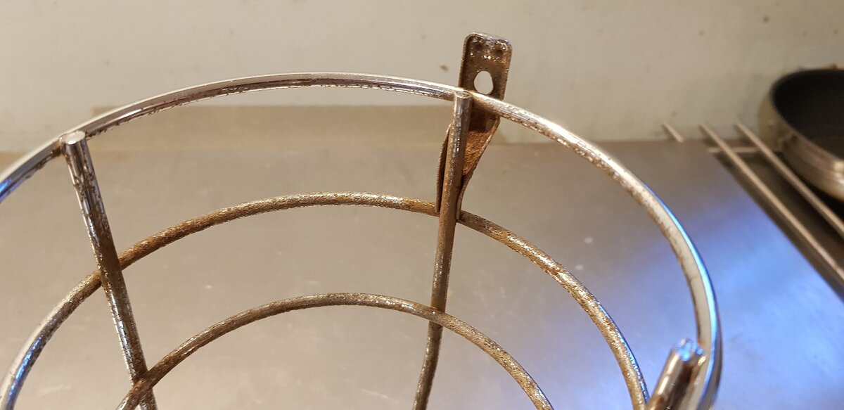

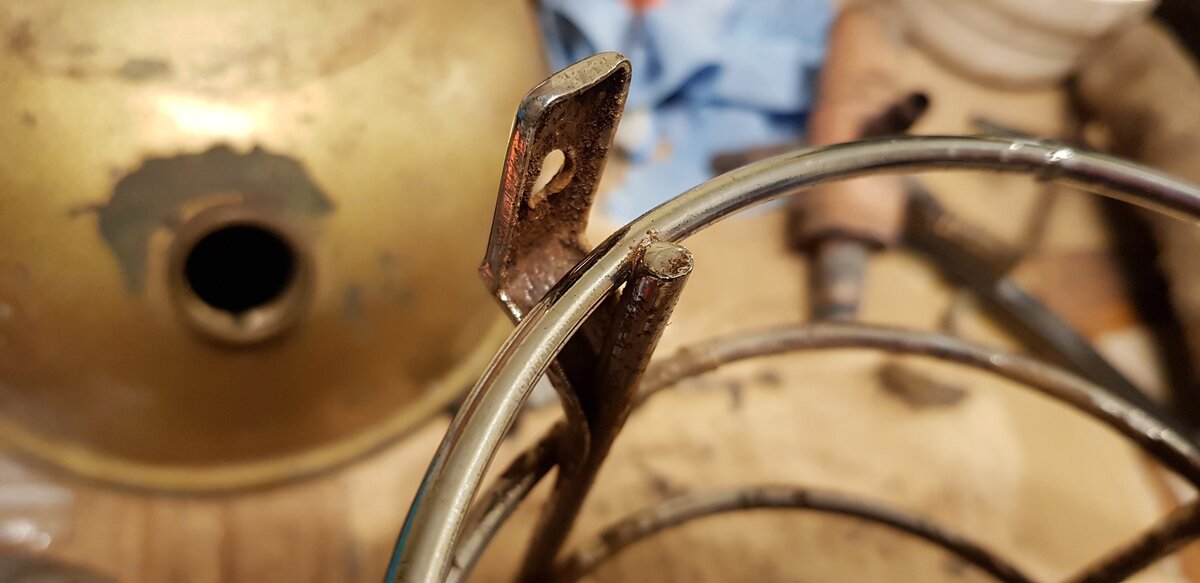

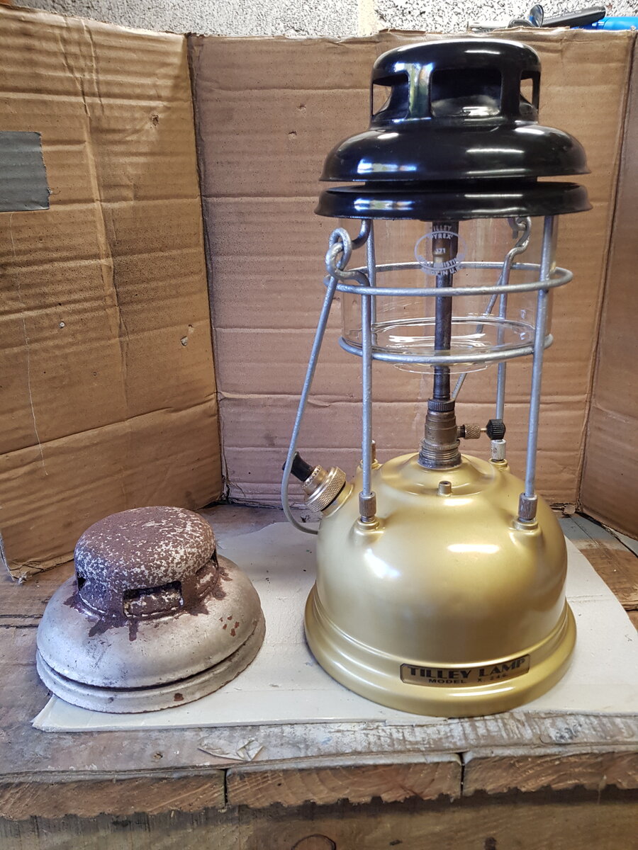

    No, @podbros, I just left it in the vinegar too long and the surface turned coppery - it was only in there for 30 minutes I think. That aside it seems OK, and after earlier warnings about the threads I have been careful not to fiddle with it.
    I have made some headway with the cage, and got quite a bit of the surface rust off it. Some parts are proving to be more resistant than others. The rust on the base looks almost baked on (smooth and hard) and I am in two minds as to whether I want to get it off or not. I have ordered some grade 3 wire wool to experiment with.
    Having looked at the tank with inexpert eyes, the structure seems fine and the paint is actually in fair condition. I quite like the patina and, as @MikeO says up-thread, it tells a story. So I think just a bit of cleaning (inside and out) but not sure how to go about the exterior. Would immersion in vinegar damage the paint? I don't want to do too much until I have conducted a pressure test.
    Then there's the hood. After reading this thread I'm tempted to drop it in neat vinegar for a couple of weeks.
    20201112_064550-50%.jpg 20201112_064610-50%.jpg 20201112_064631-50%.jpg 20201112_064649-50%.jpg 20201112_065331-50%.jpg 20201112_065321-50%.jpg
  15. Tony Press
    @Westfield
    Don’t worry about the burner looking copper. If you don’t like it, polish it, but it will turn black with use.
  16. podbros
    4,102
    You've made great progress there!
    I wouldn't put vinegar on the tank, just give it a bit of a clean or buff or polish if you want to?
    The frame has lost a lot of the chrome but you could always neutralise the rust (Kurust) then paint silver?
    just depends how much Patina you want ;)
    When it's this far gone it is always a labour of love.. This lantern has history and family connections for you.
    it's a good feeling when you see it light for the first time, even if it takes more 'fettling' to get it working how you feel good with?
    You'll get there :thumbup:
  17. Fireexit1 United Kingdom
    3,536
    I would be tempted to drop the whole frame in a bucket of water with citric acid (available in powder form from many places) and wait. It will remove the rust, but won't damage what chrome is left. You will always get the rust re-forming but as it will be kept in the warm and dry it won't ever be that bad again. The tank I would leave as it is. If you strip and polish or re-paint it it will be too good in comparison to the rest of the lamp. The surface copper on the burner won't stop it working and after it has been running for a bit won't be visible anymore. Don't leave the hood in citric acid for very long as it does affect the enamel.

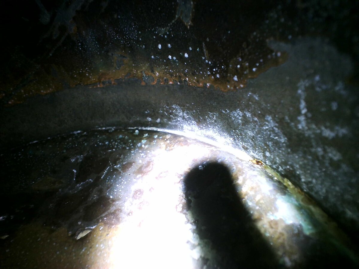

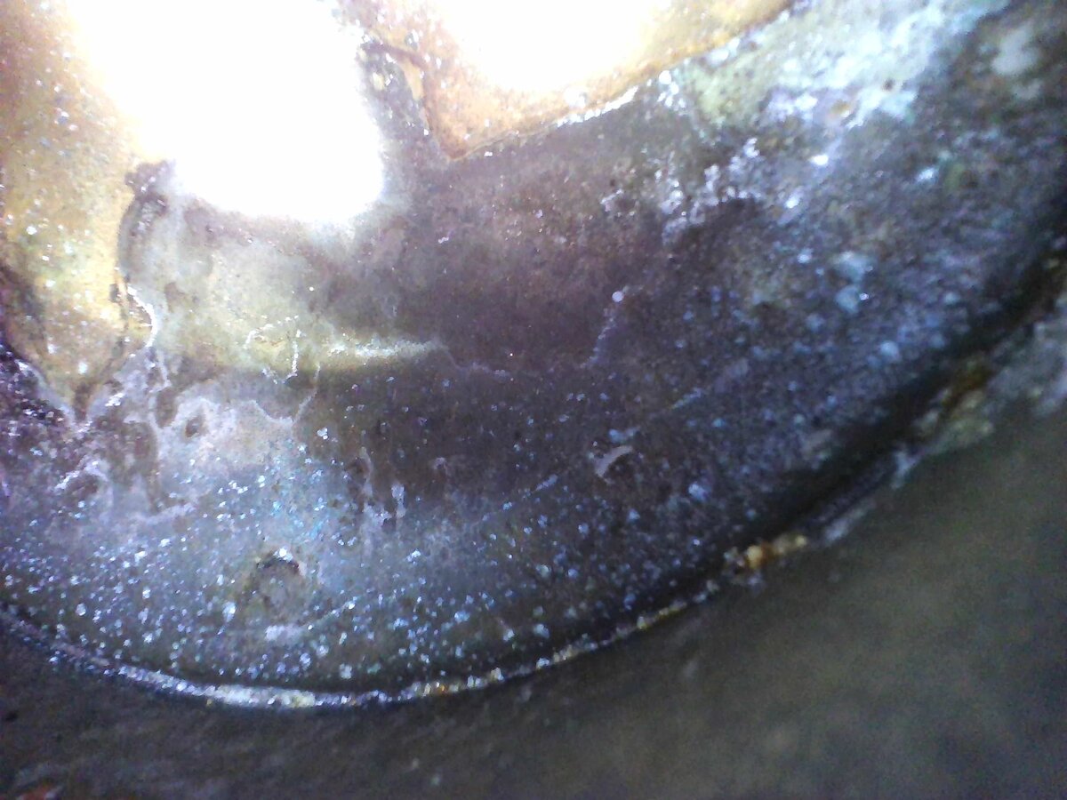

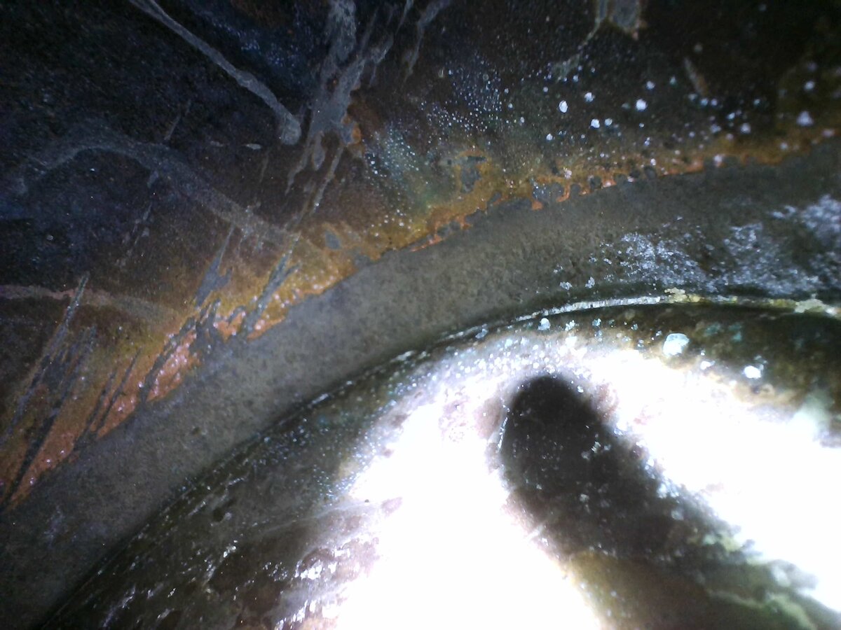

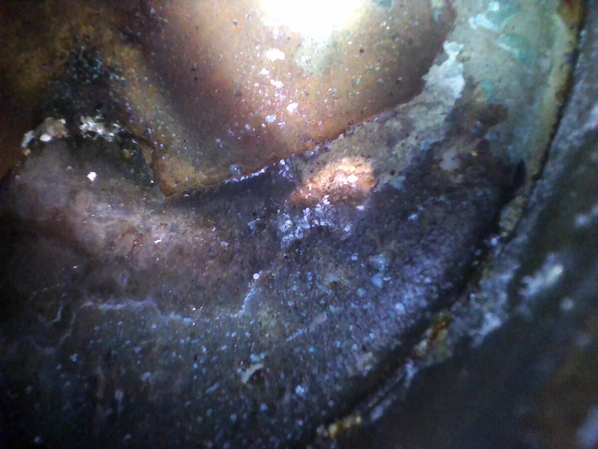

    Just for fun, I decided to take a look inside the tank using an endoscope I bought a while back on Amazon. It worked fairly well, but getting enough light in there to illuminate the scene was a problem. Eventually I shone a strong light from a smallish torch in at the pump hole and it helped. There were also issues with focus and so on. The tank seems to be in reasonably good condition inside, but I have nothing to which I can compare it. So here we go...
    Central boss.
    Right below fuel filler hole.
    Moving to left.
    Fuel pipe coming into sight, along with what looks like hard deposit (in black).
    Slightly clearer shot.
    Moving round to the right, and more of the black stuff. Interesting pinky orange colours on the walls.
    Looking at the bottom seam on the right-hand side of the tank.
    And to the right of the filler hole.
    And back round to where we started.
  19. MikeO
    Jan 14, 2014
    247
    I feel like I'm exploring the wreck of the Titanic! Great pics!
    If you want to get a lot of the fuel residue and varnish out, use a lye solution (Sodium hydroxide and water). This is pH 12-13ish so a strong base--use safety glasses, rubber gloves, apron etc. and always add the NaOH to the water. It can release fumes and lots of heat from the exothermic reaction, but I've found nothing better for getting that gunk out of a fount. I find lye crystals in the plumbing section of my local hardware (Privy Sanitizer!).
    For the fount paint, I usually give it a wash with a spray cleaner to get the worst of the dirt off, and then use any of the auto finish restorers that remove surface oxidation. Some car wax after that and you'll be amazed at how nice the paint is--clean, bright, but still showing some age and use.
    Great project!
    Mike.

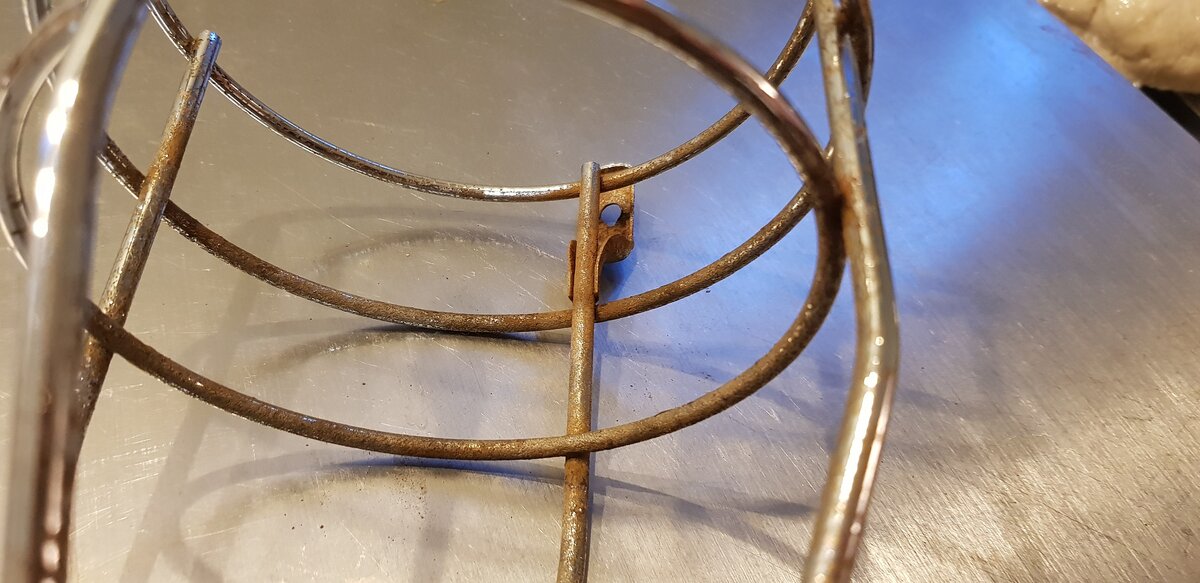

  26. Westfield
    Oct 30, 2020
    76
    Pembrokeshire

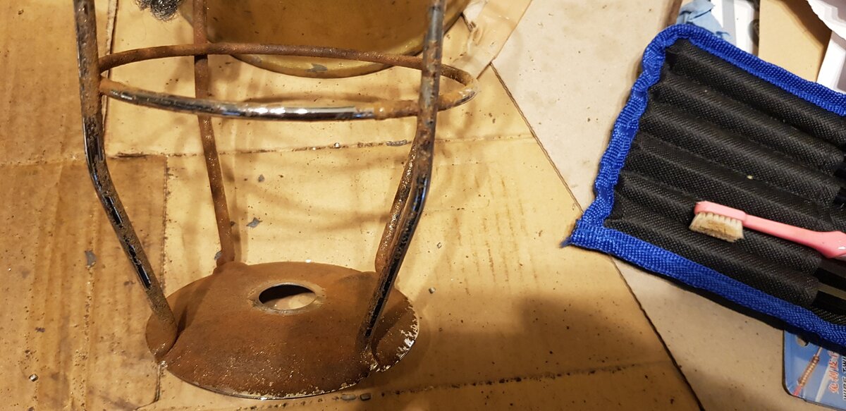

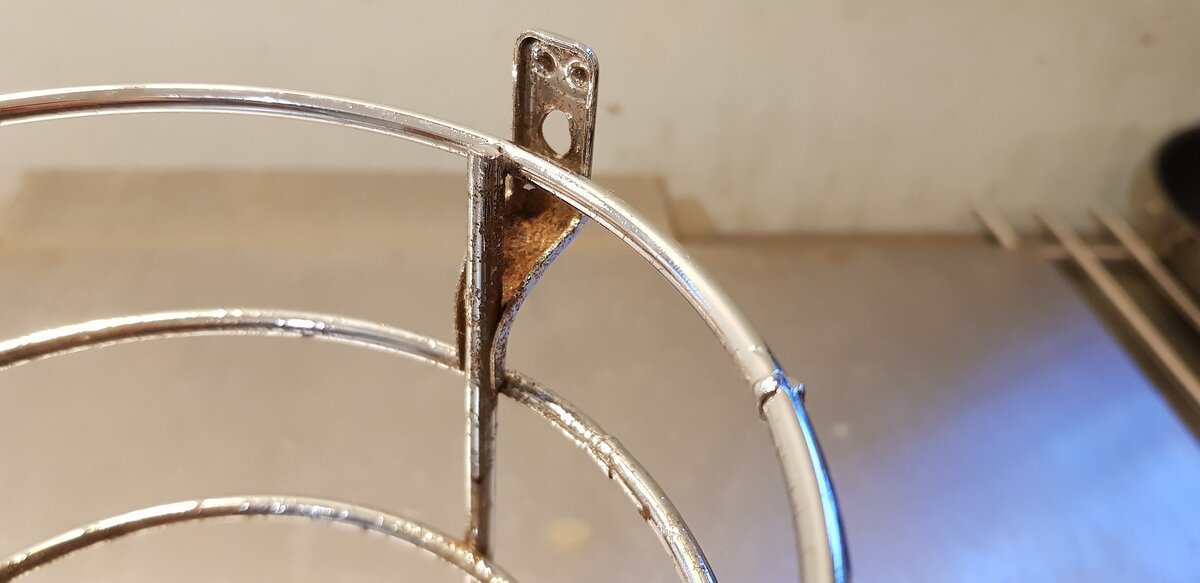

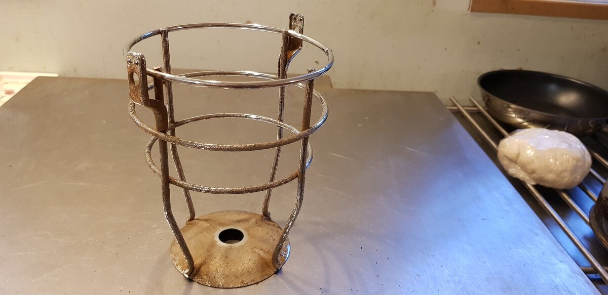

    Cage left overnight in a bath of citric acid, about 1 cup to a three-quarters full bucket of, what, 10 litres / 2 gallons? Maybe not quite that much. The bath got a lot of rust off with a bit of a scrub, but getting it out of the nooks and crannies is proving difficult. The chrome is quite badly eroded in some places, but in others it's still good (top rail for example). The bail needs a bit more work.
    Just a reminder of how it looked a week ago.
  27. Westfield
    Oct 30, 2020
    76
    Pembrokeshire
    A question for those more knowledgeable than myself (i.e. any other member).
    Given that the surface of this base hasn't shown any improvement from a wash in warm soapy water, should I just put it in a bucket of citric acid as I did with the other parts?
  28. rayw United Kingdom
    Sep 13, 2020
    457
    I am not sure about the Citric acid, but I recently revived an old family friend using Screw Fix paint stripper then plastikote spray followed by Plastikote satin finish lacquer
  29. podbros
    4,102
    The cage looks great! There may be a lacquer you can use to prevent more rust? Others here will know more..
    @Fireexit1 was right about soaking in citric acid so I would follow his advice about leaving it as it is.. perhaps some 'T-cut' or ammonia free polish first to see what it looks like?
    If you lose the paint you will radically alter the look of your lantern.. Is that what you really want to do?
    p.s. Wow! @rayw that is a great finish :thumbup:
  30. Westfield
    Oct 30, 2020
    76
    Pembrokeshire
    No, I don't plan (at this point) to strip and repaint, but I thought a gentle soak in citric would remove the surface film of oil and grease without really affecting the paint much. I'd like to brighten it up a little, but I don't have any other cleaning products to hand. Actually I think I have some Windowlene. And some screen wash for the car. :)
