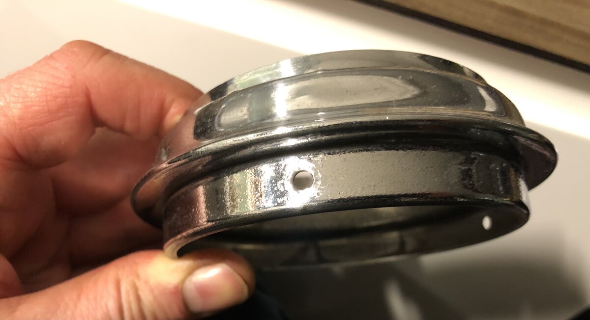

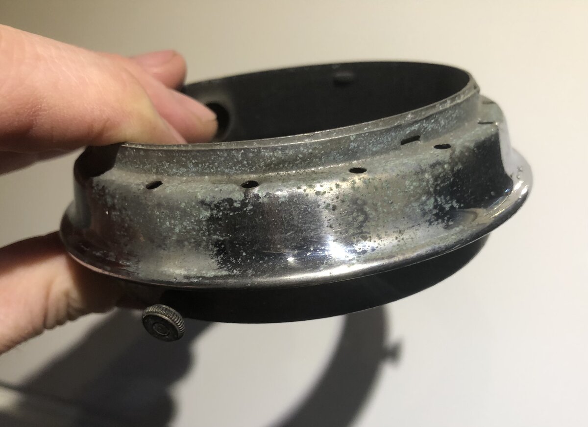

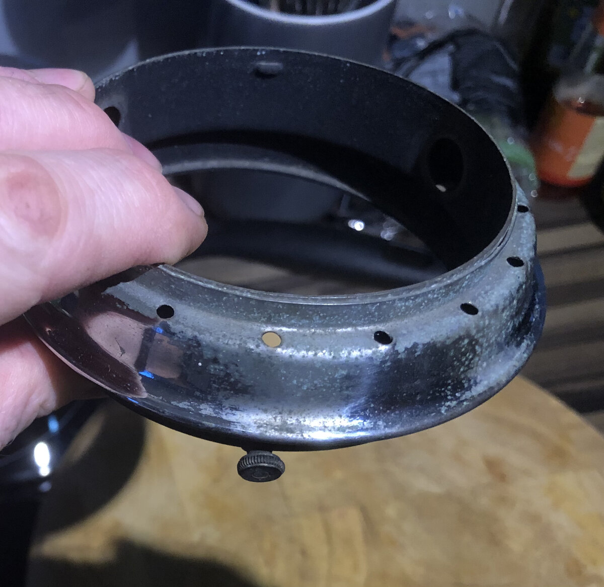

    I began using this the other day on a Speculum TL10 that was in poor condition with green spots of verdigris starting to form and found it to be pretty good.
    I had already spent a good while using Autosol, which is also good but I was concerned that all the polishing was also removing the worn Speculum too!
    Here are some terrible pictures.. before and after 1 quick application

    75FF001C-1A24-4BF7-B367-12C90892AA44.jpeg 41D9BE84-C289-4F53-B6DC-6D305E0731D4.jpeg C5E659A7-B895-41B4-B3CA-D548C46255E8.jpeg 8481D0DB-0955-4798-BC3B-49BB13E2C71E.jpeg 2DABD955-FEF0-4663-937A-59AE35396F73.jpeg Here is the product and the instructions which are worth reading if you have high finish Stainless Steel or Enamel or High Gloss finishes
    I used a damp J cloth and put the powder in a used food container, dabbing the cloth into the powder, then applying to the lamp and gently rubbing.. then wipe off with a damp sponge and then a clean rag or cloth

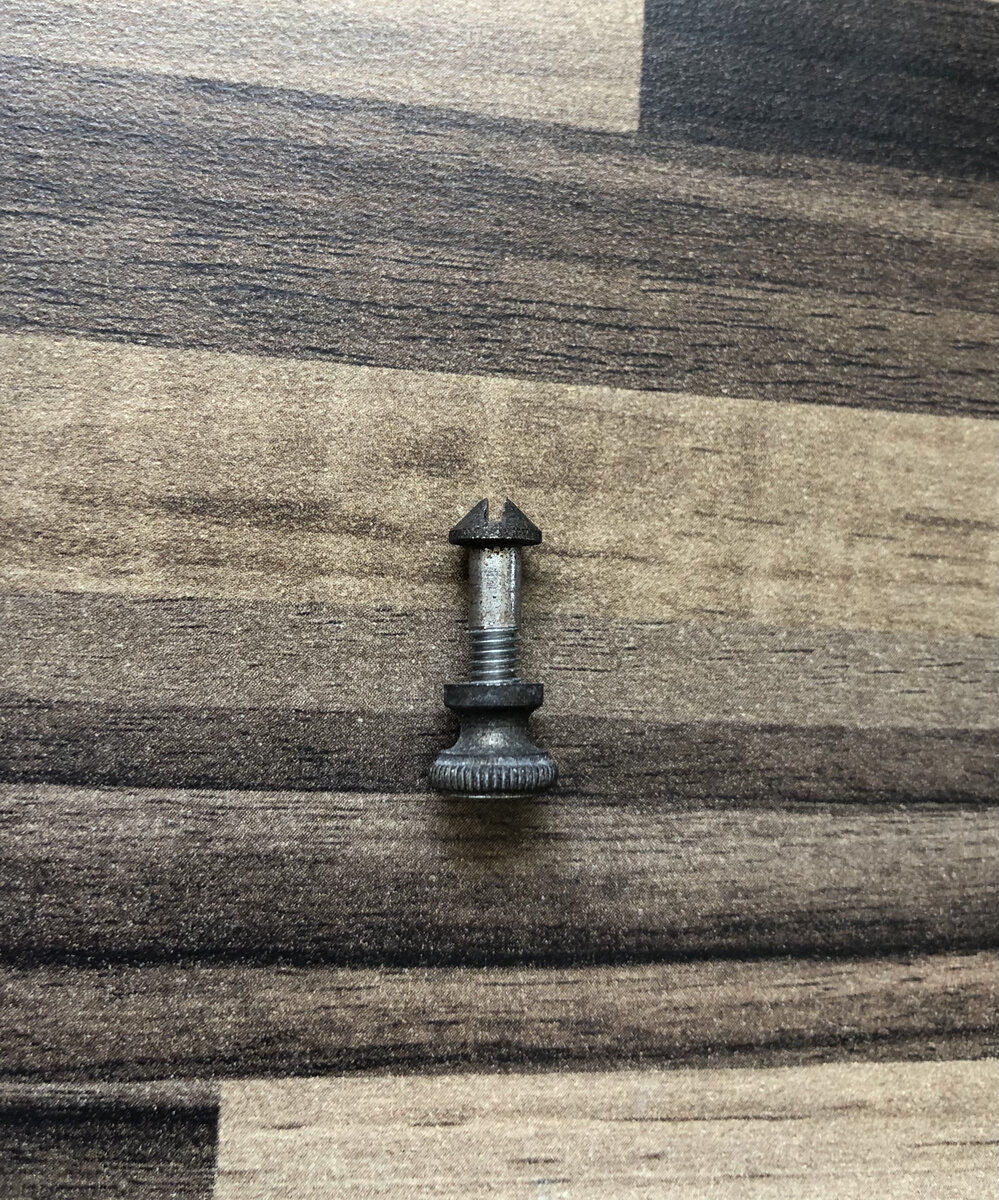

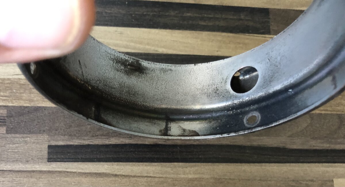

    Made slow progress but managed to get the glass-retaining spigots/screws things out to enable access to clean.
    DE55B299-5026-435D-8671-70914EB9D50C.jpeg 6A95F343-BA2B-45B4-B19F-64E57F687956.jpeg 3529CC90-9968-4A37-A268-3237674F17E1.jpeg
    Not easy as they were tight and didn’t want to damage the delicate knurling.. so was able to utilise some soft jaws on a pair of pliers
    You can make out some plating on the spigot/screw.. there is some left on the knurled nuts but they are caked so not sure how much will be left
