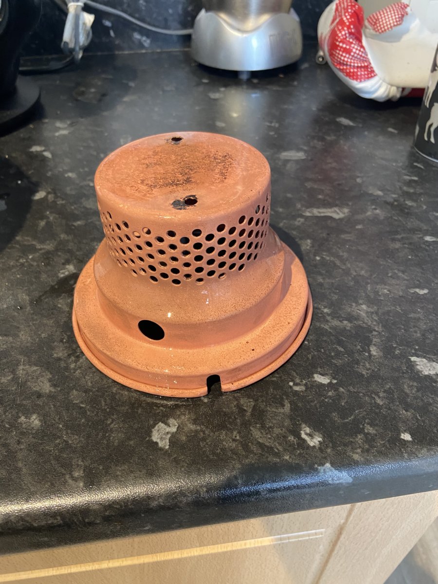

    Having been it home now for a good month, I’ve sorted the garden & most of the jobs my other half had for me. So I’ve started to look at a bit of fettling. In my collection I’ve a few chrome tilley’s, an Anchor clone and a veritas superb, all of which are looking a bit tired, so my question is what do you all use to clean and polish these founts without removing the chrome?

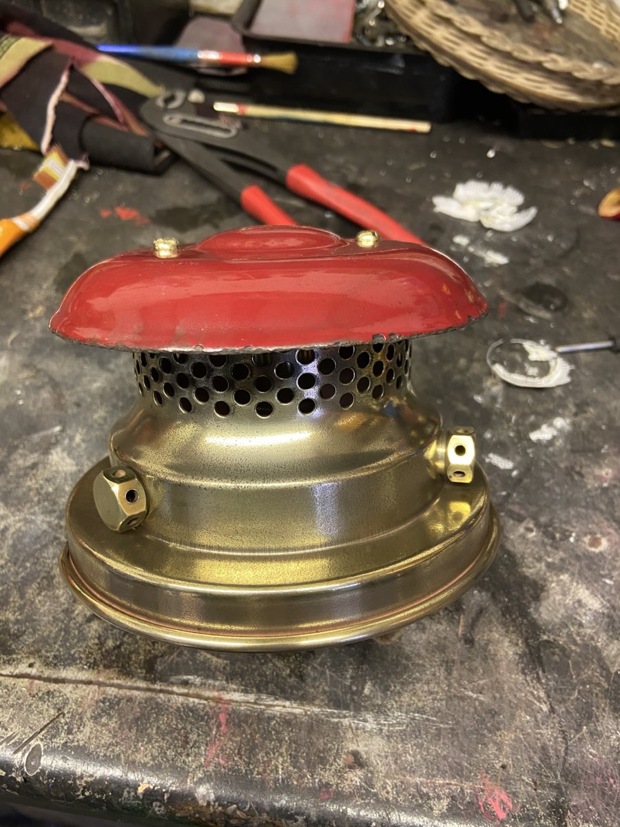

  8. Krisse
    Dec 20, 2019
    100
    Sweden

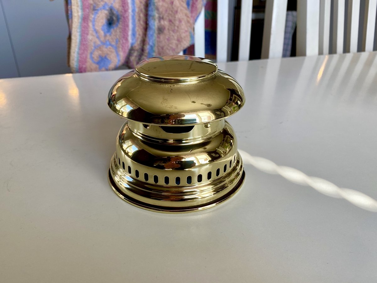

    Buffer is excellent if used properly! I polished this hat yesterday, but brass is a bit more forgiving than plating.
    Always starts with Ketchup, it's my secret to get rid of soot and oxidation before polishing :)
    C1AE5CBB-DC54-427E-8F57-2119346AF0EF.jpeg ED8D5892-752D-49EE-B4D3-559B8D16A197.jpeg 0BA24702-C3CA-49B4-A659-E21DD1338820.jpeg
  9. malcolm race
    Sep 24, 2018
    277
    Bradford uk
    Ketchup, I’ll try that, I’ve used vinegar on brass and that works so I guess ketchup has it in anyway and will stay put a while too to do it’s work.
    Nice job though Krisse

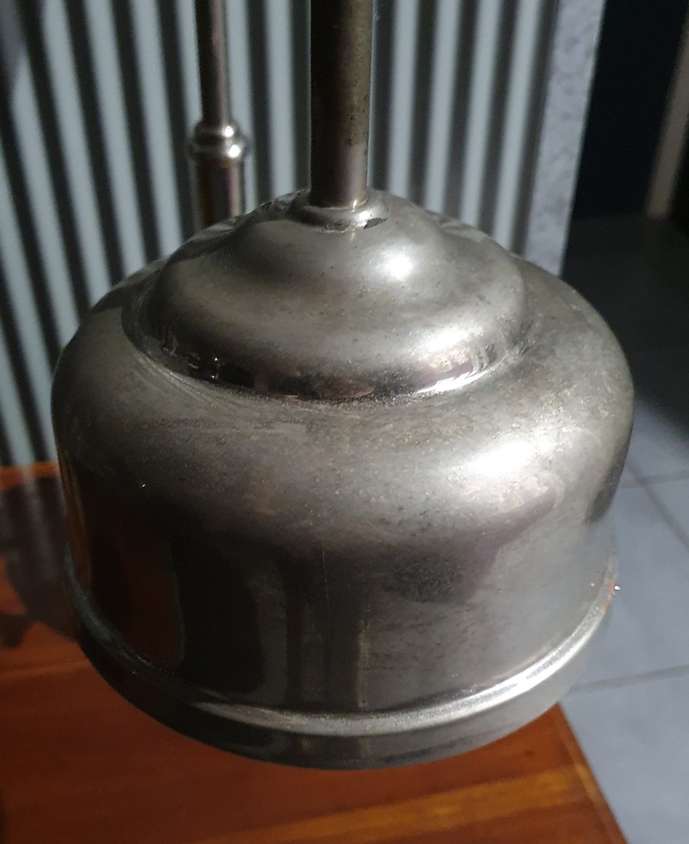

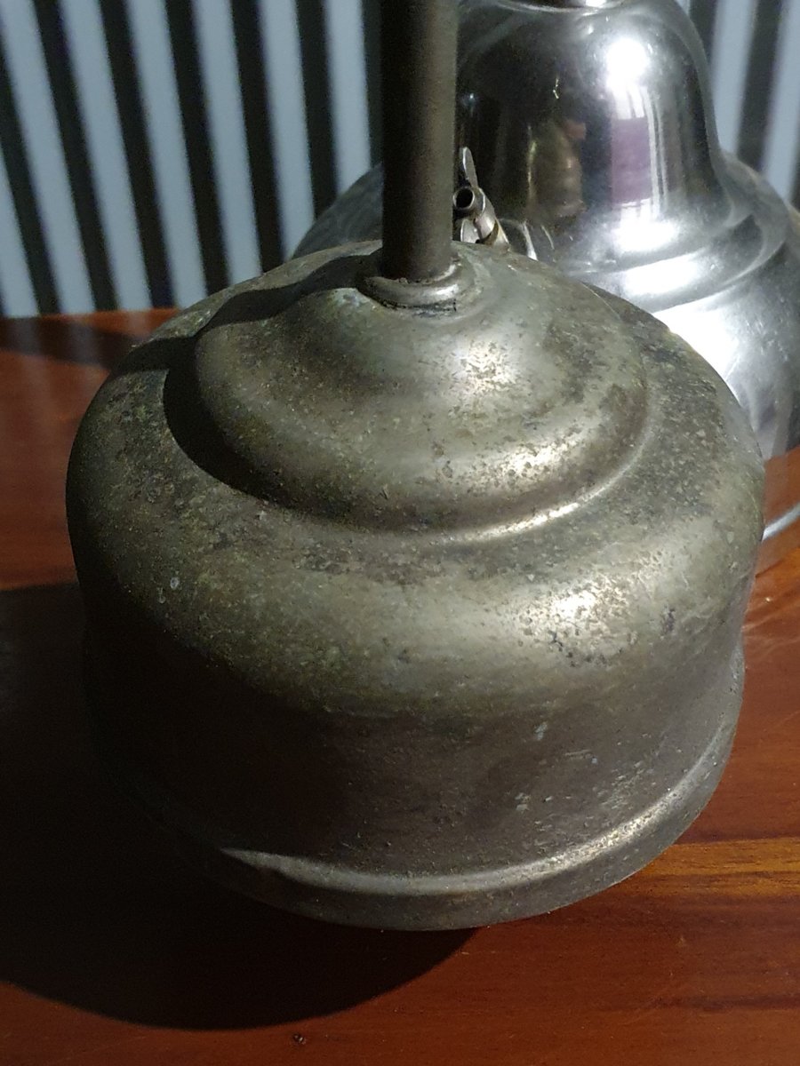

    Here is a Nulite fount I did today. Founts do not come with a tougher grime coating on them. The photos are taken indoors at night. Please don't think the reflections on the tank are brass. It is reflecting from the table surface. The fount looks better in real life.
    Well, I did it tonight actually after spending all day - again - further rearranging stuff in my garage. I looked up and saw the lamp hanging there and the fact it had a 100 year old crusted on dirt barrier made me want to show the power of vinegar.
    I placed the fount in the vinegar. I use a vinegar bottle I have emptied, fill it with water and use it as a weight to keep the fount submerged. I took note of the time and 20 minutes later I took the fount out of the vinegar, went to the garage sink and under running water used a nylon brush to move and rinse away the grime.
    Just for good measure, I ran a very quick, light rub with Mothers Mag polish and here are the results. I did want to say that I tried the Mothers Mag polish on a part of the stem that had not been in the vinegar. The polish could not remove the grime, not even close to removing it, I may as well not have done it.
    30 minutes after I first put this fount in the vinegar - including the Mag polish, you have these results. No rocket science, not many brain cells used at all. If you leave a plated surface in vinegar over night, you are going to have problems, especially if the plating is thin. Leaving the fount in vinegar for 20 minutes with a starting surface that I had, it would have taken the vinegar 15 minutes to get to the plating.
    I've thrown badly rusted steel parts in vinegar and left it for 4 or 5 days sometimes. I simply use a brass wire brush under running water and bob is most definitely your uncle.
    Really dirty brass burners, I've left for a couple of days and just brushed off. Yeah, the copper will leach a bit but a brush or polish removes that.
    If you have tarnish on any plated surface or plain brass 15 to 20 minute soak, a rinse and you are ready to start polishing. It makes polishing brass so much easier, perhaps by a factor of 3.

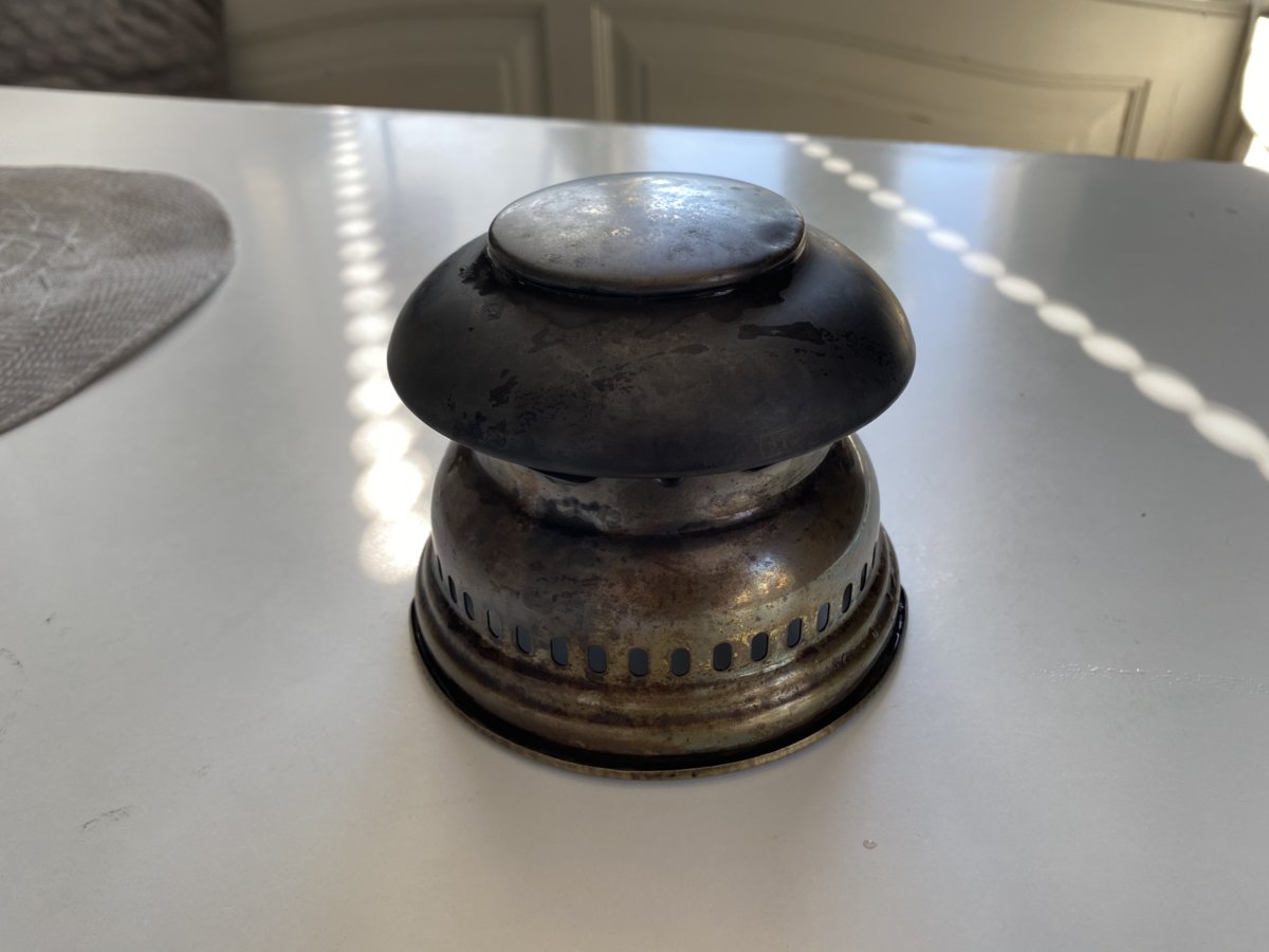

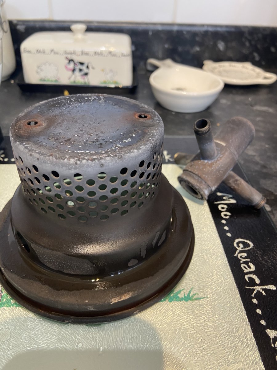

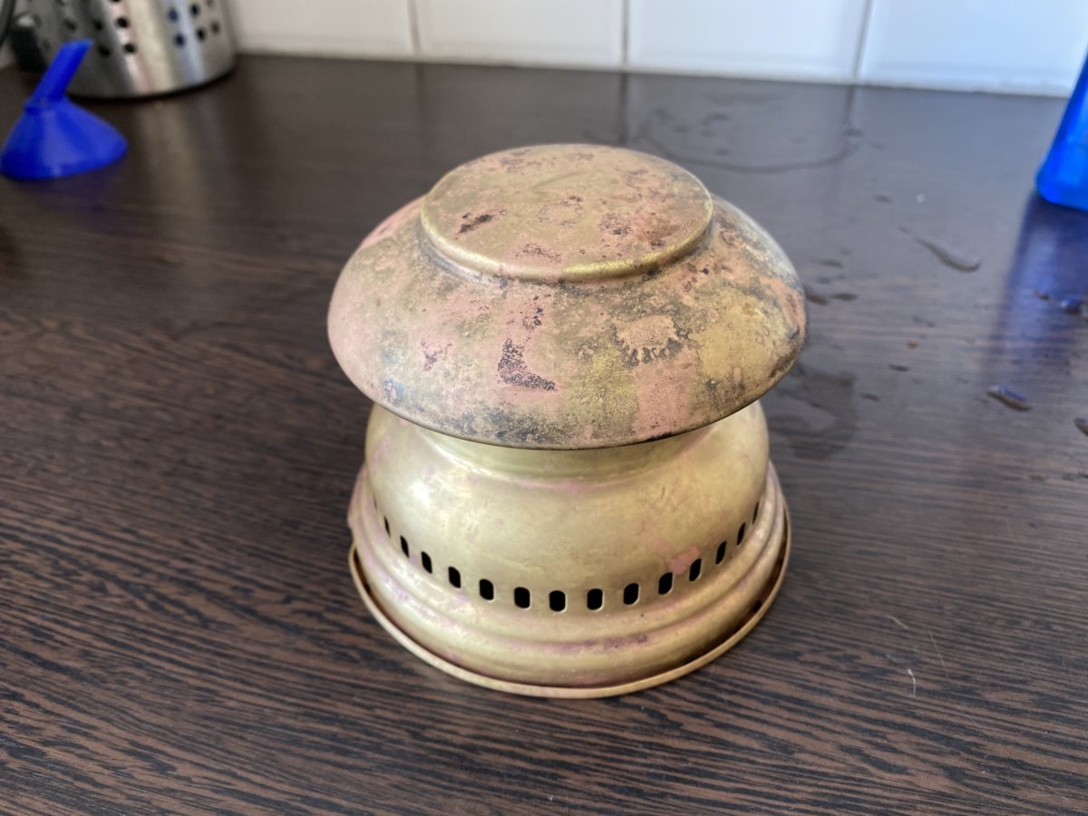

    I have recently been using citric acid, 50g per 500ml of warm water. You still need to buff it after but it quickly removes the black crud from brass burners.
    65DC9640-4035-4045-8277-C55BA65722E7.jpeg 606CE891-93C2-4138-B4E9-AEAC106AC6EE.jpeg 3FC8A43D-BF1A-4EAE-9488-E29EE78F071D.jpeg 9907E4EA-6AD6-4487-8942-22A6CA6DBBE8.jpeg
  19. MYN
    Vinegar is actually one of best and safest liquid to be used for the removal of rust, tarnish and oxidation on a parts which are old and those that you can't afford to ruin.
    Its safe, natural and consumable too. Unlike what's usual with strong mineral acids(hydrochloric, sulphuric, etc), you don't need to worry about flash rust when cleaning with vinegar. A somewhat passivated surface on steel/iron is formed instead.
    Citric acid is similar, perhaps a little stronger. Its usually somewhat more expensive(depending on which source you're buying from). As with vinegar, its quite safe on most items. It removes rust down to bare metal and doesn't attack steel to any appreciable degree.
