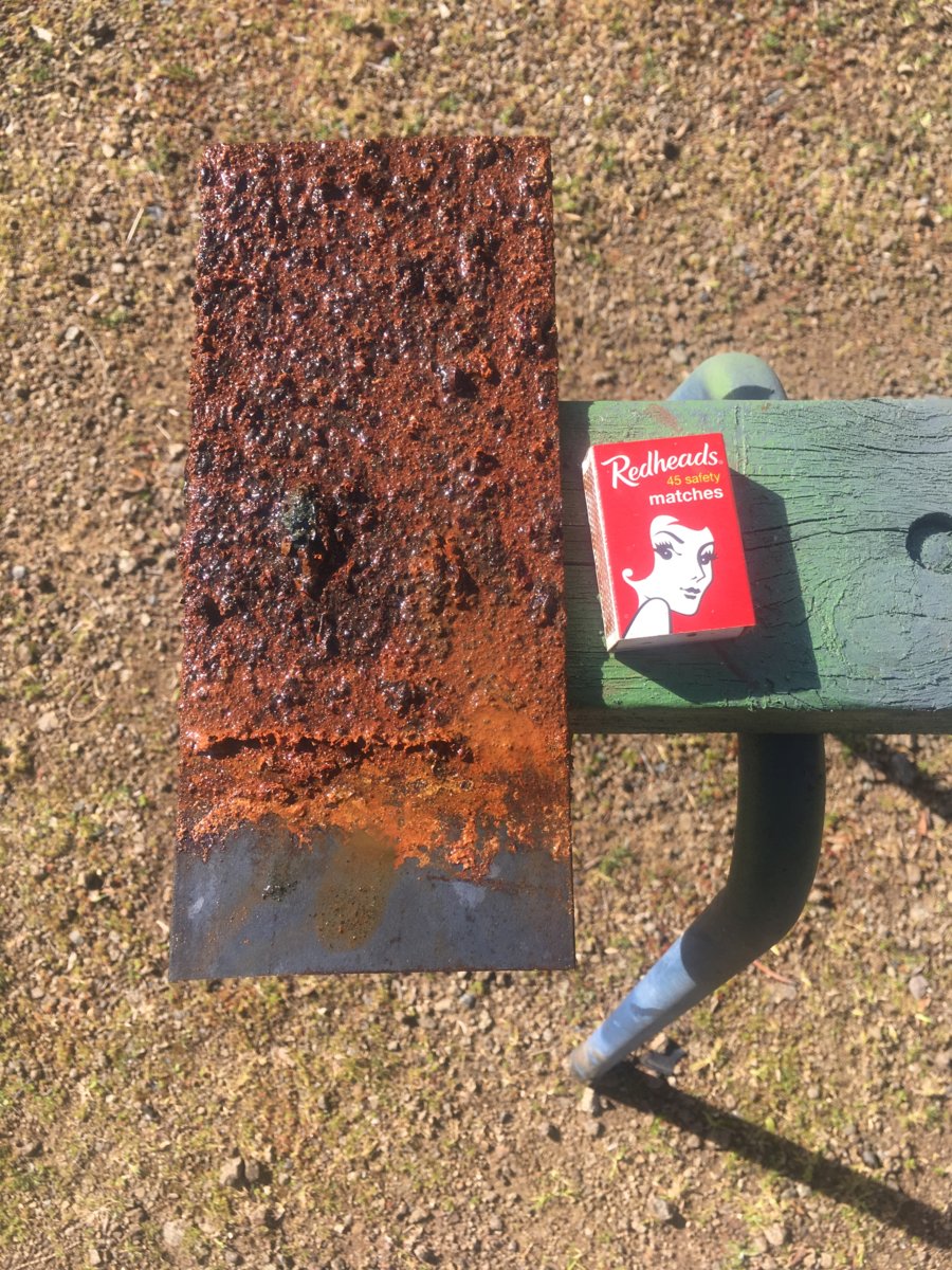

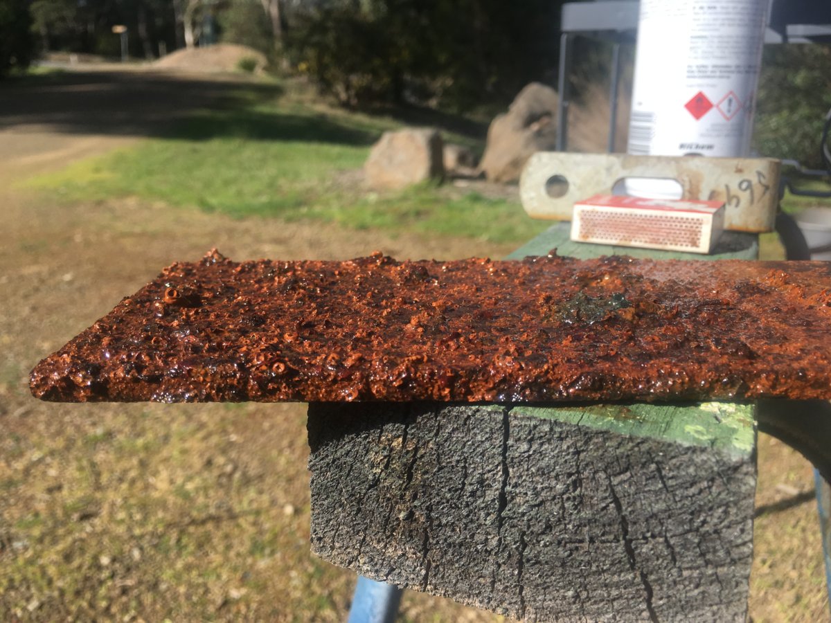

  8. Tony Press
    Electrolysis.
    By way of example:
    Here is one of two anodes from the electrolysis of two Companion trivets (the other anode looked the same):

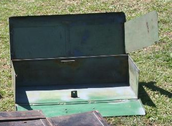

    I've been weighing up the pro's and con's of what I do v's what some of you blokes do - electrolysis. I am only thinking what works best for me. I am not suggesting anyone shouldn't do the same.
    I have been working on a Basford suitcase stove. The case has lost all of it's original finish and has surface rust all over it. It will need to be completely de-rusted and re-painted.
    I considered why not use this case as a electrolysis process try out. I'd have to find a non conducting vessel big enough to hold the suitcase, I'd then have to find a large enough sacrificial piece of metal. I'd then have to find a place to set it up. I'd have to build the electrolysis unit so it worked as it should.
    After the electrolysis has done its job, I'd have to scrub the suitcase to get rid of the black junk that is left behind after the process. I am then left with a suitcase that requires immediate attention as it will just start to rust again,
    I then thought about using vinegar and what I need to do. Drop the suitcase in and come back to it the next day and rub it down with a nylon brush under running water from the hose. Vinegar seems to kill rust, depending on how long the object has been immersed in vinegar, so there is less urgency needed to spray the suitcase for protection.
    I'm going to stick with vinegar. Still, one day I may set up an electrolysis station just to see how it performs. Boy, oh boy, I have some fettling to get through before that happens.

    I soaked the Basford overnight in vinegar and first thing this morning I gave it a scrub with a stiff nylon brush. I put it back in the vinegar went and mowed the lawns and a few other things and some 4 hours later I repeated the nylon brush treatment and washed it down with a hose. It came out terrific,
    In the Cleaning, polishing and preserving topic, some may have noticed I am showing mainly stoves. There is a very good reason. I am trying to get a number of stoves that need attention all prepped and ready for under coating. I figured if I have enough to do it will be worth getting the compressor and spray gun out and do them all at the one time.
    I'm not trying to introduce stoves to the lamp forum, I am introducing items that need cleaning, polishing and preserving and the way I go about that topic. At the moment I just happen to be working on stoves.
    I intend to string a wire between a tree and my shed so I can hang the suitcases and be able to walk around them which will hopefully give me access to most of the suitcases surface area when spraying.

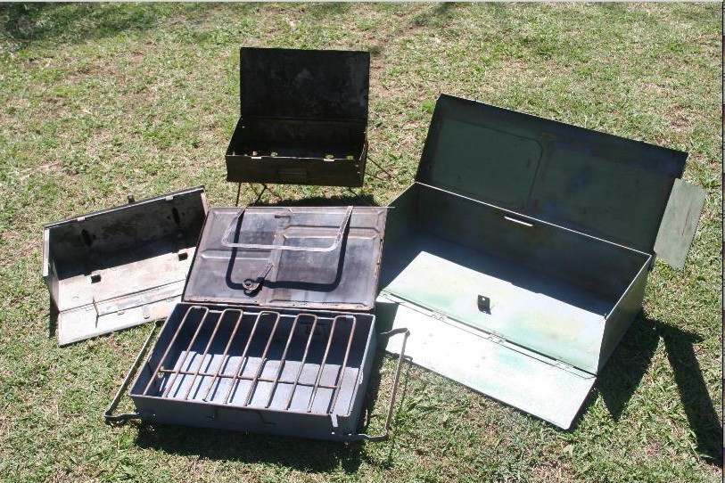

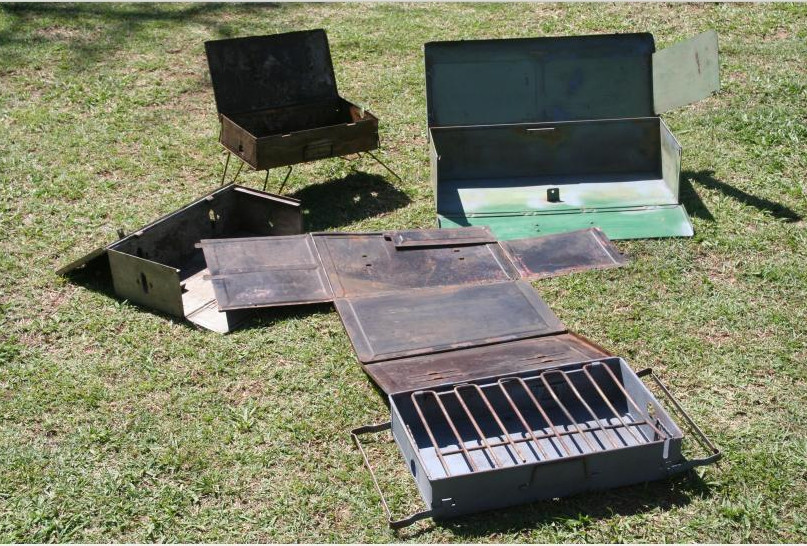

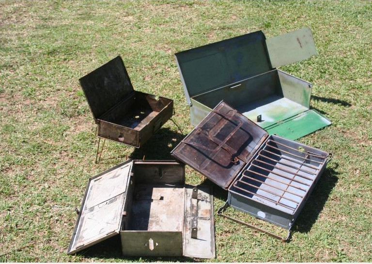

    From left to right.
    Campingo, Coleman 2E (foreground), Bansford and a Handi double burner suitcase. I intend to marry up the Handi stove my neighbour gave me with another I have here and they will reside in the Handi suitcase.

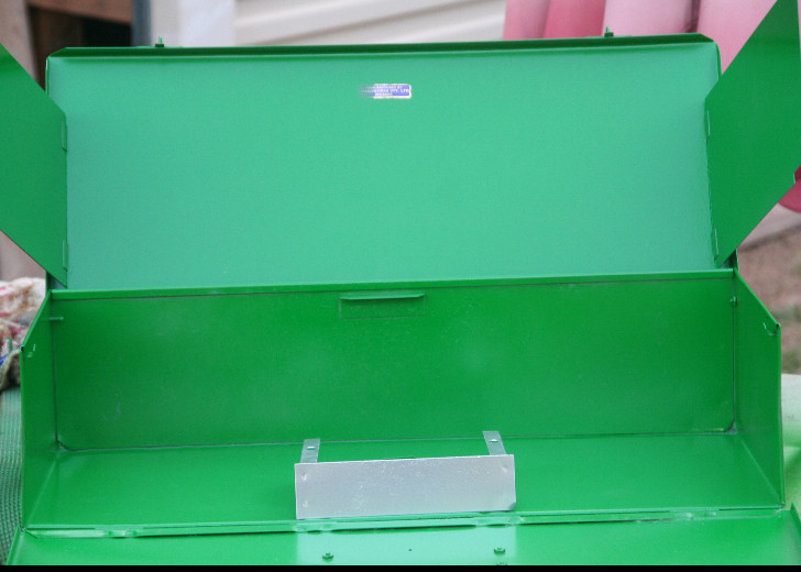

    The Handi suitcase is coming along nicely as well as the bracket that the two stoves that fit in the case bolt to.
    Is the colour a natch for the original paint - no it isn't. Do I care that it isn't painted in the original colour - no I don't. When I first joined this topic I was more concerned about using paint as close to the original colour as possible. I've mellowed somewhat to consider the preservation factor of this topic. The best interests of the GPA concerned is to preserve first and worry about original colours at a later date or not worry about then at all.
