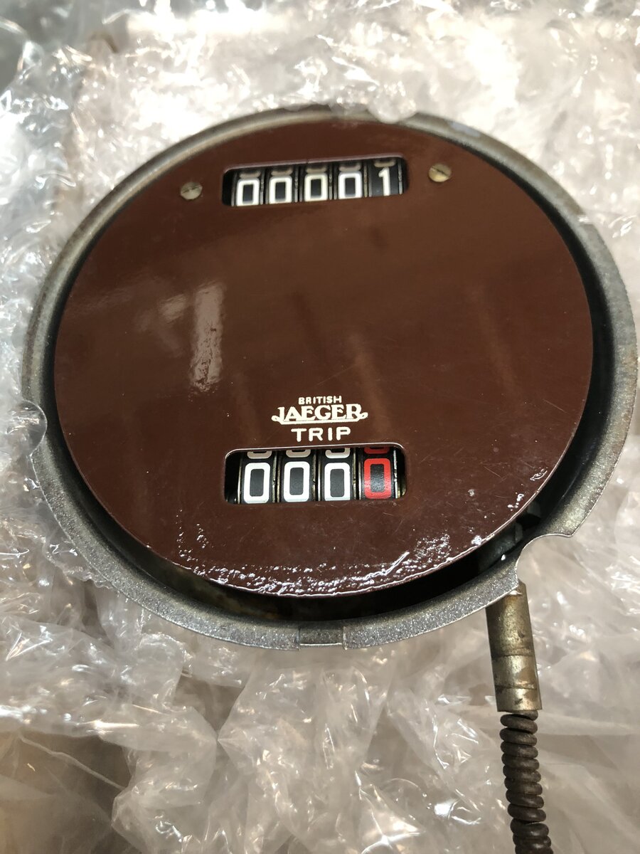

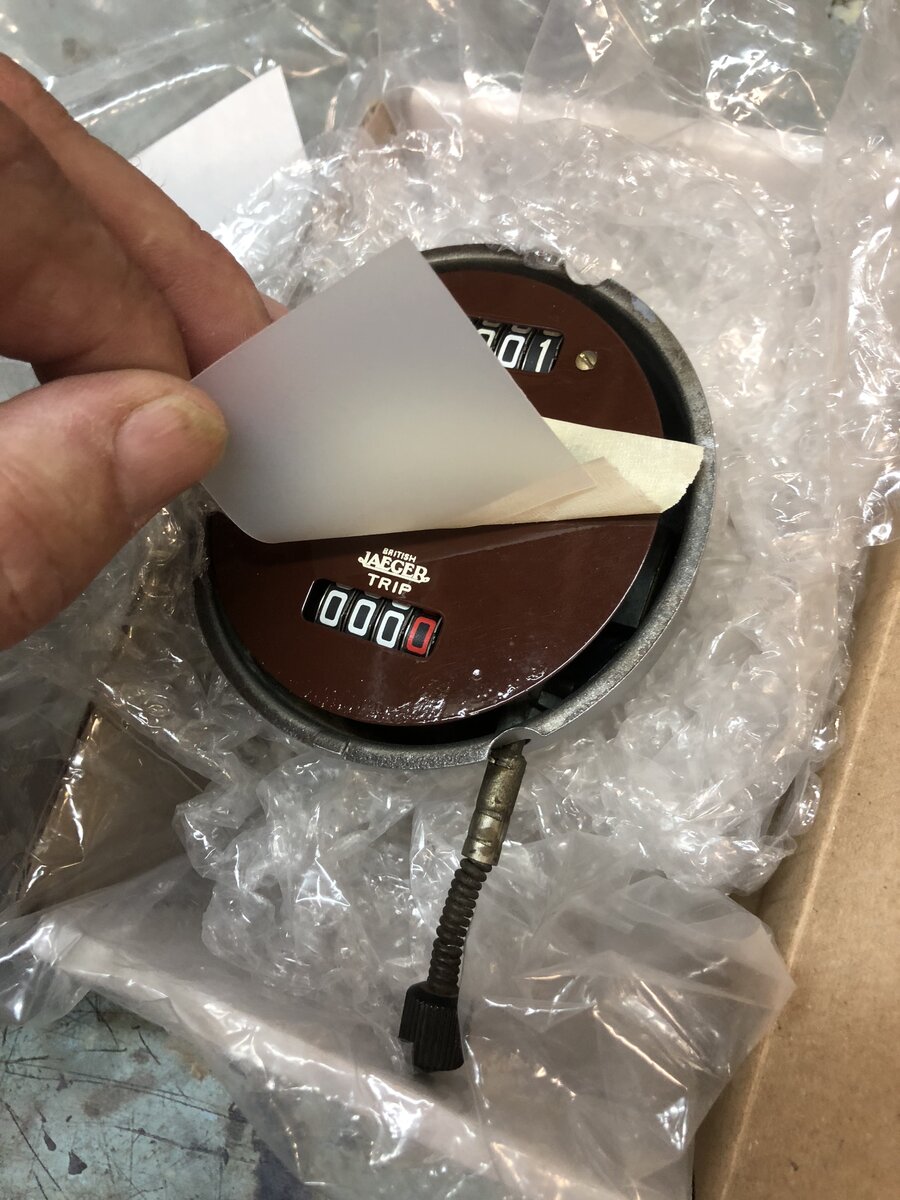

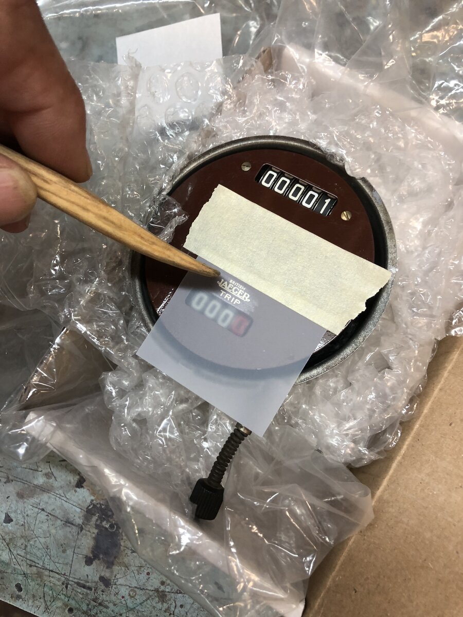

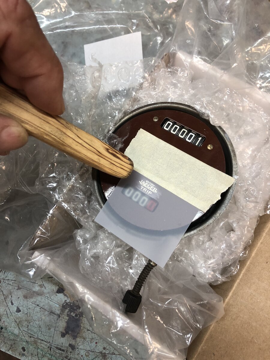

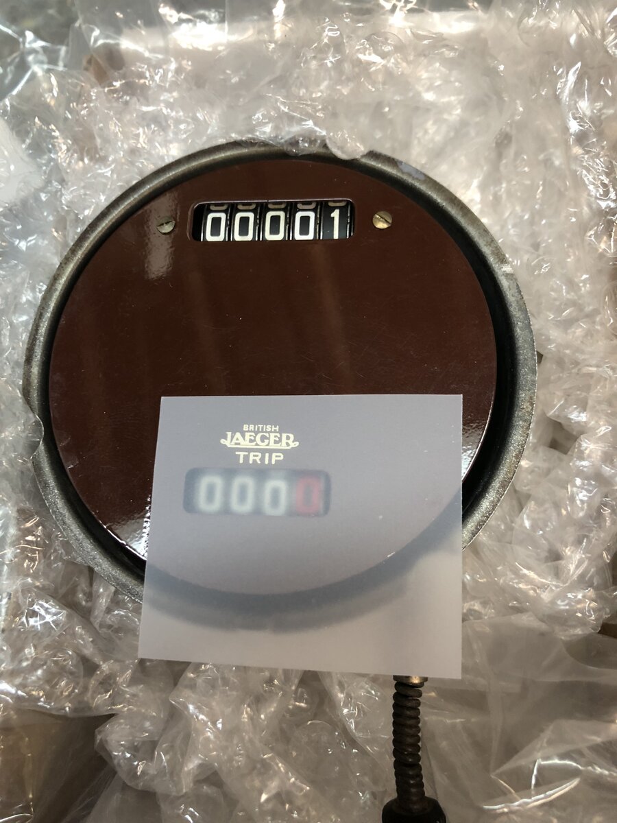

    Here is an example transfer onto a rare 1934 MG PA dash gauge known as a Mile-O-Meter.
    First positioning, next fasten into place, Burnishing w/ wooden tool, transfer complete ready for clear coat.
