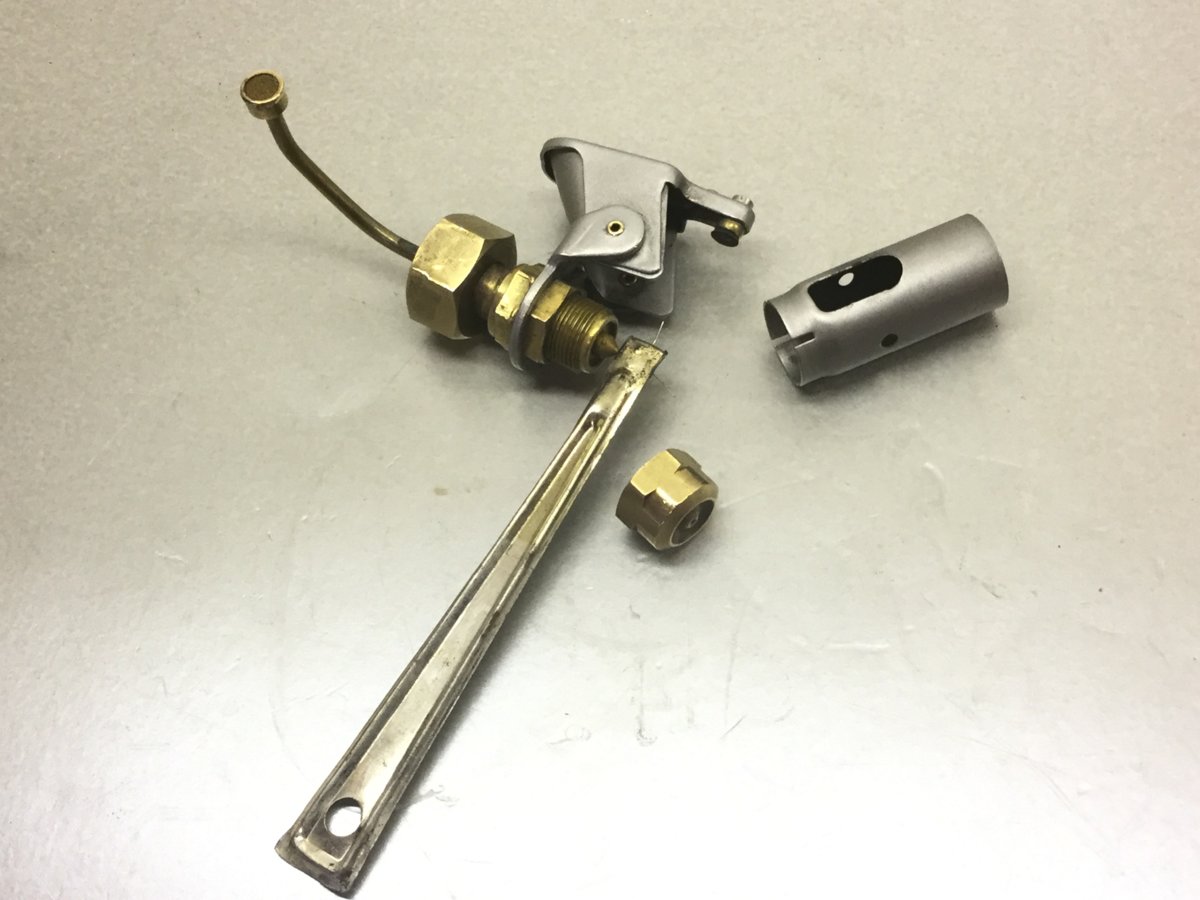

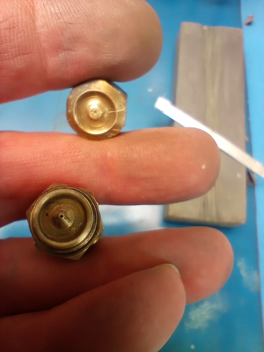

    Good evening. I am cleaning parts for a Petromax 829B lantern. Quite a few parts are largely stuck with a gummy substance. I encountered a problem while cleaning the heater Rapid.
    The suction line and holes are obstructed.
    For now, I soaked all the parts in kerosene. I don't know if this will dissolve the impurities. The 0.2 mm pricker seems too thick, or this ooze is already very hard.
    What diameter of the pricker should I use? Or, how to effectively ( maybe chemically?) unclog these parts?

    I assume someone covered up leaks with this rubbery substance. You can also see from the outside that someone has worked with unsuitable tools.
    I recommend that you stop using these parts and look for replacements from the Bundeswehr's stocks. The part is a wearing part. In the Bundeswehr storage boxes there was a spare rapid warmer in each of these 829B boxes.

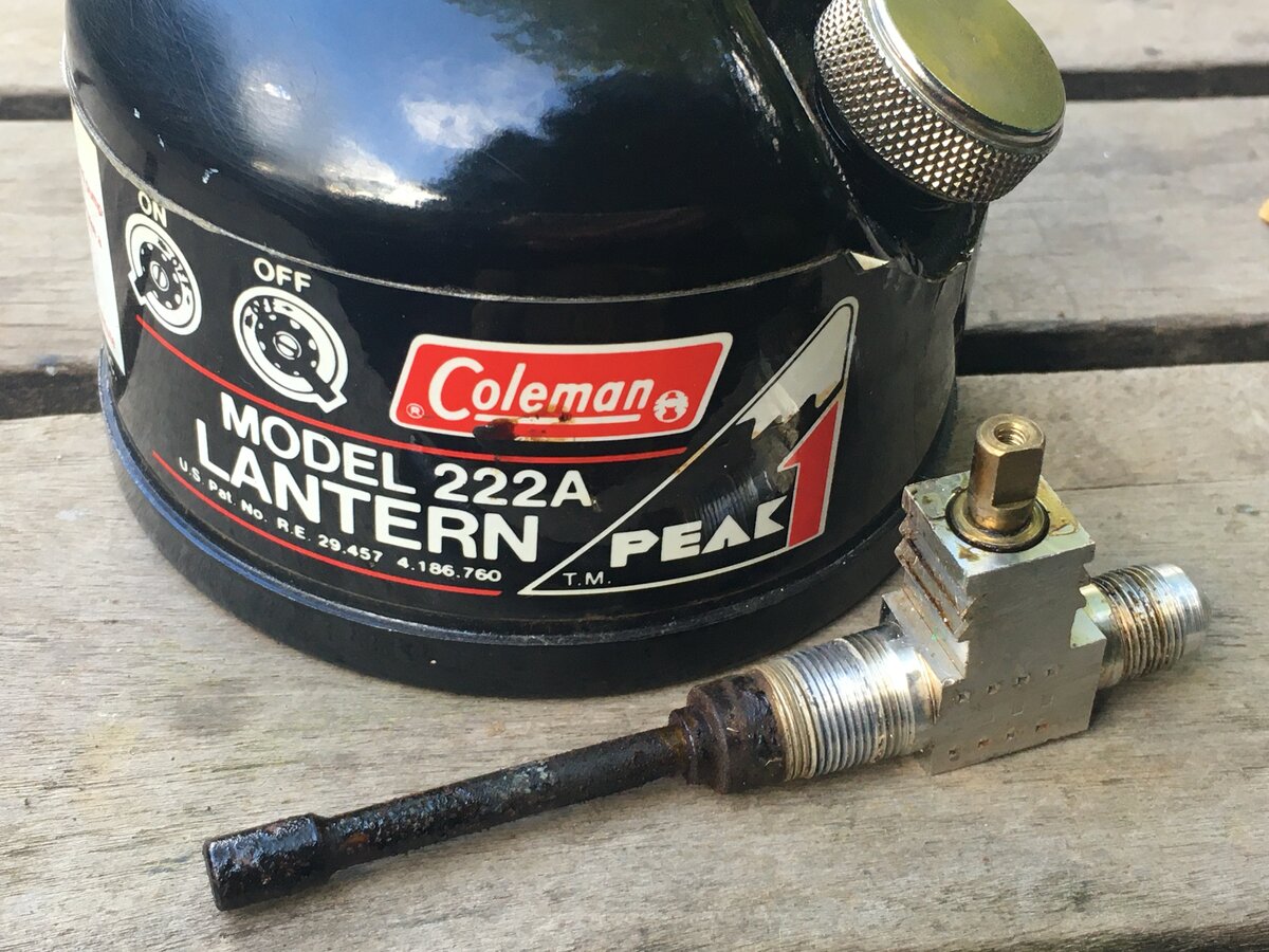

  7. presscall
    1,764
    Lancashire, UK
    Yes, as on my Heinze Geniol stove with a pre-heater torch.
    The pricker measures 0.18mm diameter, which is consistent with many lantern auto-prickers and jets.
    As Tony Press said, acetone shifts that sort of gum, most recently on my Coleman 222A fuel pickup tube.
    John

    Success. Acetone largely dissolved the fouling and with the help of compressed air managed to unclog the holes.
    I need to get a suitably thin pricker to speed up the puncturing process in the future.
    Thank you again for your helpful posts.

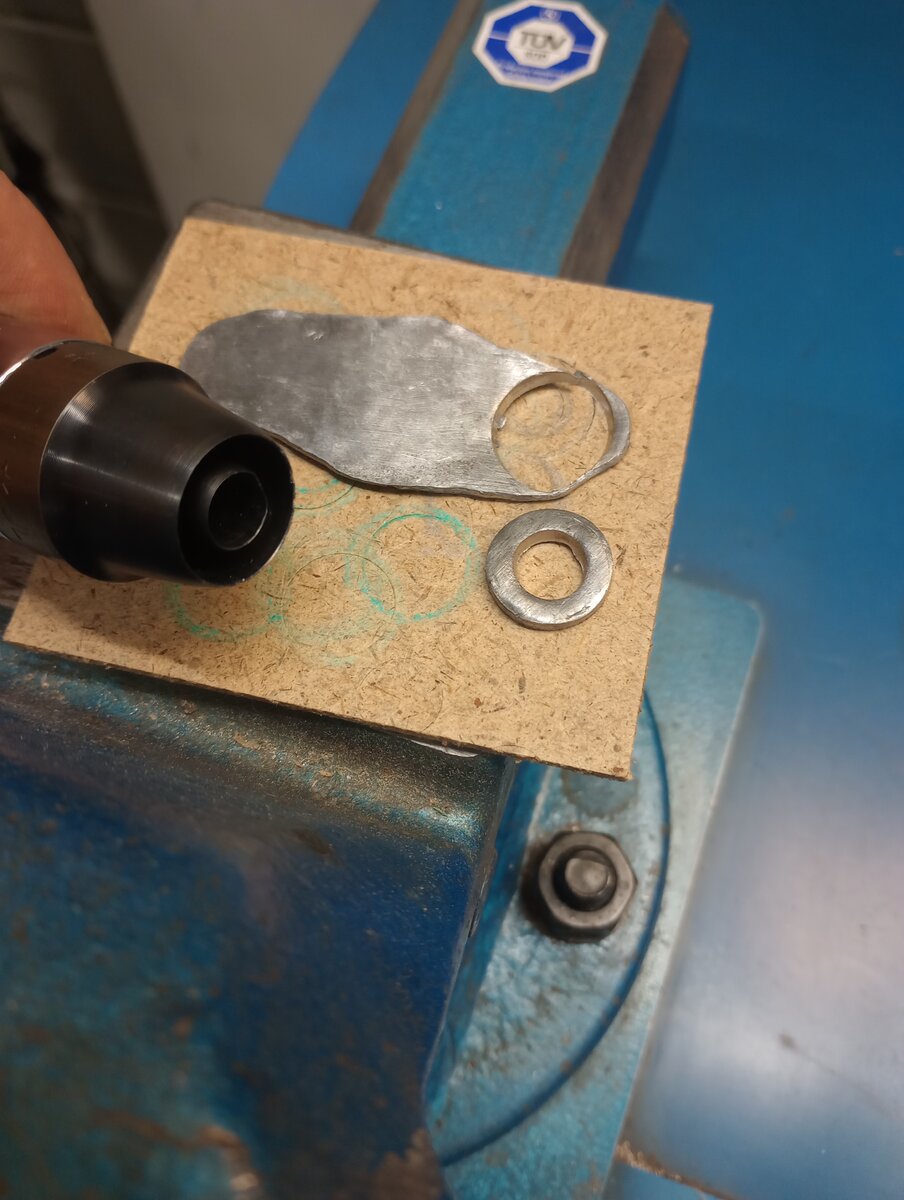

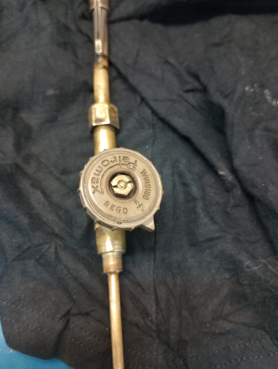

    By complete coincidence, while cleaning the 829 B's components, I rubbed the pump handle with fine 1000 grit sandpaper and a nice blue color appeared under the layer of tarnish. Other parts were also exposed.
    Before.
    Now.
    Since the old lead gaskets were already badly deformed, I made new ones from a fishing weight.
    After replacement, I bolted all the parts to the tank and did a leak test. No leaks.

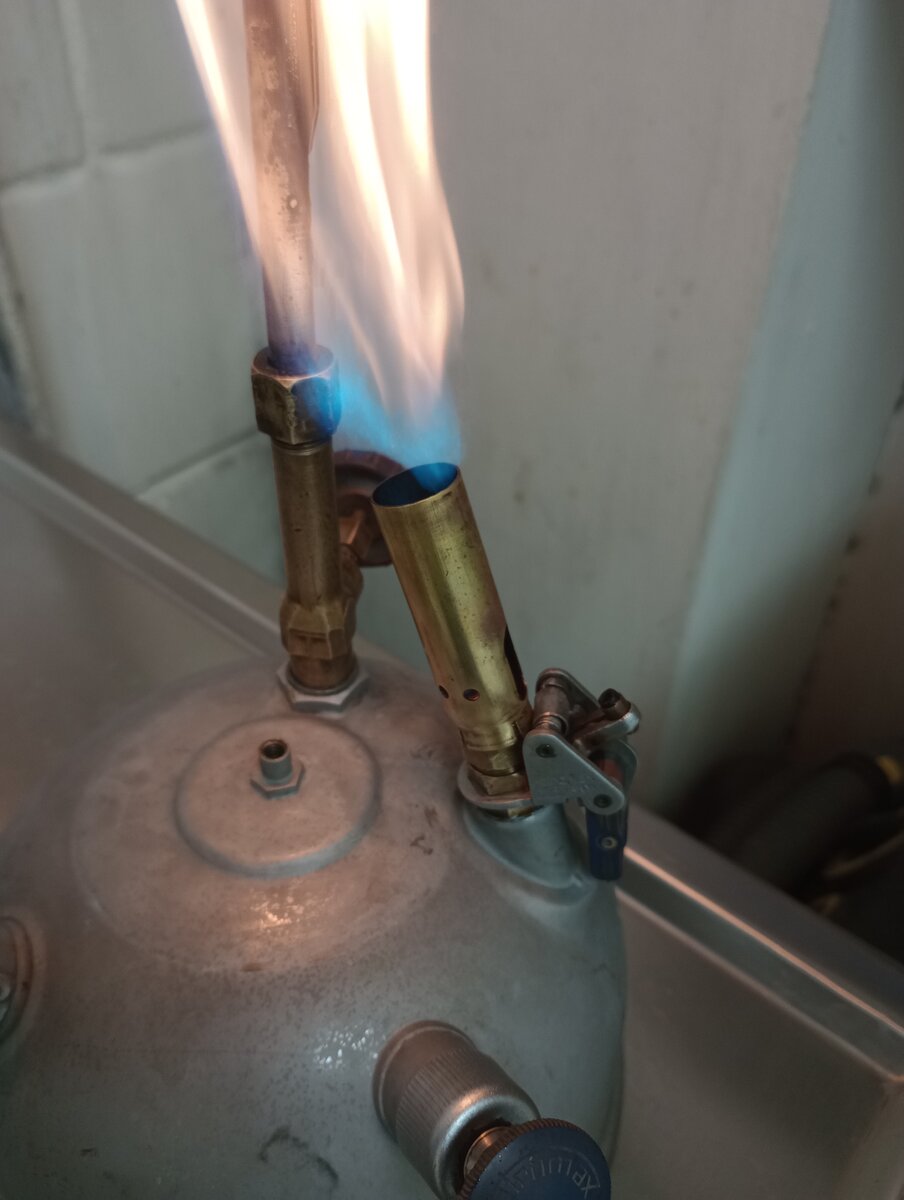

    The pressure gauge does not want to work, so I inflated, as in my Petromax 826 without a pressure gauge (about 70 pumps).
    Rapid works.

    I think your rapid heater is maybe burning a little rich. When mine did that it was the two smaller holes either side of the main jet that were partly blocked.
