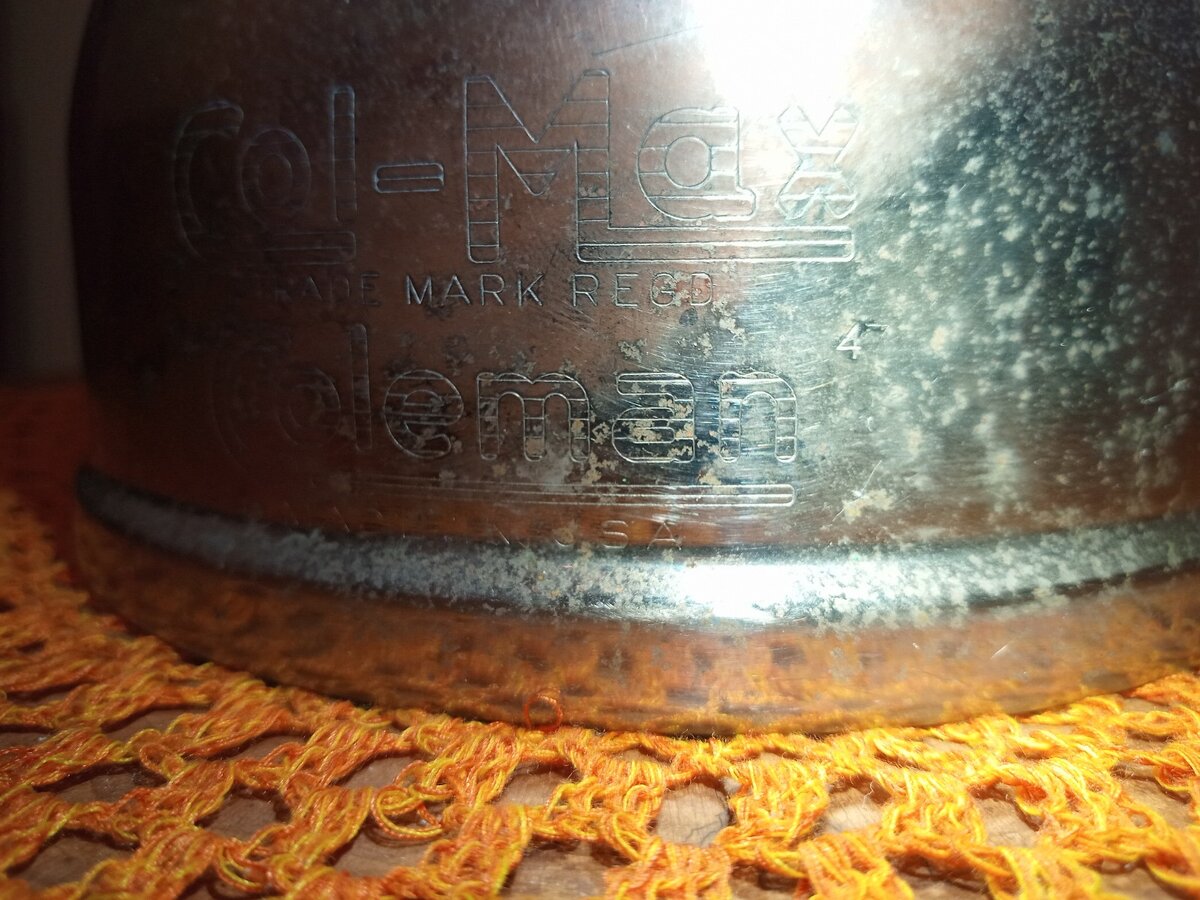

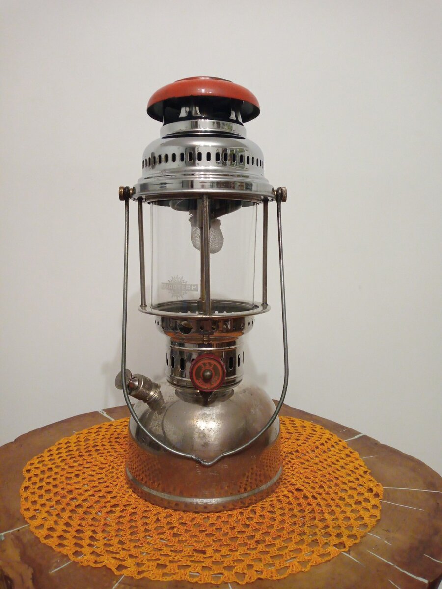

    Please find below Coleman Col-Max 333, 300CP made in USA. Dated A 1947.
    That model is a Coleman’s tribute to Petromax ;)
    IMHO - the most boring Coleman and one of the most interesting Petromax clones ;)
    Lamp in pretty good condition, all parts original except for DUROTERM glass. It is very bright with Butterfly 500-600CP mantle.
    There were some minor rusty spots at the bottom of the tank which I treated with APP “R STOP” and protected with transparent lacquer.
    Red enamelled cap was treated for a week in Evaporust to get rid of any rust.
    Steel parts (inner casing, centring plate) were pretty rusty so I cleaned them and heated and quenched in oil numerous times. I am pretty satisfied with the result, but during the process I had to use a fire blanket in my kitchen for the first time :-$
    There is not that much interesting stuff to write about that lamp so I just present my subjective comparison to old Petromax 826:
    1. lamp is also very high quality
    2. I prefer Petromax brass bottom then Coleman steel (rust risk), but from the other hand Coleman bottom is immune to bulging and cracking so it is just a personal choice.
    3. I prefer Petromax preheating dish with that vertical pipe, but there is nothing wrong with preheating of Coleman as well.
    4. I prefer Coleman pump and fuel caps. Just because…
    5. I prefer all brass Petromax hood over Coleman enamelled steel (again rust risk)
    6. I like Coleman clear and visible dating, but those Petromax hand made scratches have a charm as well.
    7. I prefer Coleman brass nuts that holds the J-tube. These are steel in Petromax.
    It is a pity Coleman has not introduced some of their solutions such as positive shut off valve, pump with air stem etc. to mix with Petromax design and create something different. That would be super interesting.
    Anyway enjoy.

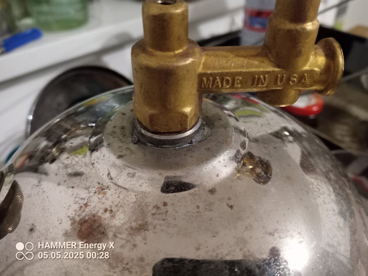

    Please watch out when assembling the generator to the tank. It is possible to use to much force and damage the tank. Then you would have to seal it using 20ml of Caswell epoxy tank sealant. Repair is not visible, but you would feel awful about the damage done :oops:
    Point to Petromax, because that has never happened to me in Px lamps...
