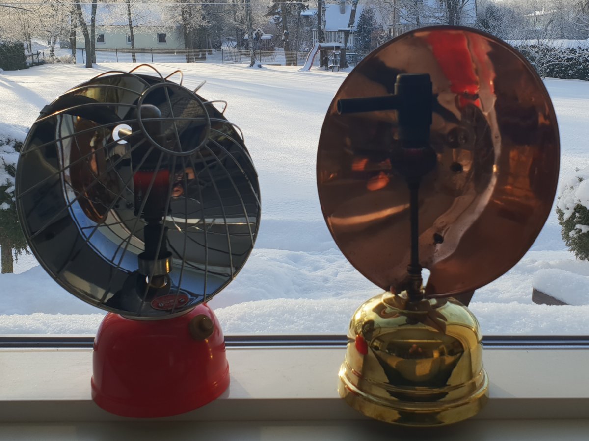

    -20 outside in Estonia today, but toasty warm inside with my heaters burning merrily.
    The Bialaddin had a recent Christmas themed paint job.
    Difficult to see the glow in the sunshine but the Kayen seems to give more heat.

  5. David Shouksmith
    As you say, it's difficult to tell in the light, but both of those should have all of the mantles glowing red. Could we see a photograph of them burning in darkness? [-o< :)

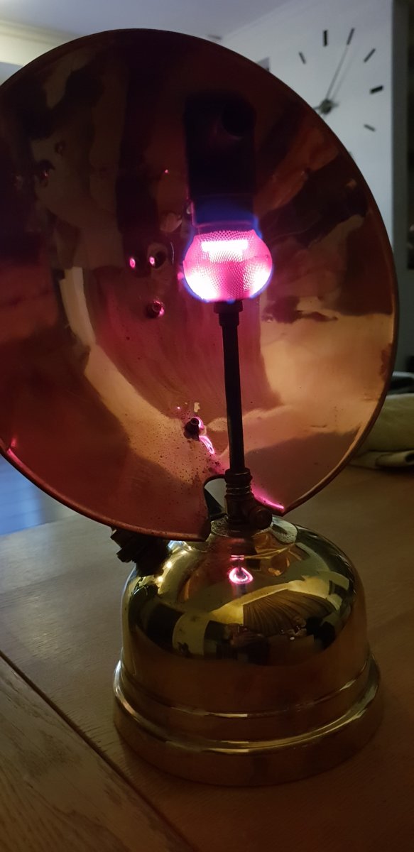

    Kayen burns really well.
    Pricker not so great. The wheel is really small, so hard to turn fast enough without putting out the heater. Managed to stink the house out with kero vapour. Lesson learned keep a propane blowtorch handy.
    Bialaddin will only burn 1/3 to 1/2 way down the mantle. Any hints to get it to go better?
  7. David Shouksmith
    Assuming everything else is clean and in good working order, it's usually the vapouriser.
    Once you've got it sorted, I think you'll find the Bialaddin will at least match the Kayen in terms of heat output...

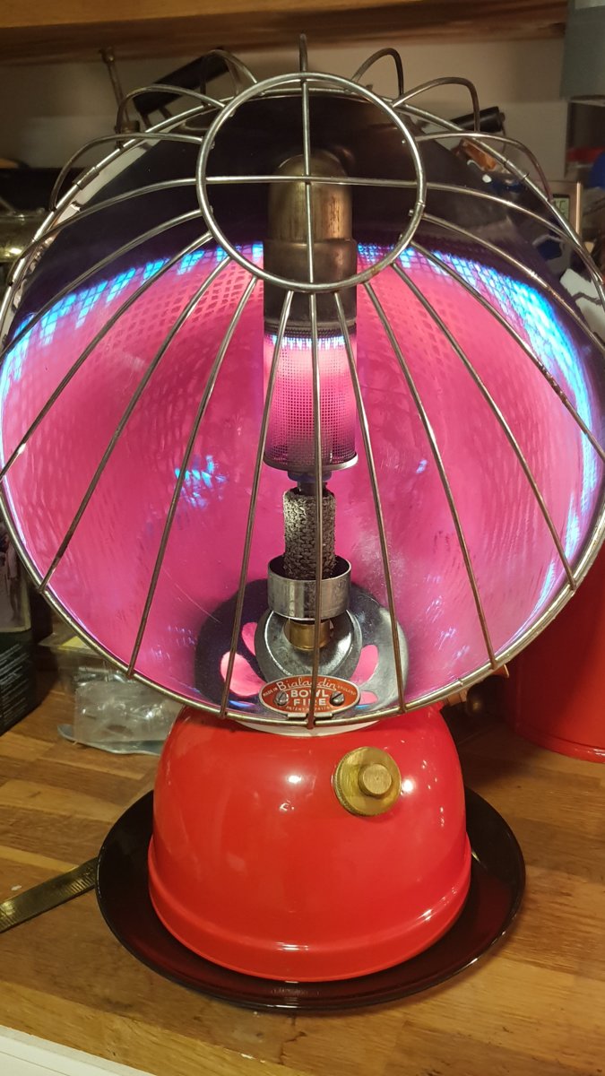

    Been fettling a bit over the last week. Bialladin now works great and the Kayen not so well at all.
    Both have only the tiniest little stubs left on the pricker. My Kayen keeps getting blocked and won't clear.
    Tomorrow I will throw the generator into the log burner for a few heat quench cycles. Hopefully this will remove the little scraps.
    As a British lamp newb here are some silly questions. Is it true that you can't buy a pricker rod? The generator was really designed to be scrapped and a new set of parts installed every season?
    Bowl fire pumping out heat. My workshop feels like a solarium. Cherry red all the way down and a little bit of blue coming out of the bottom.
