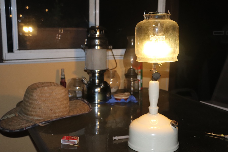

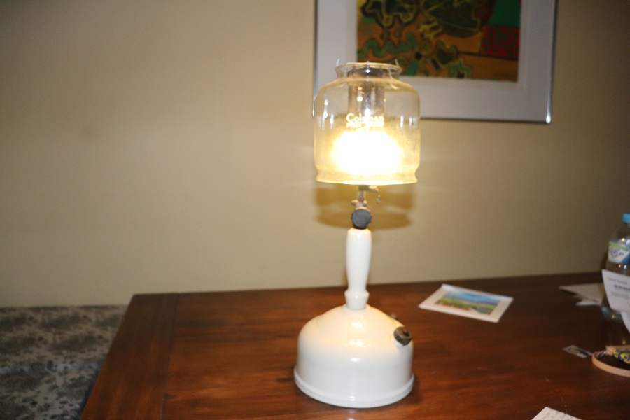

    Hi everyone! I just finished an old 159x table lamp that needed a bit of TLC. I cleaned and lined the tank with fuel tank paint, replaced the filler seal, painted the font with epoxy spray paint which is pretty close to the original colour. I left the base in original with the stamp showing. I took a chance and didn't disturb the tap and generator and it fired right up with no leaks. A very nice lantern that gives off quite a bit of light! lantern.jpg IMG_1025.JPG IMG_1021.JPG IMG_1019.JPG

    Great fettle job David, looks and runs geat

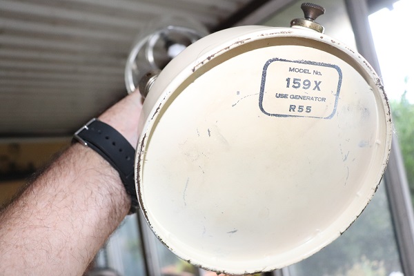

    What is the date stamp on this lamp? And is it Canadian?

    Well saved.:thumbup:

    Hi Tony, That Lantern has 1 57 so I'm guessing Jan 1957 and its made in Canada. The rod for the Aladdin A1 arrived today. Quite clever putting it inside a old pen to keep it damage free. Thanks again. Cheers Dave

    David, it's cleaned up nicely, congratulations :thumbup:
    Are you running it on kerosene or Shellite?
    And will you provide a picture of the control cock (side view).
  8. Walkop Australia
    955
    Came up well and running nicely.

    Sorry to be a pest, but can you check it's not 1/52. There are at least 4 Aussie-found Canadians in the Reference Gallery that are dated 1/52 and I was wondering whether yours is from the same import order.

    Hi Tony, I checked again with a magnifying glass and it is 1/52.
    Cheers Dave
  11. Tony Press
    11,092
    Thanks, David.
    CJ Thomas must have ordered a big consignment of Canadian Coleman 159X in 1952, given the predominance of the 1/52 date among the Australian examples.

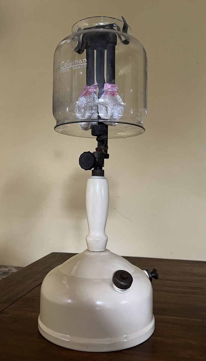

    Looks great and it is working well. Is it missing a spring clip to hold the globe in place? Mine has two of them.

    i think some of these lamps came with the single clip. My lamp is running on kero and the tank is lined inside to stop the rust flakes
  16. Tony Press
    11,092
    I’ve never seen one with a single clip, but that doesn’t mean it never happened.

    Thanks Mate! It lights really easy and burns nice and bright and is very user friendly.
