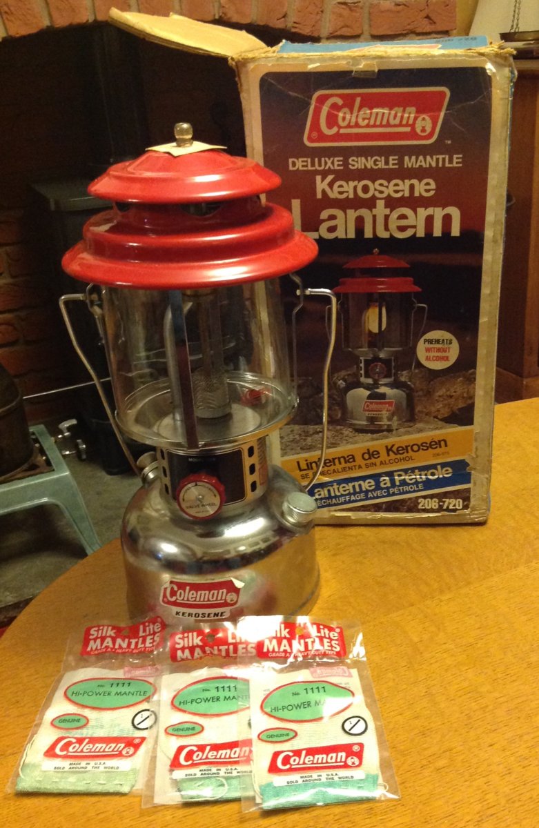

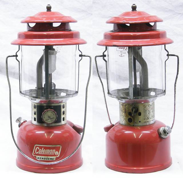

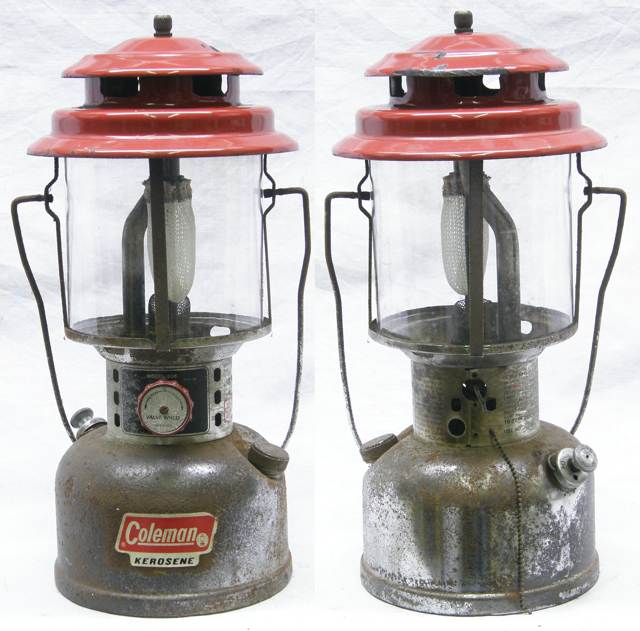

  6. Mackburner
    Model 206 is an uncommon lantern. A very few have turned up in the US. There were two variations with one painted red and the other nickel plated. The plated fount is from 1976 and the red painted fount is from 1980. That is certainly one to be cleaned and cherished. Here are my two dated 11-76 and 4-80. They are a bit rough perhaps but good to have in any condition. ::Neil::

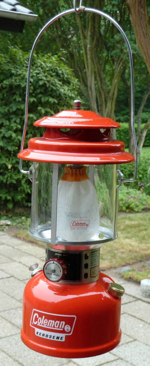

  10. Salar and Stove Denmark
    Sep 29, 2011
    20
    Denmark
    Found one, and fully restored it

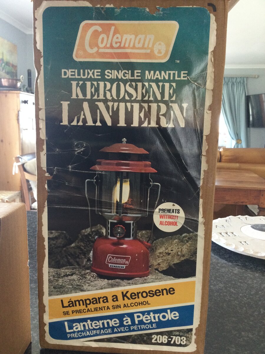

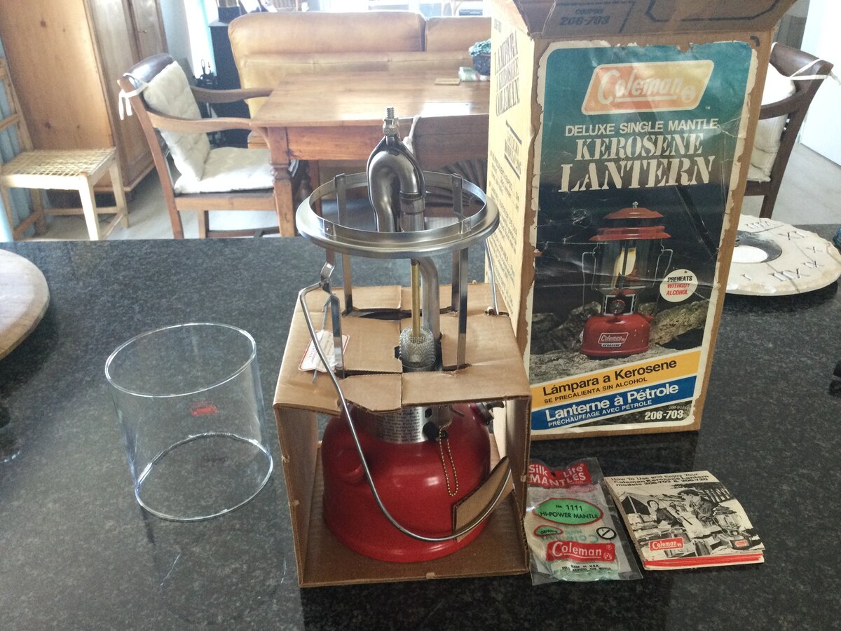

  11. Willem
    Sep 2, 2011
    28
    South Africa, Cape Town
    I have a 206 dated 1982 unlit in box bought at a market and very tempted to open and light. Then I sat in a dark corner until the temptation passes.. E934BC0B-A340-41FB-B386-D4F3345B812B.jpeg 782FC110-734B-4153-A020-DFE3BD7745DD.jpeg
  12. ROBBO55
    4,439
    @Willem
    I'm glad you resisted the temptation. :thumbup:
    That would be a good example to photograph and post in the Reference gallery. :lol:

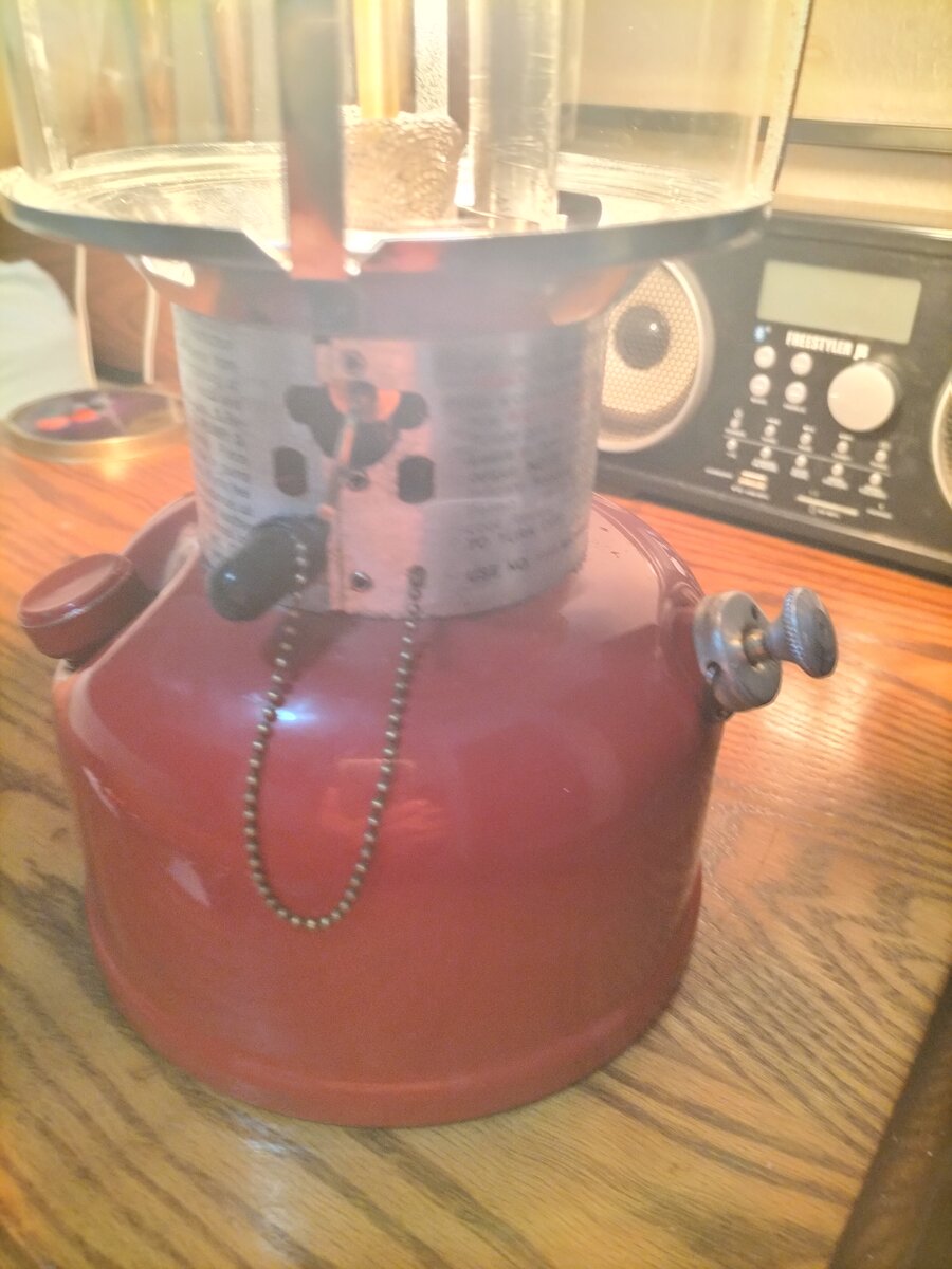

  13. Jacob van Pareen South Africa
    May 9, 2023
    216
    South Africa
    Pheadres42,
    I had to find a dropper rubber at a chemist, and used a Big pen ink tube as a little pipe.
    It works fine and looks authentic, especially with the original chain, that I took from another old lantern.
