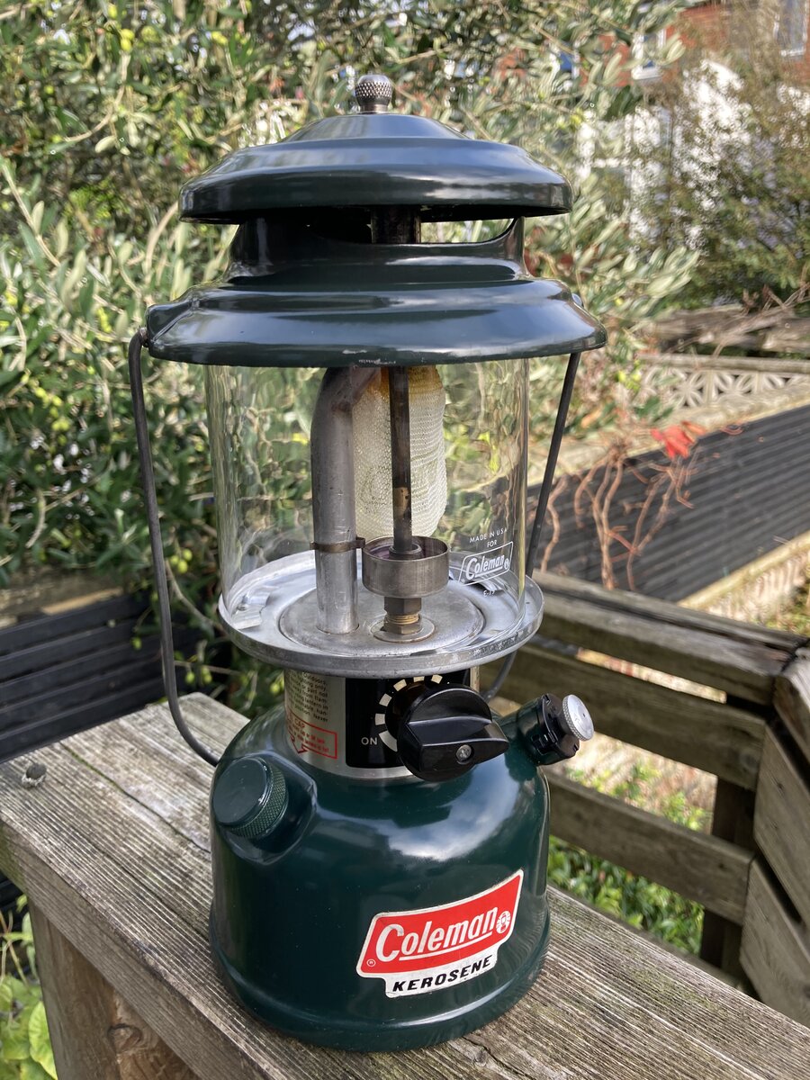

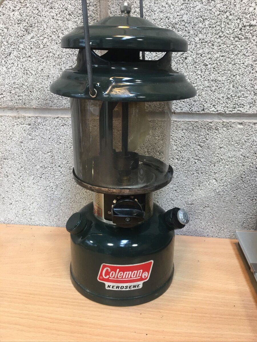

    And along came another coleman.. a 214A700 with 92 on the base
    This one was all sooty, somebody had filled it with coleman fuel, and then judging by the type and quantity of fine sand found in it extiguished the ensuing flames with a fire bucket !
    After much cleaning and a new pump leather it lit first time. It does suffer a faulty pump NRV (probably sand in it) so I need to find an NRV tool having tried washing it out with acetone/oil etc.

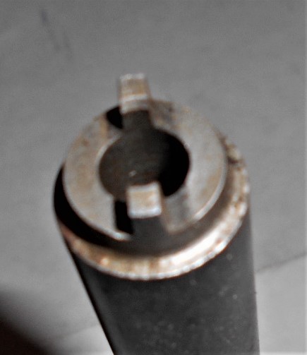

    Perhaps you can make your own. In order to reduce / eliminate damage to the slot in the NRV, the key elements are:
    a) a shaft that is a snug fit in the pump tube.
    b) a blade that is a practically perfect fit in the slot.
    Not a particularly good image but this is the business end of a tool for older type valves. Ignore the hole down the centre, it doesn't apply to the valve in your lantern. Note not only how broad the blade is but also that in cross section it is square.
    If you want to have a go at making your own, find a long enough bolt with a diameter that is a snug fit in the pump tube. If it's bit slack, pack it out with insulation tape.
    The square section blade should go the full width of the bolt and needs to be 3/32 X 3/32 inch (aprox. 2.5 X 2.5 mm).
    Place the tank against something that won't move and using a socket with sliding T bar (to balance the torque), use as much downward force as is necessary to keep the blade in the slot and turn in the appropriate direction.

    @phaedrus42 - and so it does. And so I did. And it now works !
    top tip - many thanks
