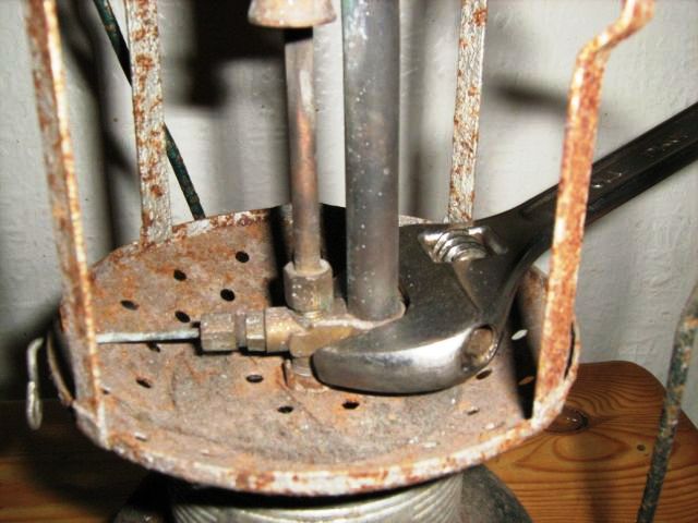

  14. Henry Plews
    3,068
    Hi Gozzy!,
    Not sure you need to. With a slim spanner, slacken the nut which holds the frame down on the collar and then unscrew the pricker control & burner.

    88
    Thanks Henry an christer for picture I understand now.
    Very helpfull. cheers.
    Gozzy
  19. Henry Plews
    3,068
    A big thank you to Christer who helped me (again) to upload the image.
    Henry.
