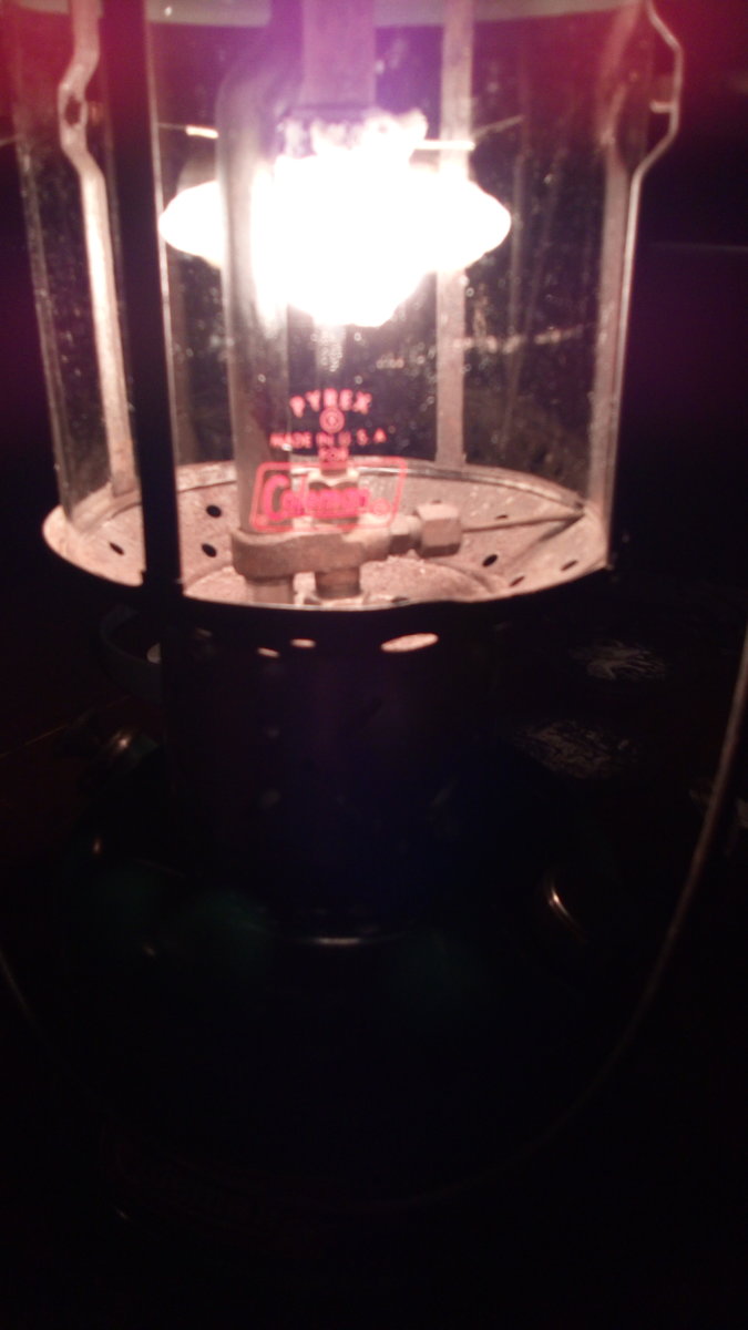

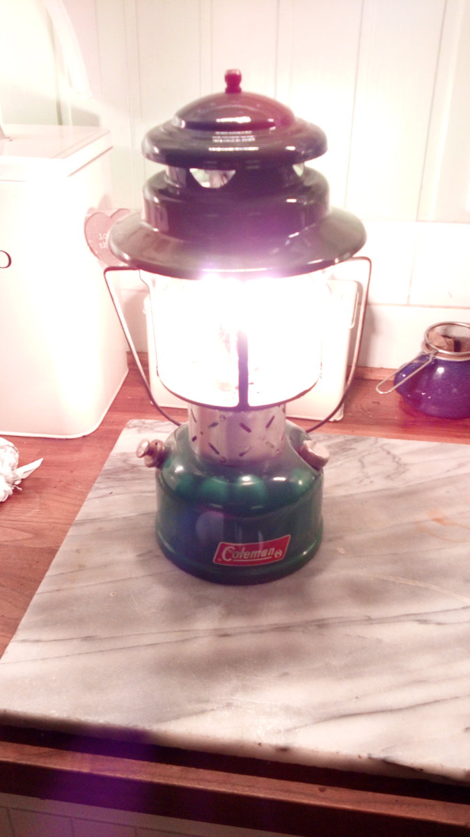

    This is the second lantern from my friend in Canada. It's got a flint igniter but I took it off to fit two new mantles.
    It works extremely well as you can see although I bust one of the mantles putting the igniter back again - you can even see the hole!! Doh!

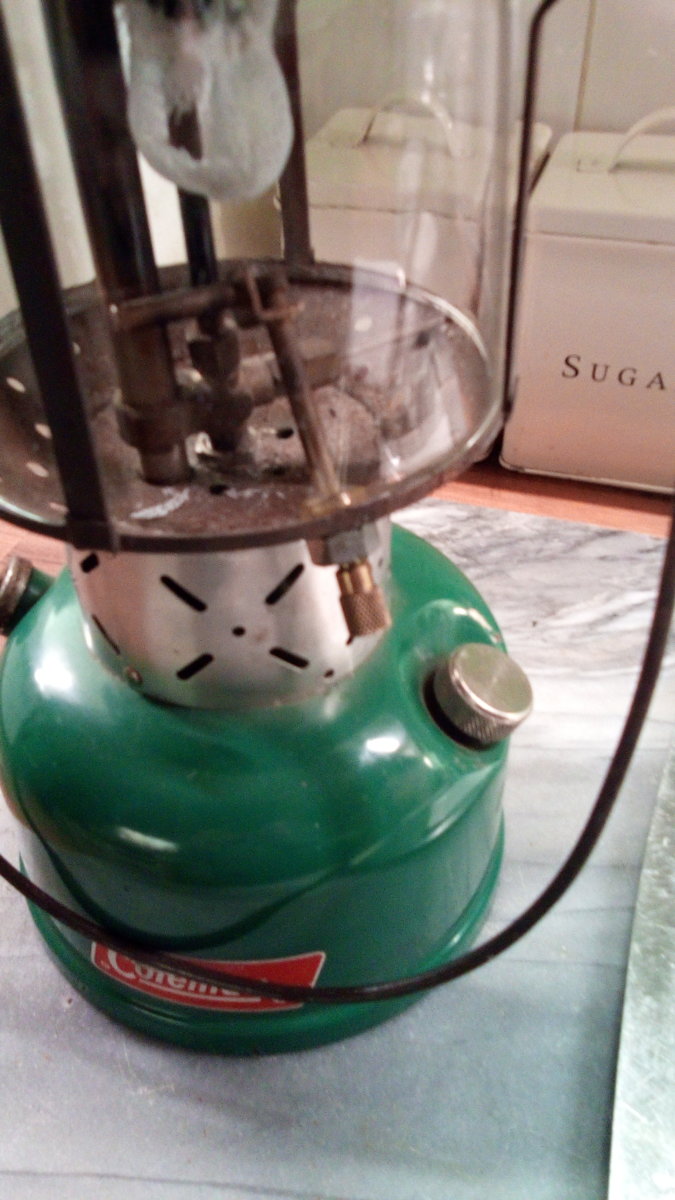

  12. ColinG United Kingdom
    4,816
    I checked the igniter - AKA whoomph stick - and it had a few problems. The wire key had been sheered off inside the keyway and was preventing the nain shaft from sliding up and down but that was an easy fix. Next, the flint tube that is fixed to the 90deg bracket was loose (looked like a force fit or interferrence fit) and fell off when put under any sideways movement so I did some micro-soldering to keep it in place. Since I did that I figured I might as well do the same to the main shaft as that seemed to be a force fit too.
