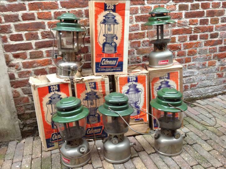

    Well sometimes you get that change: buying a lot of lanterns.
    I went for this lot 5 Coleman 236 lantern including boxes for serious money.

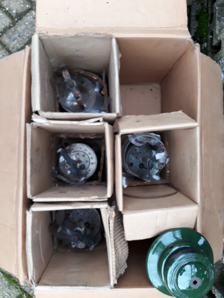

    lamps arrived in a big box,
    sideways and for some stupid reason with the top loose in the boxes.
    Result four broken 236 globes.... :evil: :evil: ](*,)](*,)](*,)

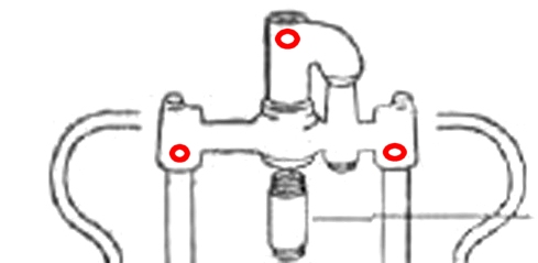

    All have this black tar like corrosion on the bridge part. What is this and how to clean it ?
    Is it soot etc. or corrosion of the metal ?
    Are these red marked points rivets ?

    The circled points are not rivets they are targets to locate the castings in the jig for machining. These are castings so you clean by heat and quench. Not likely to be corrosion so you can be quite brutal with that part of the burners.
    There are other Coleman suppliers and you can find them here Coleman – High-quality Camping Gear & Outdoor Equipment but they don't often have obsolete parts so in general for our older lamps OCP are cheapest and best. ::Neil::
