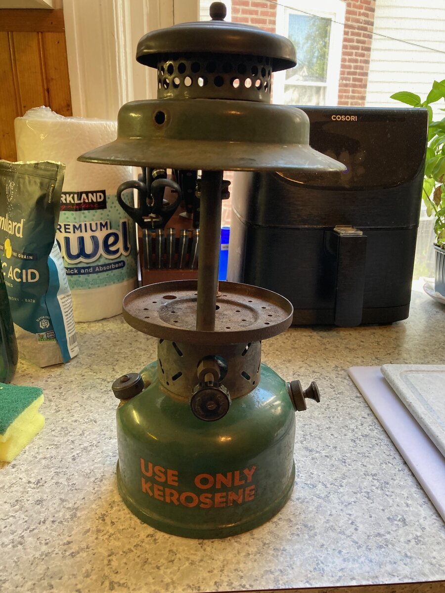

    I recently fettled a 237B that I got at a VW swap/camp out/car show. It was five US dollars but needed a globe and generator and bail! Anyway it's a monster! Can't believe how bright it is.
