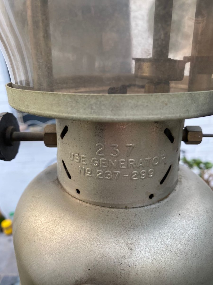

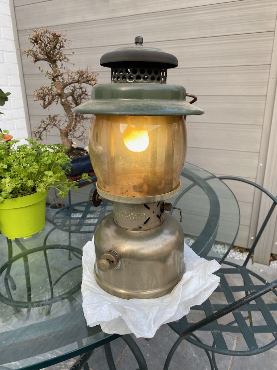

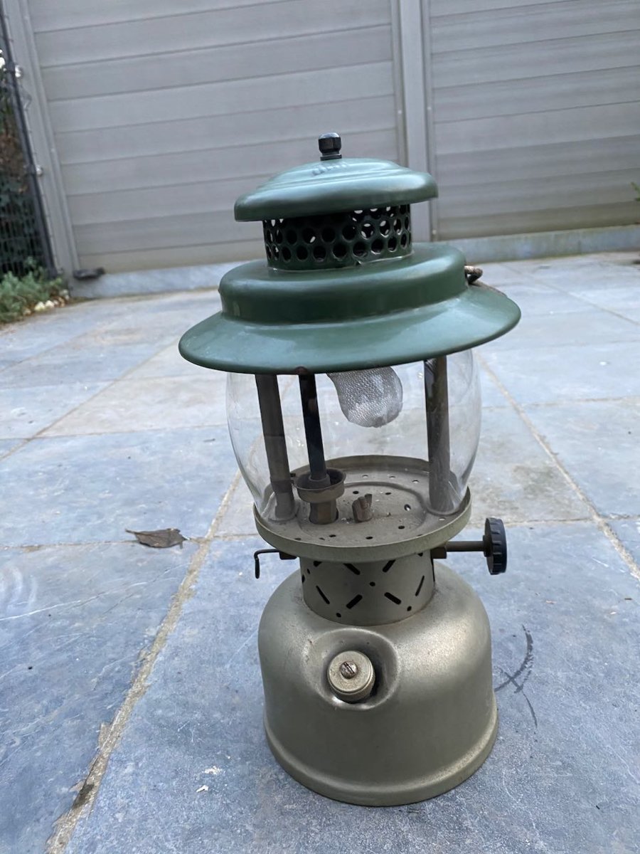

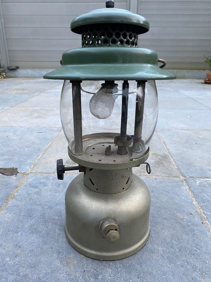

    Hi everyone,
    My grandfather passed away this summer and while cleaning his house I found this Coleman 237 which he used when he lived in Africa in the 1950's. I was immediately intrigued by it and came upon this forum.
    I got it to work but I would like to see it being used like he did.
    Which mantles should I buy and what is the best fuel? I've attached some pictures.
    Thanks!
    Andreas

    That is a fine lantern and I use Anchor 500 cp., mantles on my example, that is because they are more bulbous than the Coleman mantles and form closer to the vapouriser/generator and therefor keep it hotter and that ensures that the paraffin/kerosene vapourises properly so that the light is white.

    That's a lovely lantern. As for mantles I agree with @JEFF JOHNSON though purists might not agree. Genuine Coleman mantles are still widely available on eBay and many from other places but you'll need advice from someone else about which ones are 'correct' for a 237.

    That's a 500 candlepower lantern so the Coleman 1111 mantle would be the correct one to use. Peerless also makes a 500 cp mantle (in a blue package) but I can't remember the Peerless model number. I prefer Peerless over newer Coleman mantles because they're more durable.
    It can use gasoline or paraffin/kerosene or a mix of both. I've used both in my 237. Regardless what fuel you use the generator will need to be preheated in order to burn properly and to avoid a sooty flameup when you turn it on.

    I just checked my non-identical twin 236 and it’s the same date as your 237, 5/55 (May 1955).

    He used it in the Belgian Congo during the 50's. The fuel that's still in there is white so I presume it kerosene. My mother can't remember him using it after they came back to Belgium so I presume the fuel that's currently in there will be around 60 years old.
    The idea is to use it and keep it going.

    I would suggest that you replace the old fuel for new after flushing out the fount (tank). You may want to replace the filler cap seal as well, they get hard with age and leak air. These simple tasks will help to keep her running efficiently.
