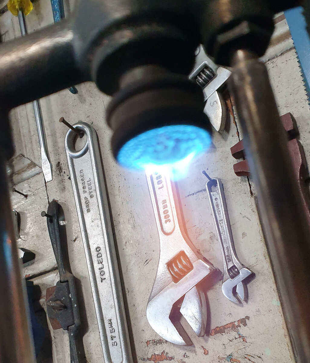

    Flame overall (Note: Temporary Non-original pre-heater cup)
    Flame at burner cap
