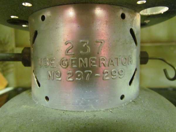

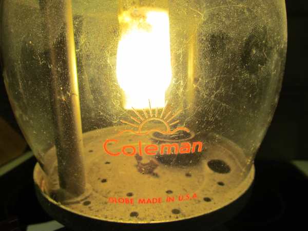

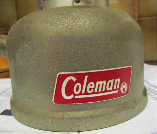

    I've been getting withdrawal symptoms from not having any new lamps. So I went to an auction tonight and picked up a fairly dirty but sound looking 237. I don't know anything about this type of lamp so any info would be greatly appreciated. I have managed to work out that it runs on paraffin because of the spirit cup and also the presence of some old fuel in the tank plus it ran when I gave it some pressure and heat. Got to do some cleaning now. :roll:
    1352236518-237_a.jpg 1352236525-237_b.jpg 1352236530-237_c.jpg 1352236539-237_d.jpg

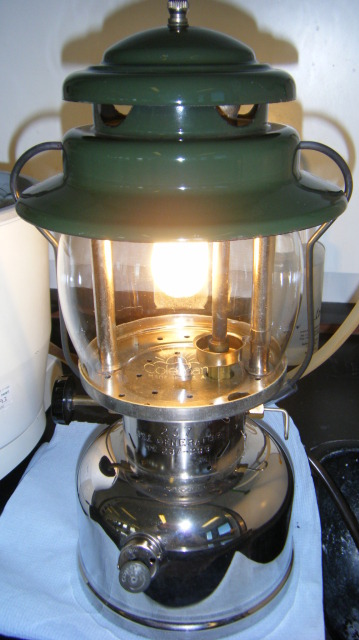

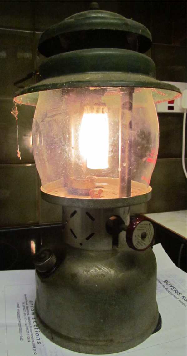

    Just finished cleaning the lamp up. I started off with a peerless 111 but it got a massive hole in it before it had finished burning off. So I removed that and fitted a 24-C. I think the problem was that it didn't burn off evenly so it curled up one side. To make sure that didn't happen again I soaked the next one in meths, filled the spirit cup and set fire to the lot. This resulted in a very quick even burn and the lamp is now running flawlessly and the mantle is free of holes. I shall take some more pics later when it gets dark, although it is surprising just how bright it is in daylight.

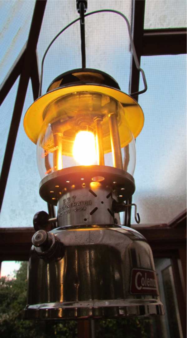

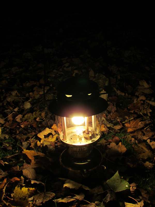

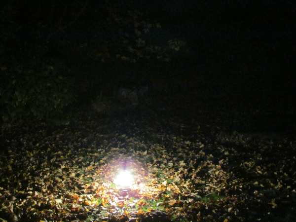

    Night shots. :D

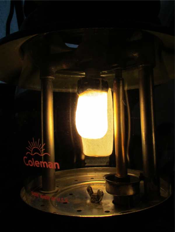

    Here's my '61 running on Coleman fuel with a Peerless 111 mantle. Believe it or not the pic was taken in strong sunlight.
    Very bright, but maybe not quite as bright as I'd expect (especially since it's seems virtually NOS), and even with a lot of pressure in the fount it flickers a lot. I wonder if it would run a bit better on paraffin.
    One thing to mention, even if I shut it off tightly I've noticed that once the lamp cools, fuel is getting back into the vapourizer. So I'm having to tighten the valve again once it's cooled. I wonder if that's because the needle valve hasn't bedded in properly yet. 1352811087-DSCF5174_opt.jpg

  16. dmacp
    dmacp United States Subscriber
    Jun 14, 2011
    115
    Altadena, California USA
    The valve may leak. There is no fuel air tube-just a straight pickup, and sometimes the brass cone/seat on the valve get a groove worn in them and will not seal properly.
