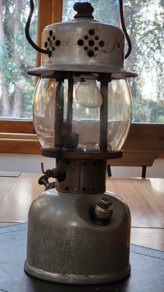

    It's been a long time since I posted in this wonderful place where you can find beautiful lamps but also beautiful people. On this occasion I present to you this marvel, I bought it as is, it works perfectly, it illuminates a lot considering its capacity, I am really happy with it even though I am a lover of European lamps, in fact it is the only Coleman that I have.
    I would like to get the hat screw, which sleeve is recommended (I put a 300-400 cp Butterfly on it but I think it got too small. And I would also like to know what year it was built. Would that 66 indicate that?

    Nice lantern. It should be from the 1950's.
    The year and month should be stamped either side of the Coleman logo on the fount/ tank.
    The top vent screw is available on ebay.

    You have a very good lantern.
    The “No. TK-66” is the type of generator.
    I would find a 250 or 300cp mantle for that lantern.
