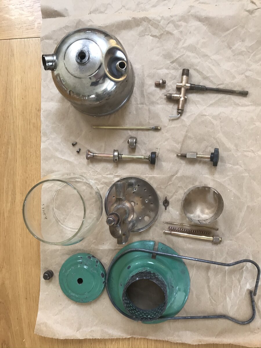

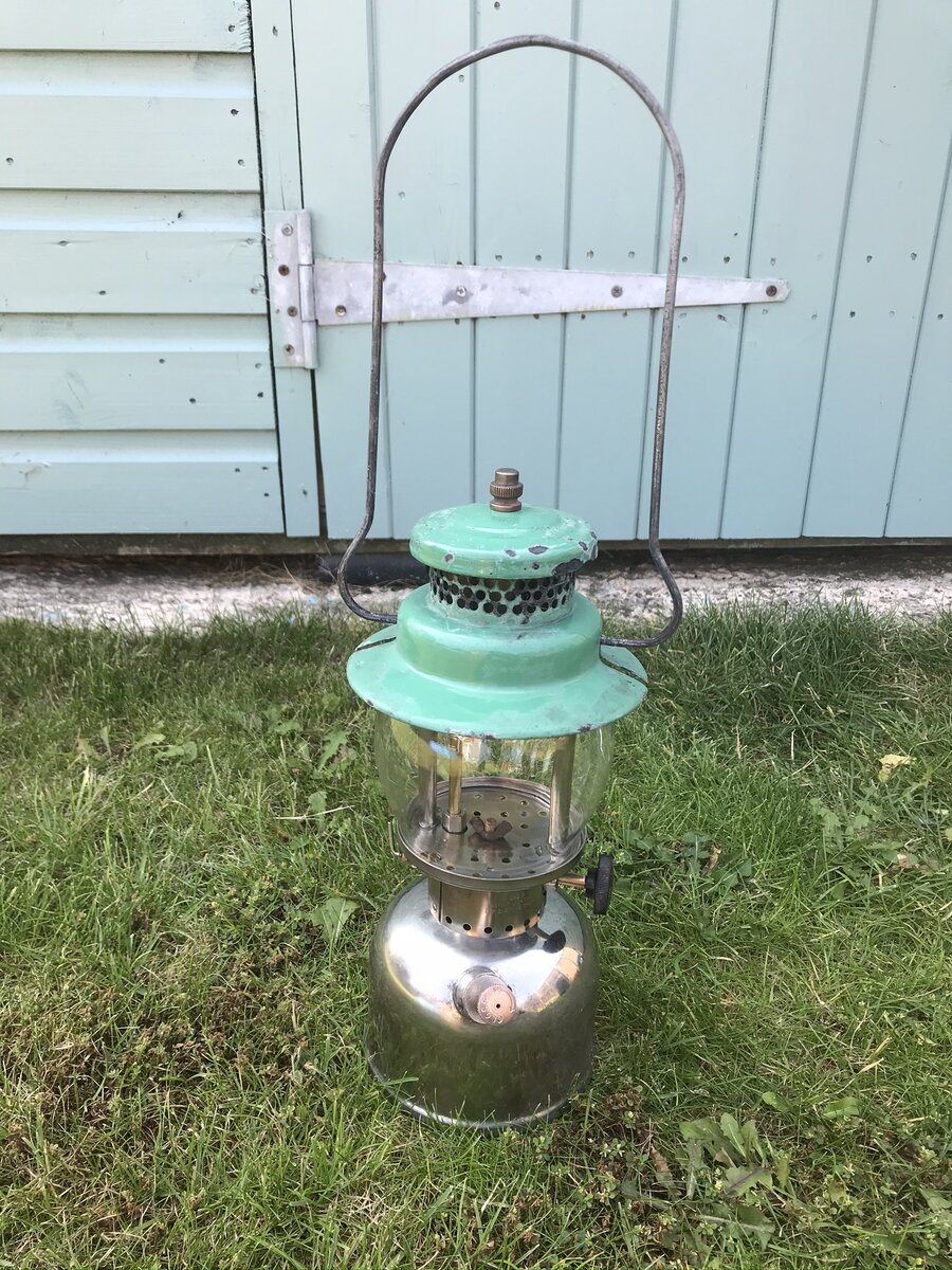

    I’ve recently inherited a Coleman 242B which was my grandfather’s, it was hiding in my Mum’s garage. I’ve stripped it down and given it a quick clean as I’m keen to get it working.

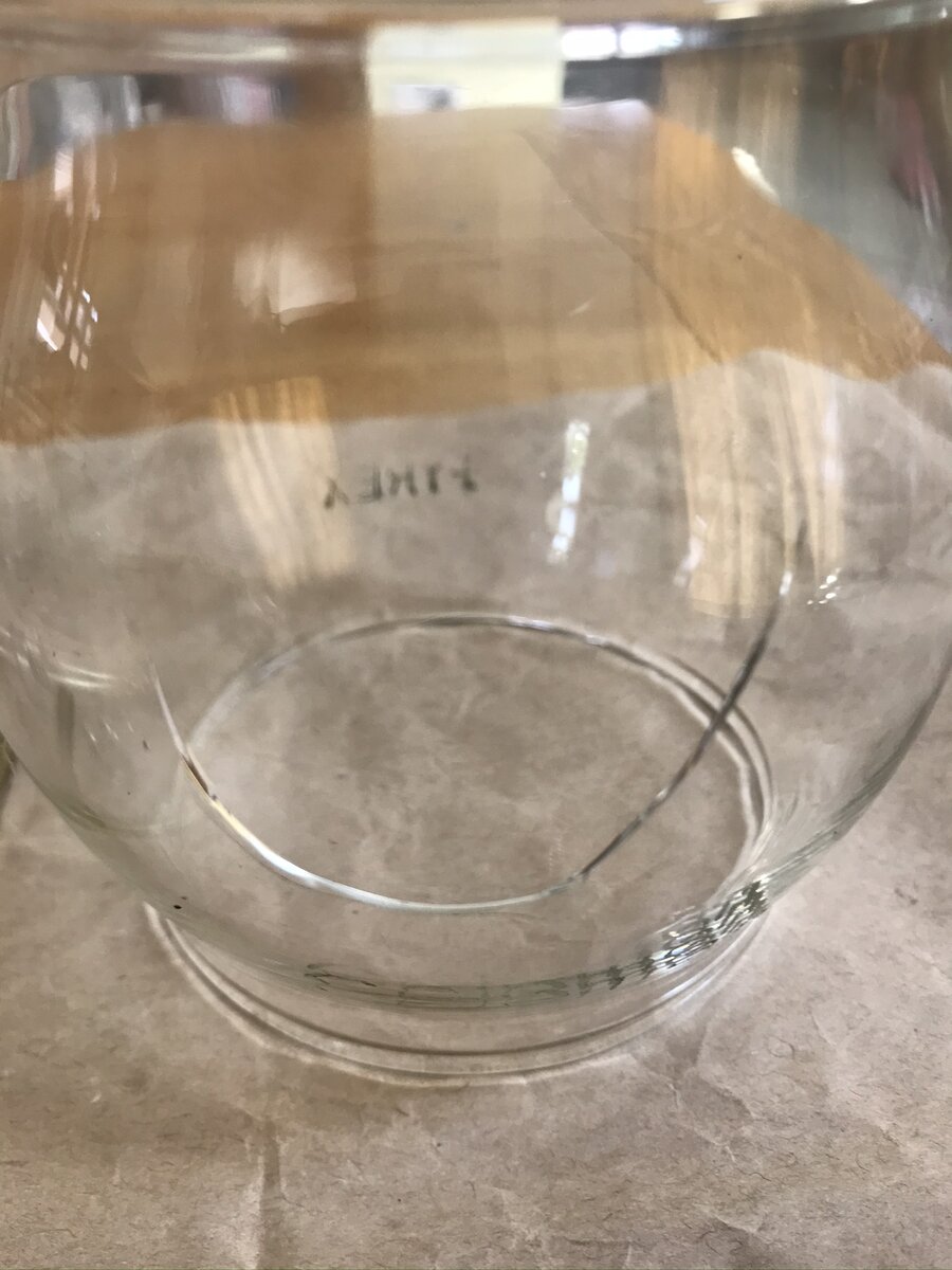

    Is it safe to use the cracked globe (where can I get a “new” one)?

    I believe the 242 uses a Coleman 550 globe. They can be hard to get hold of in the UK. However a Optimus 930 globe will fit well. These can be purchased from Hytta in Germany (takes about 4 days to send to the UK). The link is here: Detailseite: Optimus- und Radiusgläser- - hytta.de The one listed as "ohne Optimus Log" is good. I have just fitted one to my Coleman 249 (takes the same size globe as the 242).
    The 242 takes a Coleman #99 mantle which is a 250- 350CP mantle. Any straight type mantle rated 200 - 300CP should do the same job as the Coleman Originals. These can be purchased from ebay. I have found the Luxor brand (purchased from Germany) to work well.

    Yes it is safe to use the cracked globe until the crack goes all the way and the piece falls out. Even then it's not dangerous but leaves the mantle susceptible to the elements and kamikazi insects.

    Glasses (with Coleman logo) are also available from www.base-camp.co.uk

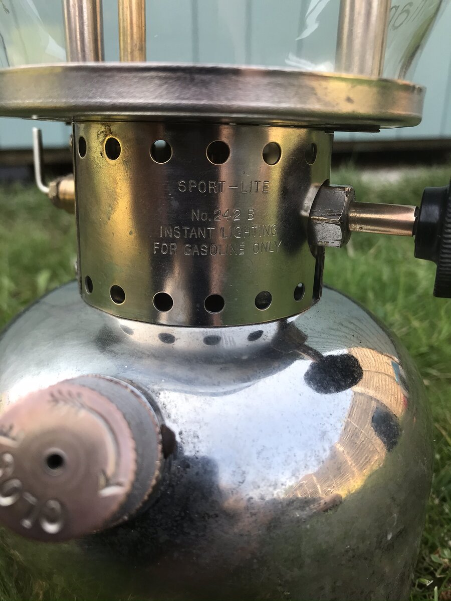

    I notice that the generator is for kerosene but will probably work O.K.. See how it goes before ordering a new 'correct' one also available from base-camp.

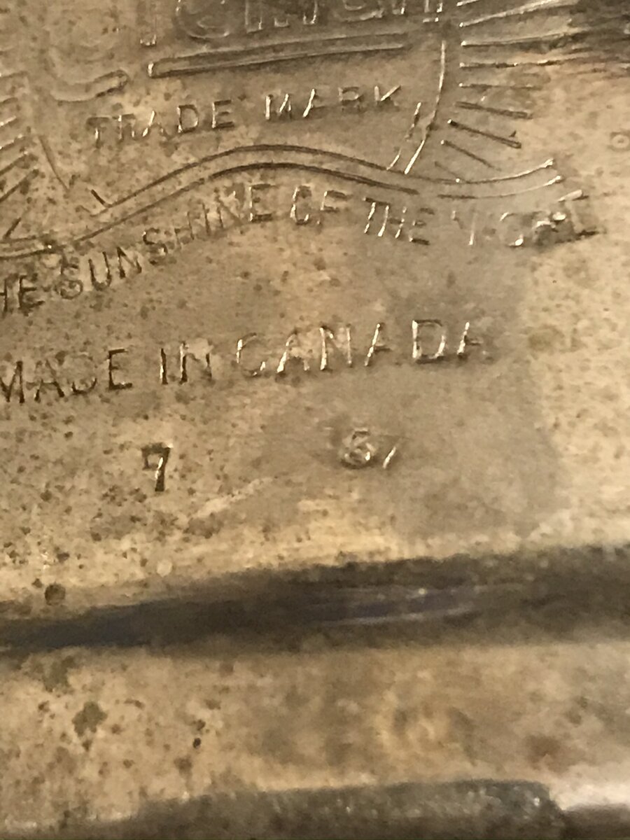

    You have a nice 242B dated 7 37 representing July 1937.
    It has the earlier micro groove valve wheel/knob and the nickel plating is in reasonable shape. The green hood has separated but it’s still useable.
    You can buy parts for this lantern, i.e. a replacement globe or any seals etc., from Old Coleman Parts just follow this link:

    Yes, your generator is for kero, can be used for white gas too but you will need to preheat. For mantle get a peerless 2c-hg they are a tad bit bigger than a #21a or peerless 24A many persons are using them on 200’s and 242’s.
    Get the proper generator if you want insta lighting as they were built.
