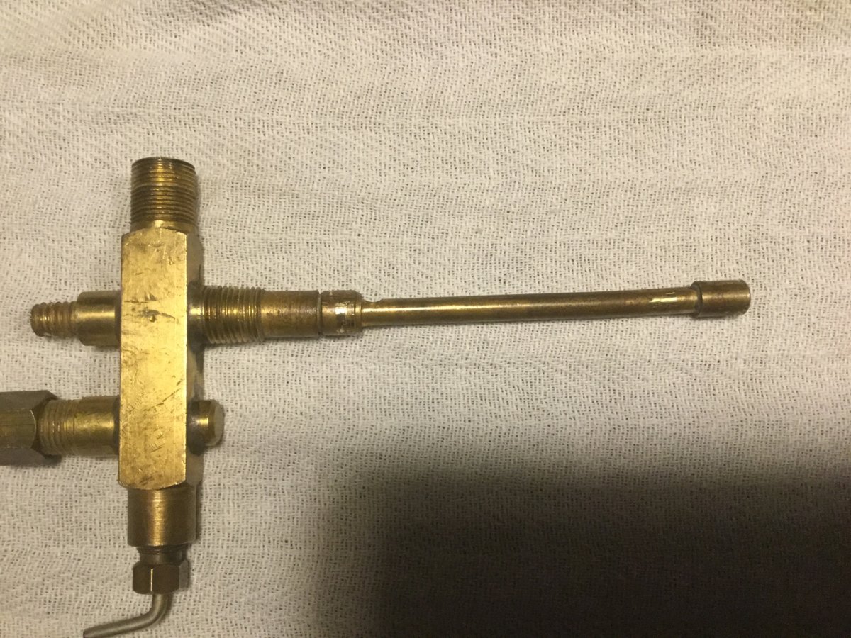

    Does anyone know how to remove a air fuel tube on a Coleman 242B. Looks like a sealed unit. My lantern flame is flickering and I can hear the air fuel rod in the tank chattering.
    Willem.

    Thanks, that’s exactly what I need to know before applying force..

  5. AussiePete
    @Willem
    You’re in good hands with Martin.
    I would like to add, take a picture of the fount before you unscrew the valve as a reference to ensure that you clock or index the valve / fuel tube assembly back into the same position on the fount.
    Good luck, it should be an easy procedure.
