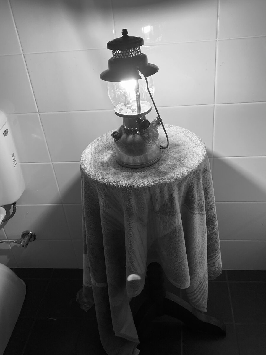

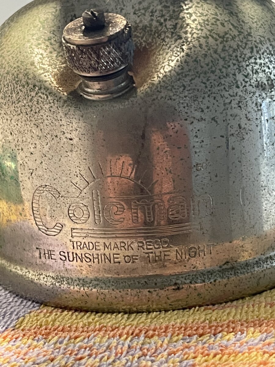

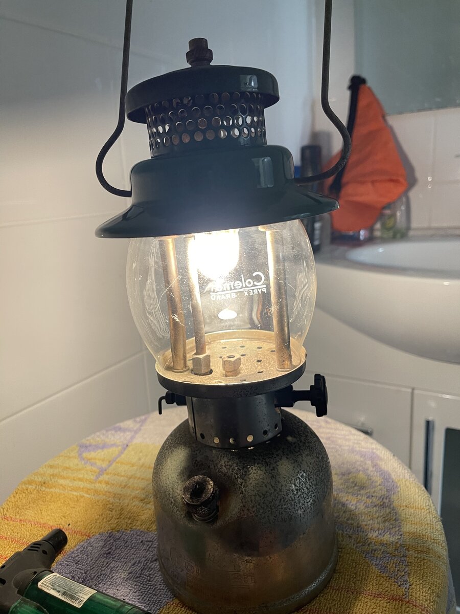

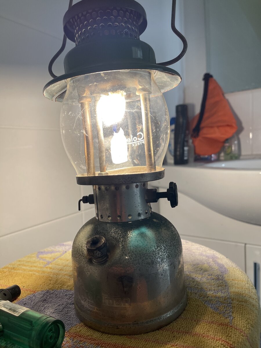

    As found original condition
    242B Coleman sports lite
    Dated 7/50.Australian made
    New fuel cap seal fresh fuel, a little cough and splutter and away it went,
    C8945E62-BB57-42EF-B6E2-8EACE5AF3609.jpeg EFB9504C-C3CD-472B-A47D-9875FAF2FCE3.jpeg 0FDF7D76-0D15-4022-82AA-E9BECB293D2D.jpeg AE8E02A9-FB5E-42AA-B7A4-B05D957627AB.jpeg

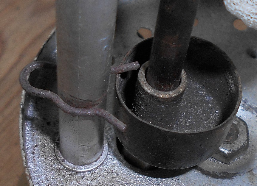

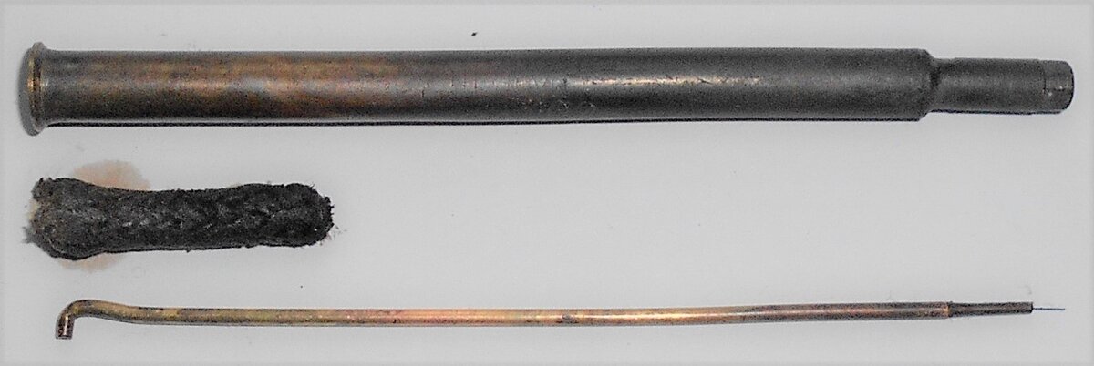

    Here is my 242B (made in 1947) with its original generator (for gasoline) burning kerosene
    With kerosene generator
    Generator Lantern - C22
    Inside an old generator for gasoline
    Inside a newer generator for gasoline

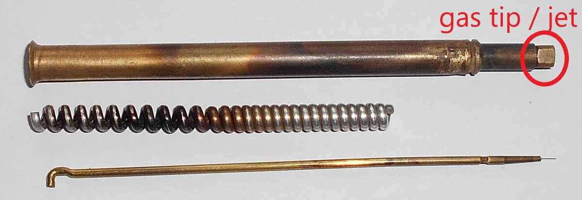

    Inside a generator for kerosene. It's not just the coil that makes it different, the hole in the jet is a different size to one for gasoline and so is the fine cleaning wire.
    You'll need one of these
    Pre-Heater cup Small - C16 and some means of holding it in place so that it doesn't slide up and break the mantle if the lantern gets knocked over.
