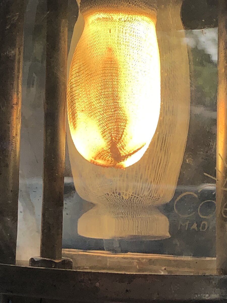

    This is my Coleman 242c. My grandfather said that if I fixed his Coleman powerhouse he’d give me this, so I fixed his powerhouse and got to work on this. I took it all apart and out all of the parts in an ultrasonic cleaner and got a new generator. Then it was “running” but didn’t really do much. So I put in a different generator and now I have this. For some reason I have to flip it over to start the fuel flow and also the mantle is blotchy with these black spots. I don’t know if it is because of the mantles or something I did wrong but 4 mantles did the same thing. Anyway a nice poolside light up on this Tuesday morning. image.jpg image.jpg

    Did you remove the valve in order to remove and clean the f/a tube? And did you clean out the air tubes? What size mantle are you using?

    Yes, I cleaned absolutely everything. I’m using the recommended peerless mantle. Which I believe is 24-a

    The 24A is a 500cp mantle which is better suited for 500cp lanterns such as the 237 or 639 kerosene lanterns etc. I would use a Coleman 21 or a Peerless 2CHG. it appears to be having difficulty driving that larger mantle assuming of course you're confident all is clean and the lantern holds pressure.

    As much as I hate to say it I think the F/A tube possibly needs another clean. Did you use an ultrasonic bath to clean the F/A tube? Did you use a new generator by chance or just clean the old one?

    The fact it runs after you tip it upside down makes me think the F/A tube is clogged as George suggests, and fuel can enter via the hole for air at the top of the tube. Turning it also helps dislodge the gunk a bit to let it light, albeit weakly.

    I'm assuming that you don't have the flame 'halo' outside the mantle problem now. Do try out fixing a smaller mantle. Anyway, an oversized mantle would not usually give you the soot-up spots. It'll just be under-driven and be less bright that it should. Its more like its air-starved or over-fueled.

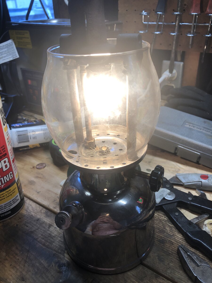

    After all of the suggestions, this is what I have. image.jpg @Jean J everything else I free up the Merican’ way. image.jpg
  21. JEFF JOHNSON
    16,656
    That's progress!:thumbup::thumbup:
  22. Tom Waite
    Tom Waite United States Subscriber
    Dec 23, 2019
    27
    North Carolina
    Progress indeed! Congratulations.
